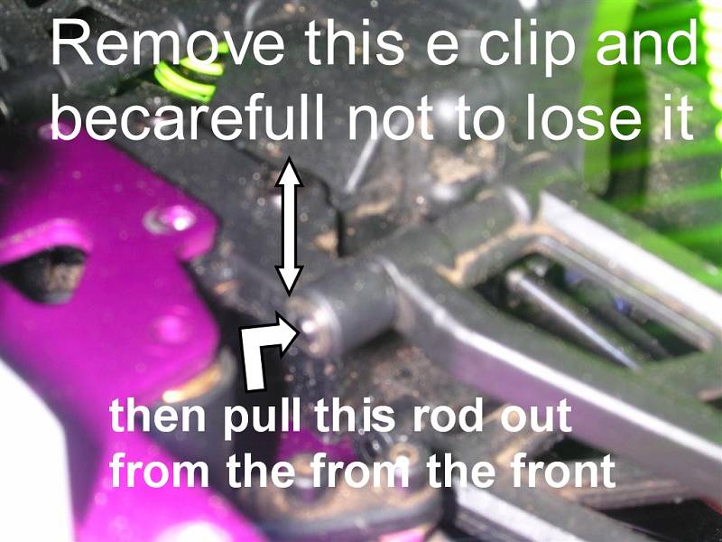

i was just trying to fix the dogbone,(i got the rear dogbone out no problem, but i couldnt get the front out i was think get the e clip off, but i decide not to) i got it out i look straight or not, i just hit it a few time put it back and put the wheel on roll it wheel whable take it out try it again same thing happen..so i decide not to fix it any more.
put the dogbone on the wheels on but later when i try to spin the wheels one wheel look like i over screw it and the silver thing wont move it stuck there very very hard
1-now i cant fix my dogbone
2-rear right wheel wont spin(but the rear left spin wiht no reason)i think i over screw the wheels) amd the silver thing go in too far.
well here is the video
http://www.youtube.com/watch?v=UiuBWK-1mfI
please tell me how to fix this and also how to take out the front dogbone(take off to e clip to take off the dogbone? im not sure )
please help me

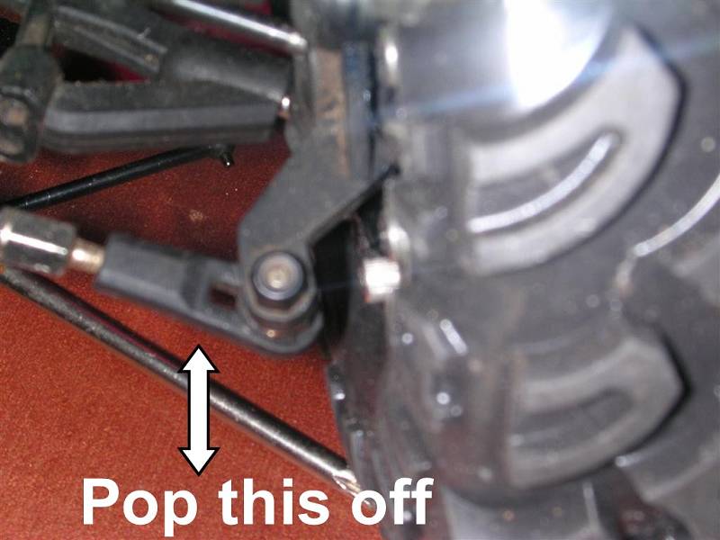

same way you took the rear one off, just take the upper arm off at the hub and tilt it forward.

dont need to take the clip off, just take the screw off the steering knuckle, from the top or bottom and just tilt it so you can get the dogbone out, remove the upper arm.

pinched off macanan from my post but there you are...

im gonna try this tonight im school right now
