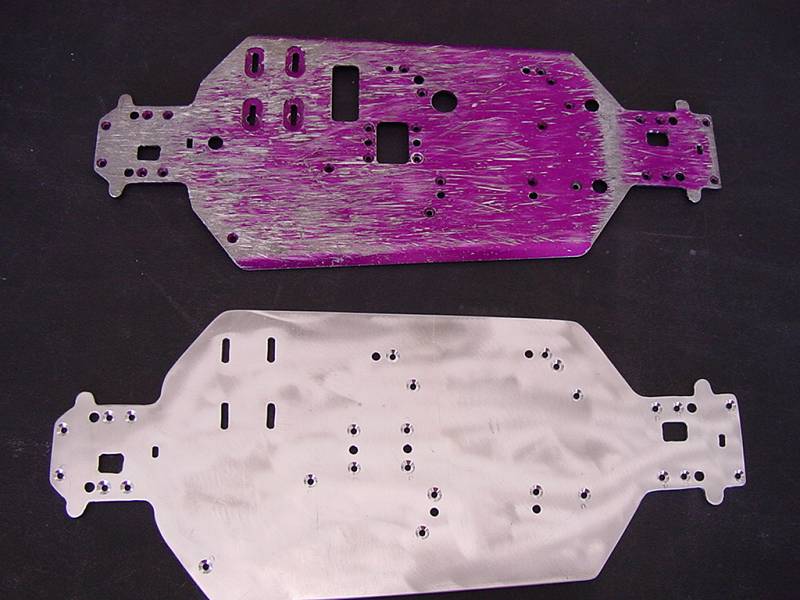

If you can't find something that fits, Google "Carbon Fibre Sheet" and you'll find a tonne of places that you can buy flat carbon fibre sheets in all different thicknesses. It'll be a little expensive but it's available. It will also be difficult to get that little up-turn on the front of the chassis.
I do have a purple aluminum Tsunami Chassis in Stock that should work with some minor customizing...$17 Canadian...no tax.

This may be a bit late, but if you are still looking, see link below for where to buy blank aluminum sheet. I made a new chassis for mine and it's far better than stock. The stock is made from 6061-T6; my new one is 7075-T6 (aircraft alloy) and it's nearly twice as strong.
http://www.onlinemetals.com/merchant...916&top_cat=60
Picture below...
