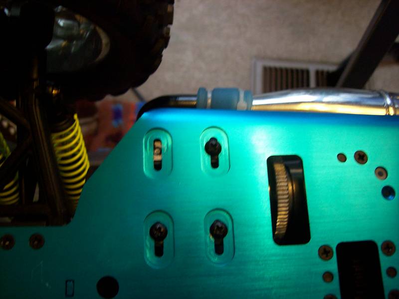

My girlfriend bought me a Volcano 530 on ebay. The first day having it i started to get it set up and went to set my gear mesh. As i started to take out the screws underneath the engine the first screw broke before even begining to back out. Will it be harmfull to just leave that screw there and leave it secured by the other 3 screws? Other wise will Red Cat replace the engine it was brand new. I dont have a problem leaving it like this as long as it wont cause any harm. This picture should give a clearer understanding.

That's just broke off in the engine mount, you should be able to use a back out tool that you can get at a hardware store and get it out, but it has nothing to do with the engine itself. The engine just sits on the two engine mounts. You could try running it with just 3 screws, but it might cause the engine to shift and therefore causing you to strip a spur gear, then again, you might be able to run it for weeks and not have any problems. If you don't want to mess with trying to get it out, just order some more engine mounts, there not expensive. They're only like $4 on rufaster.com.

remove the other three screws, then remove the motor mount and replace them or one side. before you re-install them grease them up.

what i do when i strip it or break the head off the mounts is take all the other ones off. Because its always that one screw lol. And then take some pliers and try to grab it and turn it out. Redcat should take care of you if not, then let me know and ill see if i can help you out. But ask nick or something first

If you can, try to extract the screw with a screw extractor http://www.sears.com/shc/s/p_10153_1...=Taps+%26+Dies
But unfortunately, I dont know if there are extractors small enough for our hobby screws.
If you are able to get the broken screw out, go to your hobby store and buy hex head screws to replace the phillips head screws. The hex heads will secure better and will be easier to extract, and they are less prone to stripping.
Also, while you are at the hobby store, buy some tread lock (like loc tite). You always want to loc-tite the engine mount screws, but take care not to put on too much, in you case, too much loc-tite might have been the cause why you twisted off the head of the screw that you broke.
