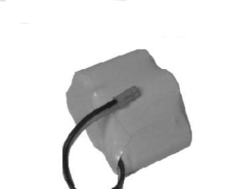

<span style="font-size: small;"><span style="font-family: Comic Sans MS;">Thanks alot Marty for the information on the engine mounts, and Mick for the information on the battery pack. My reason for asking about the receiver pack is related to the connector type, that is, if the receiver pack for the 1/8 scale vehicles has the same type of connector as the 1/5 scale vehicles. </span></span>

Hmm... Cant help ya there.. I know the Monsoon (and most Redcat's I think)takes a "BEC" type connector.. Hooks the battery upvia the "on/off" switch..(see below)
Note:The Reciever takes a standard "servo" type connector, but the battery hooks to the on/off switch with a BEC connector, then the on/off switch hooks to the reciever with the "servo" style connector.. You could make it work with either, with a little soldering though.. ANyway, below is the BEC connector, that's attached to the battery.

<span style="font-size: small;"><span style="font-family: Comic Sans MS;">Yea, I've realised that Redcat seems to favour the BEC connector. I'm just not sure if the connector shown in the picture I'll attach IS a BEC connector as well. </span></span>

Ah, yea I see what ya mean.. Hard to tell from lookin at that? I think it is, but I wouldnt swear to it.. You can always order just a BEC connector "pigtail"and clip the connector from the battery and put on the BEC type, if it comes with a different type? Kurt at URCHobby.com may be able to hook ya up, or I know Tower Hobbies sells em.. The battery takes a "female" BEC connector.. Female BEC pigtail
Note:Also, if you get a Monsoon, the battery holder that comes with it has the BECplug on it, you could scavenge if ya wanted to?
