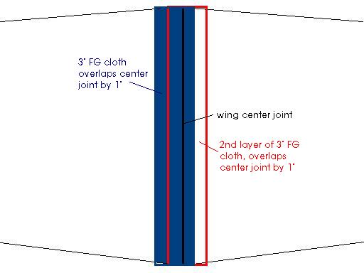

For Silver, some will tell you thatyou could probably get away without fiberglassing the center section of the wing. But personally, I wouldn't risk it. I recommend fiberglassing the centersection anyway, and never having to worry about<u>IF</u> it will hold. It is cheap insurance and makes for one less thing going through your mind come race day. Furthermore, you not only have to worry about whether it will hold in the near future, but more importantly . . . will it hold without the reinforcement after those less than perfect landings, season after season?

Ollie: With FB the center section are you talking both top and bottom? What is the simplist process for this? Do I cut off the covering off at the glue joint and reapply new covering on the bottom or what?

I measure out about 2 1/2" from each side of the center joint, and use a straight edge to cut away the covering. (Obviously you need to be very careful/delicate and cut through the covering, without cutting into the wood. Otherwise, you'll weaken the area just outside the area ofreinforcement work you are about to complete.)
Rather than just using one layer of heavyweight FG cloth, I use two pieces of slightly lighter weight 3" fiberglass tape. Or you can use standardcloth, cut into 3" strips. Each has its advantages and disadvantages. The tape is already cut and its edges won't unravel on you; but the woven edges of the tape tend to be thicker, can sometimestend to curl up slightly,and due to both of these factors leave a moreobvious raised line. The cloth takes an extra step to cut, and can unravel on you; but you may already have it on hand, and the edges tend to lay flatter and seem to sand out a little smoother with a little less work.
I lay one piece primarily on the left wing panel so that 2" are two the left of the wing center joint, and the remaining 1" overlaps this joint, extending about 1" onto the right wing panel. Then I lay out the piece on the right panel similarly, but with oppositeparameters. (See the primitive drawing I made for you, below.) When completed, this arrangement gives two overlapping layers where it is needed most . . . at the very center; and 1 layer extends another inch to each side where there is still significant pressure being applied by the G forces in the turns. This arrangement also makes sanding it relatively smooth much easier than just one extremely thick piece that more abruptly announces where the reinforcement ends, and therfore would make recovering this section more difficult, and far less attractive.
After curing, give a quick rough sand to remove high spots and those potentially flesh-piercing FG "needles". Fill with balsa filler, and sand relatively smooth, but don't get counterproductive by cuttingintomuch of the cloth. Sand it just well enough to get the covering to lay over it reasonably well when you re-cover this section. (Don't worry: the top is hidden by the fuse, and most people don't get a close or prolongedlook at the bottom.)
Recover with compatible piece(s) of iron-on covering (overlapping as is usual), and you are done.
Hope this helps.

Thanks Ollie! Very descript and being the visual learner that I am, the diagram is very helpful. What about the factory installed hinges? Should I worry about them or are they good to go?

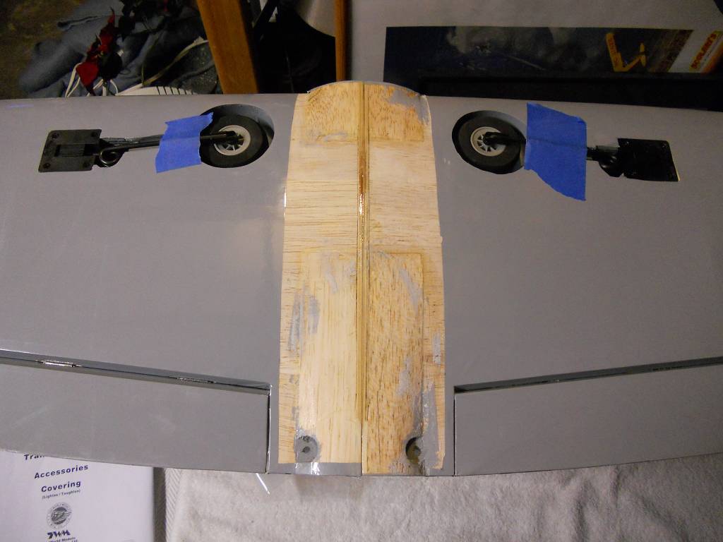

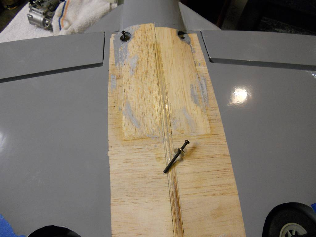

Well, I removed the covering from the top and bottom of the wing and glued the sections together. Pretty smooth with no issues. I will be in Sac on Tuesday so I will go to R/C Country and grab a bunch of goodies that I need, including the fiberglass to reinforce the wing and and firewall. After working on the TF kit, going back to an ARF is so simple it's ridiculous. Here are a few pics of what I have done. There is also some pics of the stock wing screws. I am used to the larger nylon bolts. Do most pilots replace these screws with the nylon bolts or do they just use the stock ones? Just wondering what the standard is here.

Jake,
For what my opinion is worth, I prefer the 1/4-20 nylon screws, for afew reasons:
- They are still plenty strong to hold up even at gold speeds, yet they will sometimes still snap off when the airframe makes those unauthorized contacts with the ground, andoccasionally save the airframe from quite as extensive damage (when you are really lucky).
- Being a bigger diameter, there is more wood that would have to be "compressed" in order to enlarge the holes. This makes the area around the bolts slightly more resistant to eventually enlarging the holes through vibration, "hanger rash" dings, and tweaking the wings on bad landings and flipsat the end of the runway.
- When I've cartwheeled planes with the smaller diameter metal bolts, the sheer just pulls them right through the wood and out the back at the trailing edge, making a repair to this area much more difficult, and weakening the structure so much that even when repairable, I find it hard to trust that it will hold over the long-haul. Similar to what I said in an earlier post, that isjust onemore thing going on inthe back of your mind, potentially worrying/distracting you when you want tohave fullconcentration on the competition.
- When one falls out, and you can't find it, someone always has a 1/4-20 nylon bolt. Will they happen to have that <u>metric</u> size that comes standard with the kit?
