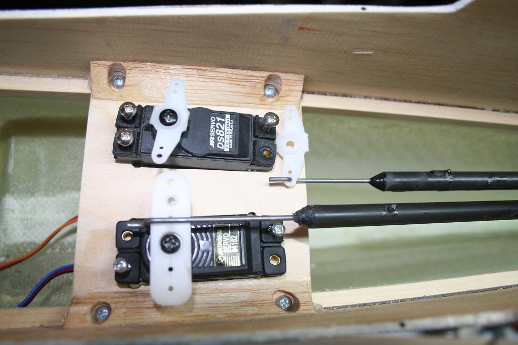

After a couple of unexplaned failures when usingstandard servos, I have gone the digital route, but still try to keep it reasonably inexpensive. The JR DS821 is a decent quality, readily available servo, for about $30 each,that would likely do well for you all-around. However, I also received a bunch of JRDS537 servos in some flight packs I bought a few years ago. Beings these have a little lower torque than the 821s, I use them in lieu of 821s for individual aileron servos. For the rudder, where I think a little more holding power is adventageous, I definitely use the DS821. Beings the elevator is likely undergoing the most strain (and I have lost my elevator control in a turn and found a stripped gear after the crash), I have begun to invest a little more for this servo. For elevator control, I am currently using an Airtronics 94162 digital high-torque, ball bearing, metal gear servo that comes out-of-the-box with a heavy duty control arm. These are available through Hobby People.
The picture below shows my current rudder and elevator setup forthe "Trinity-build" P-51 project I am currently working on.
And "YES" Skids, I DO realize that my servos are not actually screwed-in, nor are my linkages actually connected. Like my fuel tank, this is just a trial-fit.
(I just know you'd find a way to tease me about this, if I didn't "nip it in the bud", first.
) As you can see, I also prefer using carbon fiber rods toensure free-moving, yetflex-free linkages, withoutall the hassle of more carefully laying out an extensive internalbracing structure.

I saw those servos with the screws half way out and almost called you at home to scold you on your set up.... then I read your post. So much for trying to help a buddy out....
Seriously now... to touch on a few things.
1. I haven't heard any rumors of a YS125... would love one, but I do not believe such a beast is in the works.
2. I run 120's on nitro and if you think the 115 shakes, try holding on to a 120 on a SOLID mount
3. My suggestion with regards to servos... I take ply (or some popsicle sticks), and glue them to the bottom of
the servo tray where the screws would attach. Thus making the area twice as thick for the screws to bite into.
Then drill the mount holes, insert screw, remove screw, run thin CA (no kicker), and let the glue soak into the wood.
Works for me.
4. I've known many "gold" pilots to run standard servos on 150+ MPH planes with no ill effect. I usually set up my planes with
a decent servo on the elevator, a plain servo on the rudder, and hitec 225mg's on the ailerons. I've heard many have had issue
with the 225's, but they seem to work OK for me. As for wear and tear caused by the motor.... I've had some race planes for
many years without the need for changes internallly.... as long as I can keep away from Speed the plane seems to last pretty well.
