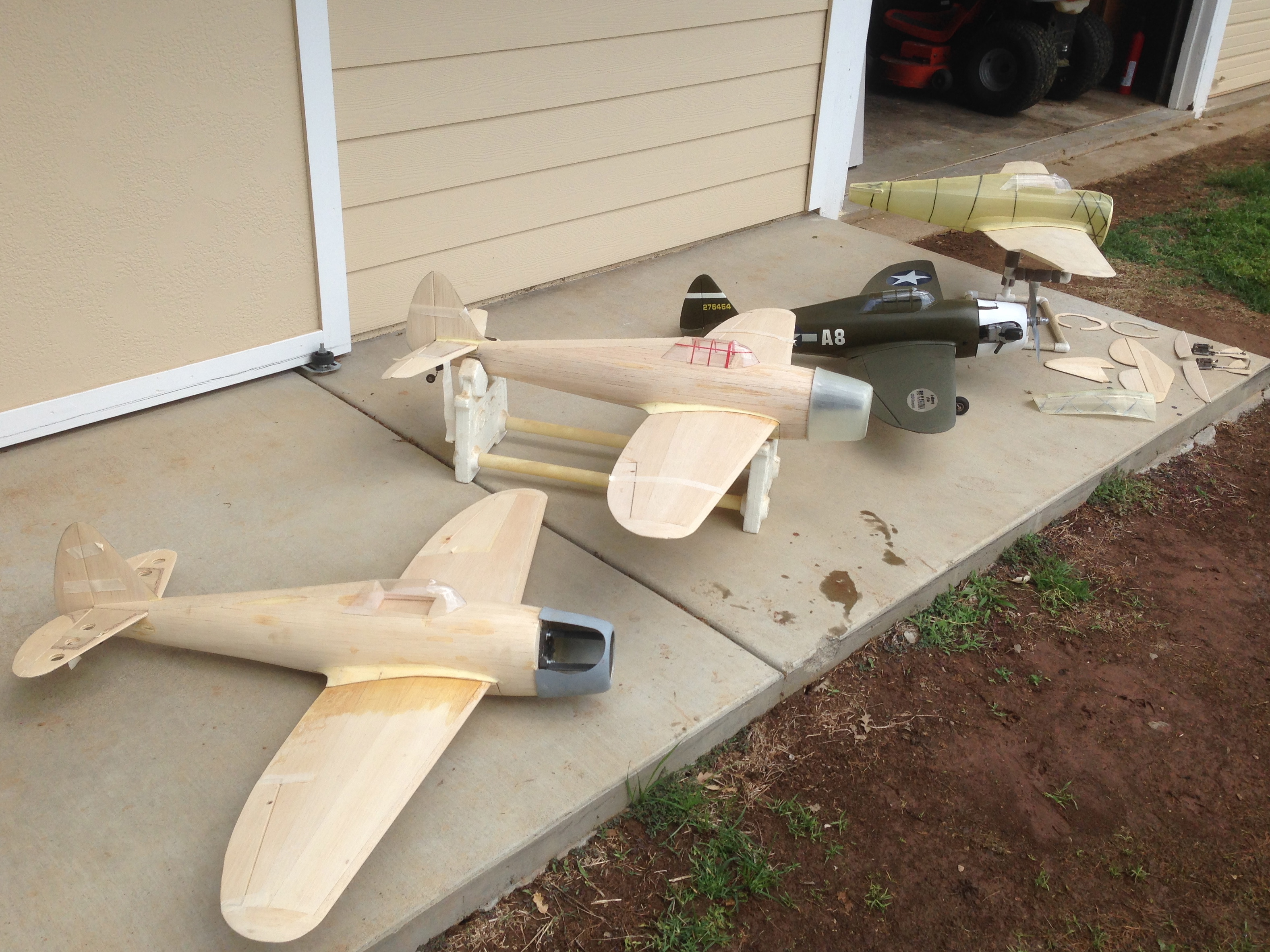

Alright, I did get my YS .91-powered Fw190D-9 all dialed in for the Big Kahuna race; but, now that it is over, I have a problem. The 190's speed is perfect for Sacramento, but both my planes ran slower up in Redding, last year. I really don't want to run any higher nitro to compensate, so I decided to get back to the "big stuff", again.
So it is back to the 115-powered P-47s:

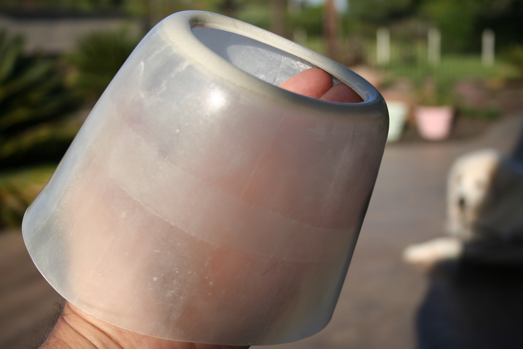

I made my new P-47 cowl mold and laid up a couple new cowls over a couple of the last few weekends, and vacuum-formed a few canopies when I was forming new canopies for Nickerson's new Raiden, as well.
Decided it was time to sweep up the shop and get back to building. Pulled the P-47 fleet out of the way to sweep and get a picture of my progress on them for you, out in the light. There are two smaller, YS .91-powered composite-fuse P-47s to the far right. My first of the new cowls has only been primered white, and is mounted on the olive-drab colored P-47. The second cowl is still "raw" and can be seen on the all-wood P-47 in the middle. I still need to lay-up one more for my other unfinished composite version. The all-wood models have a larger wing and extended tail to fit the wing area/engine chart and qualify for the YS 115. I built the composite versions, and my father-in-law has done most of the building of the all-wood models because he knows I've had no time to build the last couple years, and wants me to be able to keep racing.
Although I hope to have both all-wood P-47s completed and maidened before Redding's Ash Fast race, the one to the left is the one I will initially concentrate on finishing, first.

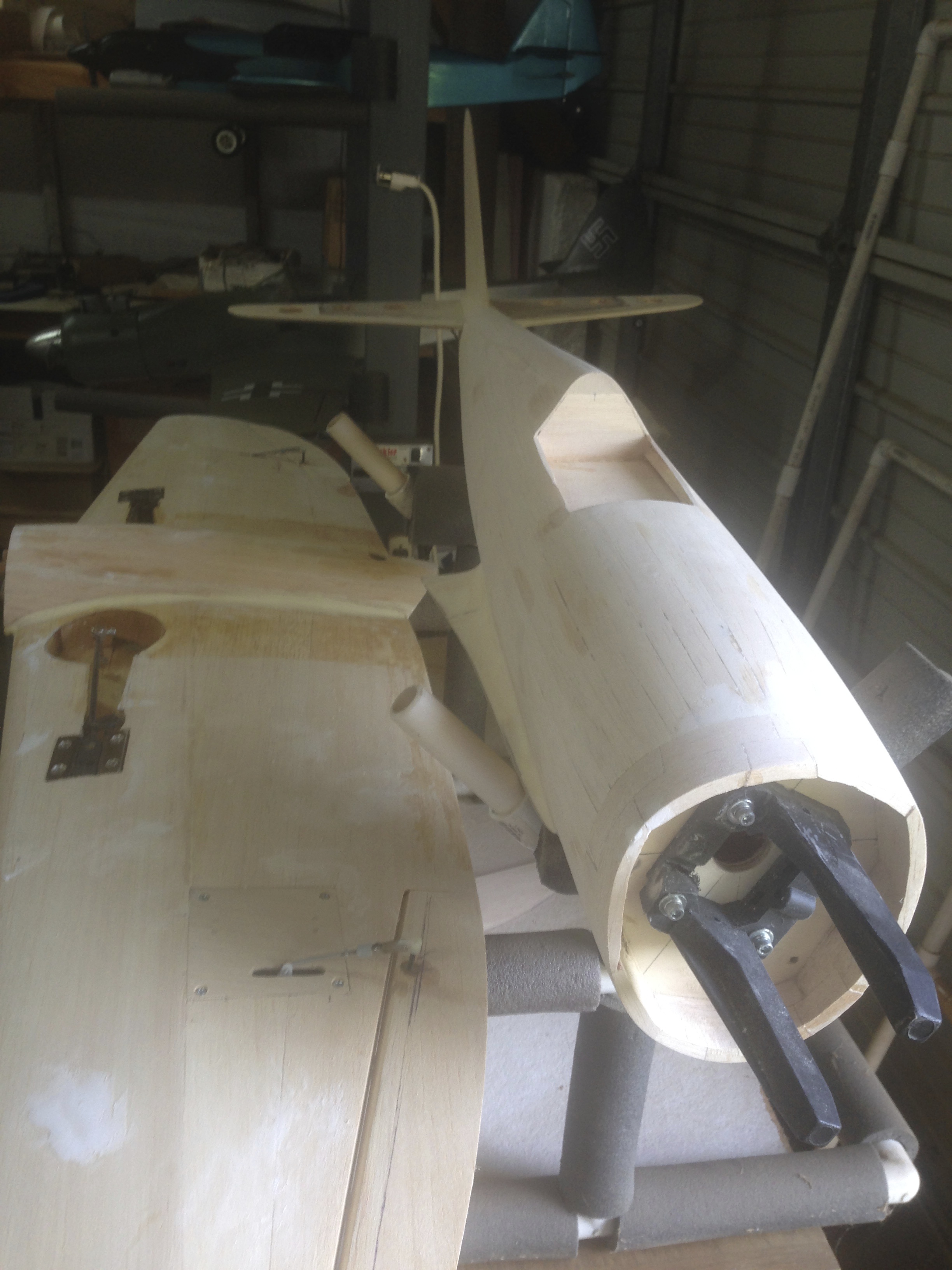

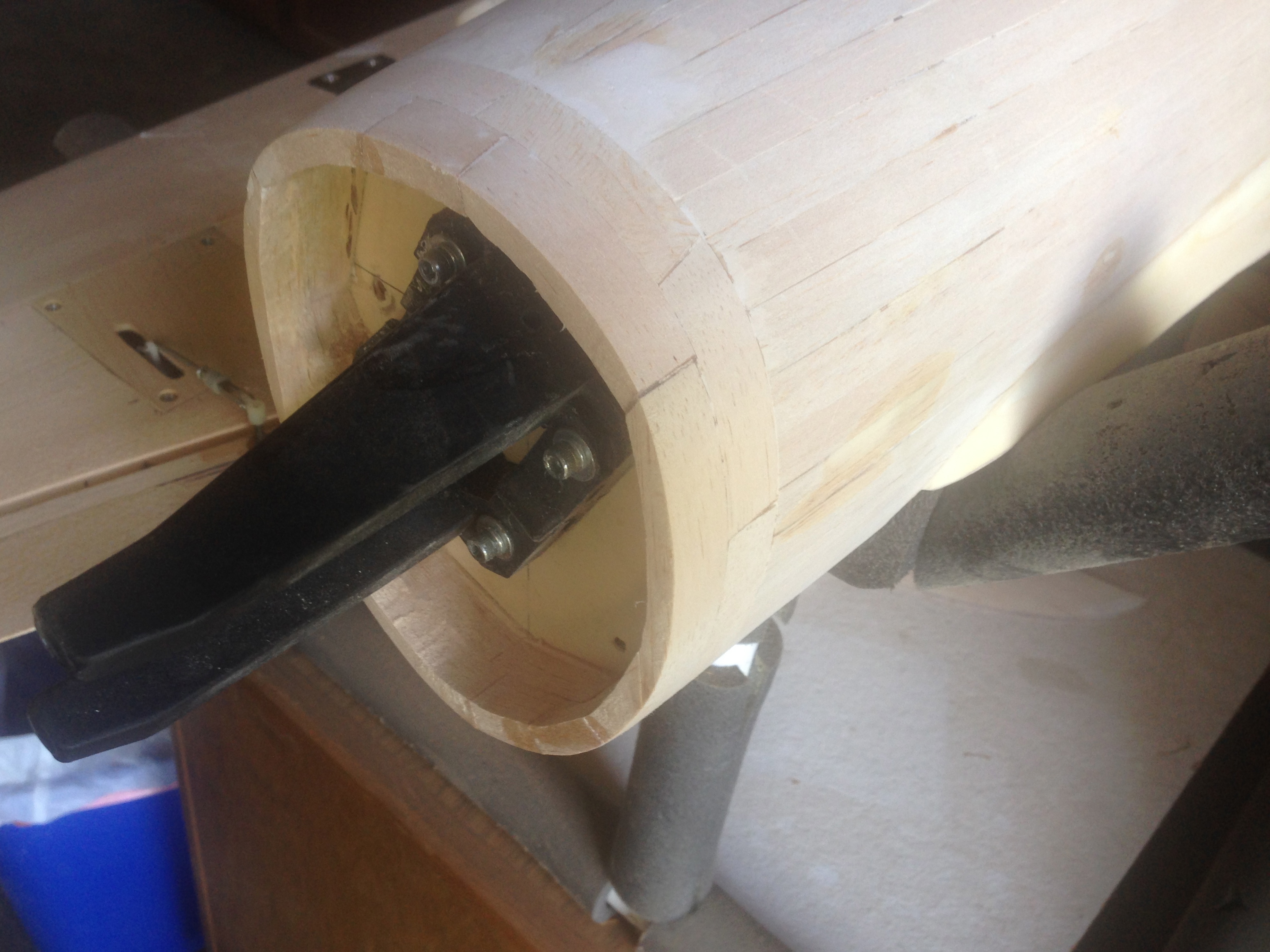

The problem with the scale composite P-47s is that it is difficult to balance them with such a short distance from the wing saddle to firewall and engine mount, and not have to add weight. The only way to do it is to locate the engine further ahead on the engine mount. But, with a cowl that is just barely big enough to house the engine when the engine is located to the rear of the mount, that means the prop and hub stick out further beyond the cowl than is scale. With the extended tail moment on these wood versions, this issue will be further exacerbated.
So, the work-around I decided to employ was to scrap mounting the cowl ring directly to the firewall. Instead, I would effectively "recess" the engine by extending the nose section an extra inch beyond the firewall with two sections of 1/2" x 1/2" stick material. I then sanded this flush with the exterior of the fuse, and used a sanding disc on my Dremel to more smoothly contour the inside, resulting in about a 1/4" thickness, overall. (see 1st pic) The plan is to glue a 1/8" ply cowl mount with #4 blind nuts to this extension, so that I can now move my engine further forward on the mount, without it extending too far forward of the cowl. The extended nose also looks more proportional, counterbalancing the extended rear fuse. The only down-side I see thus far, is that the nose contours in toward the front as it meets the cowl. Continuing this contouring an extra 1 1/8", means that the cowl's diameter is now more noticeably bigger than the leading edge of the fuse.
The initial wood P-47's fuse has been filled, contoured, and sanded to a finish ready for covering. I still need to mount the ply cowl mount ring, my switch, and charge jack however, so will likely ding it up some more in the process. The wing has been contoured, rough sanded, and filled, but not yet final sanded. (2nd pic)

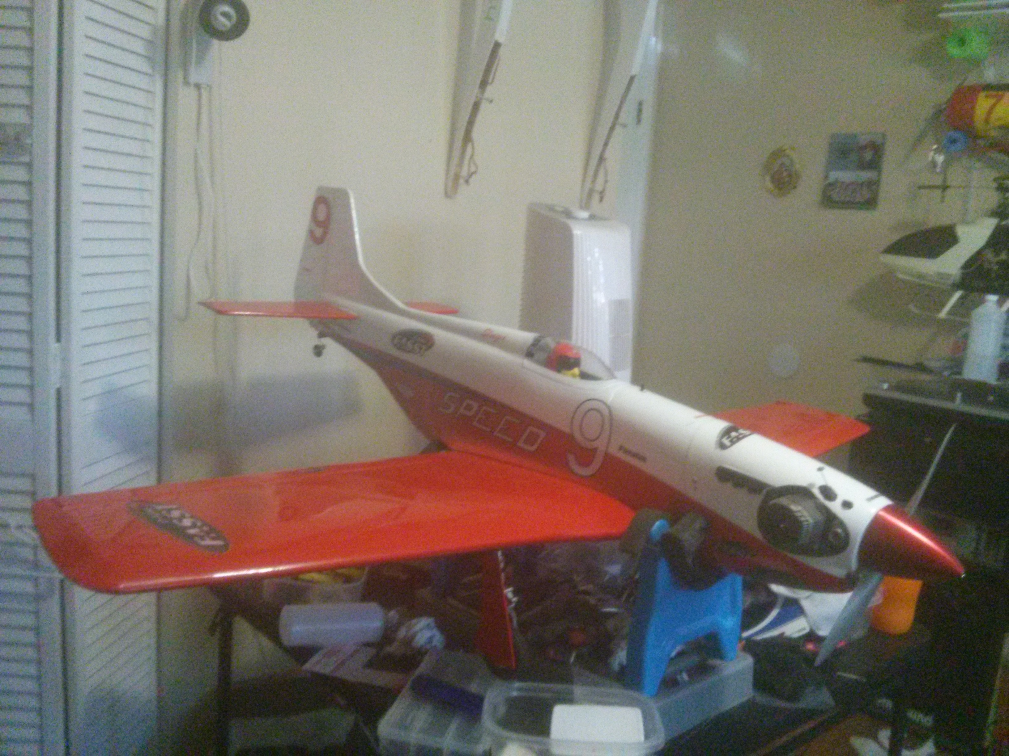

very nice stuff.. I'm just so over Kit building. Id rather upgrade an arf. My laziness dos not come without a little humility, I'm proud to see dudes that still have patience and PRIDE!....Make us proud .
Old 05-14-2015 | 09:31 AM
  #198
Joined: Aug 2009
Posts: 29
From: Palm Bay, FL
Here in FLA... Team FACTOR X Racing we just want to go ballistic sport flying at its extreme...hats off again kit boys..
