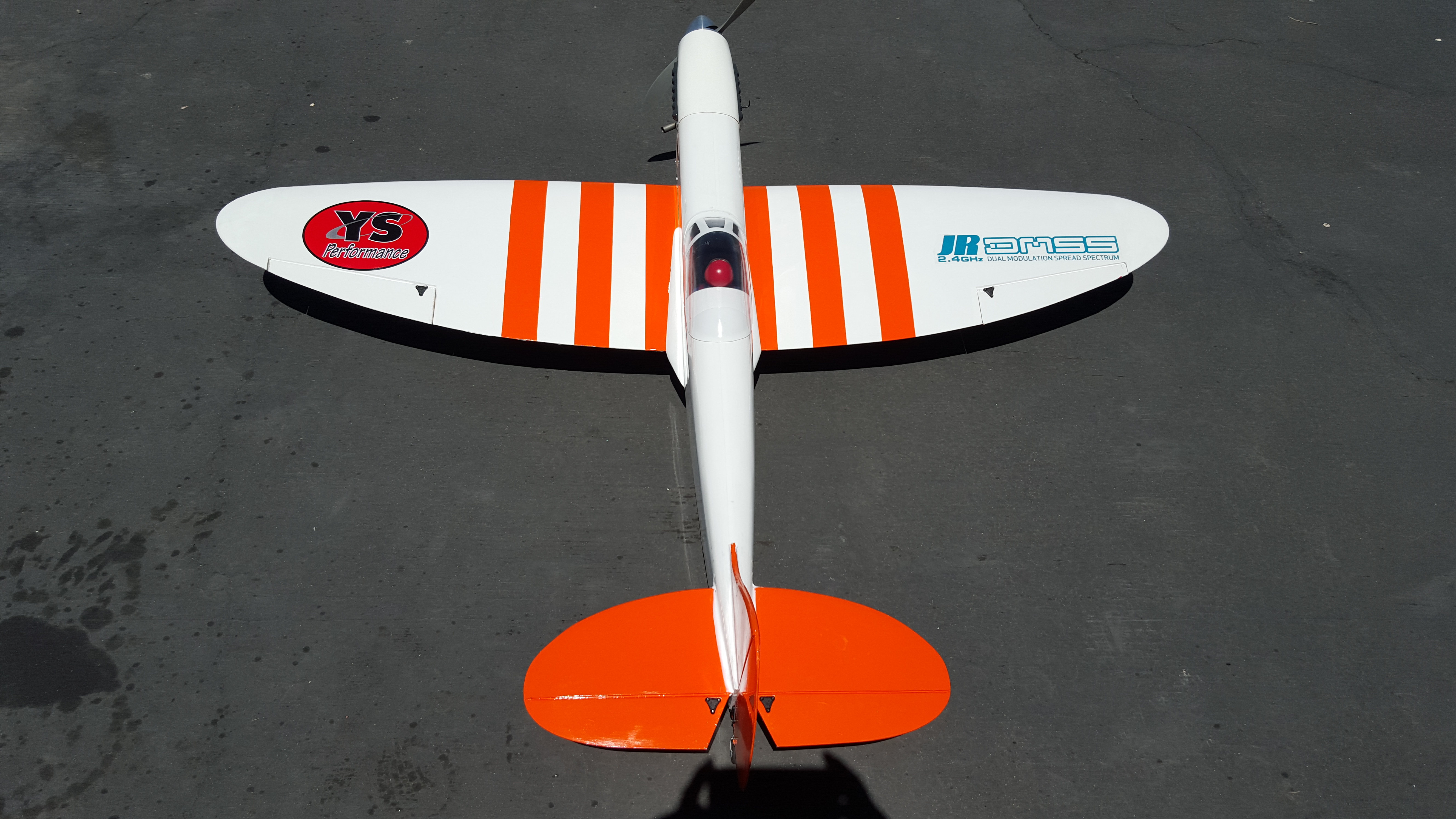

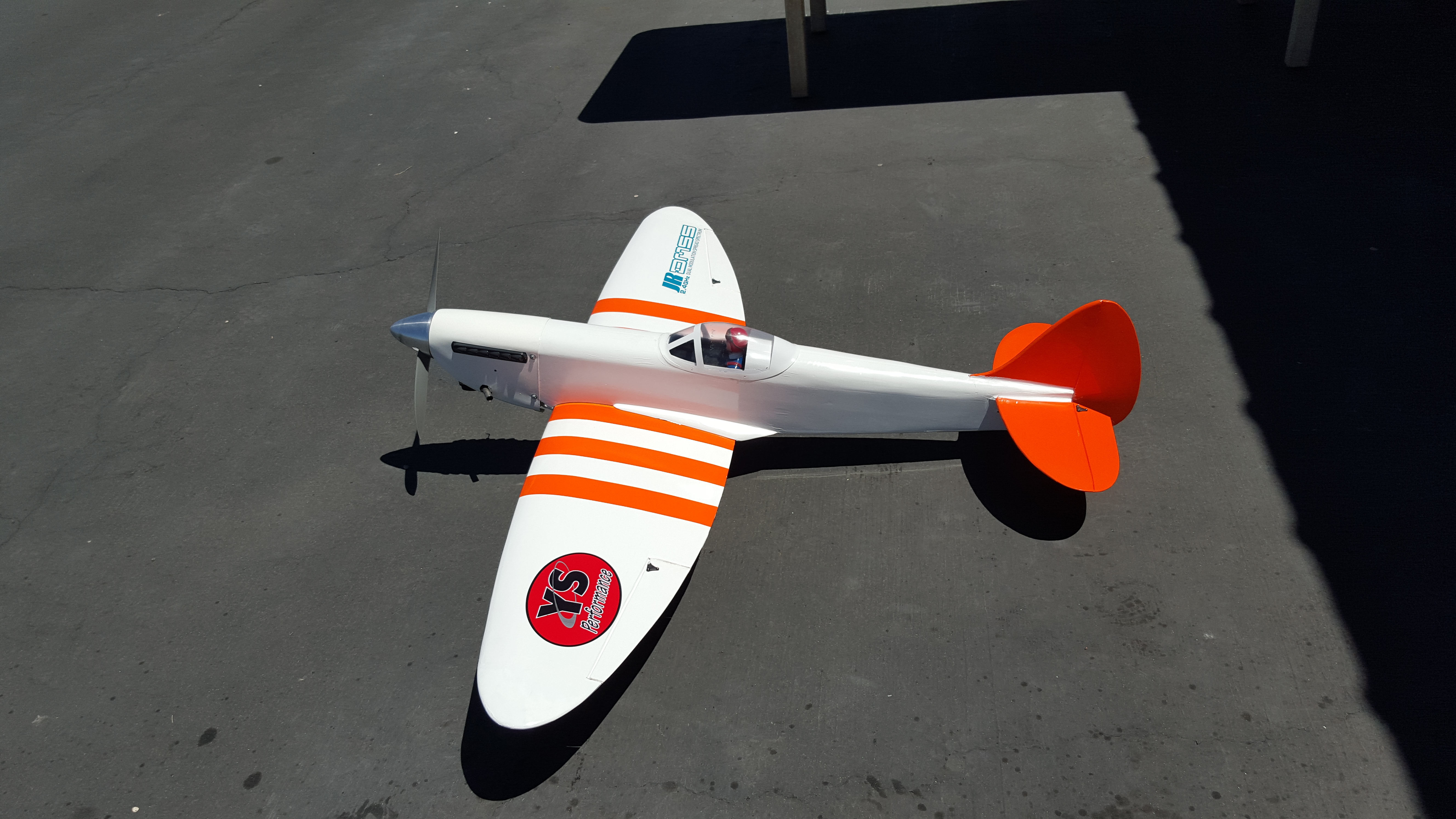

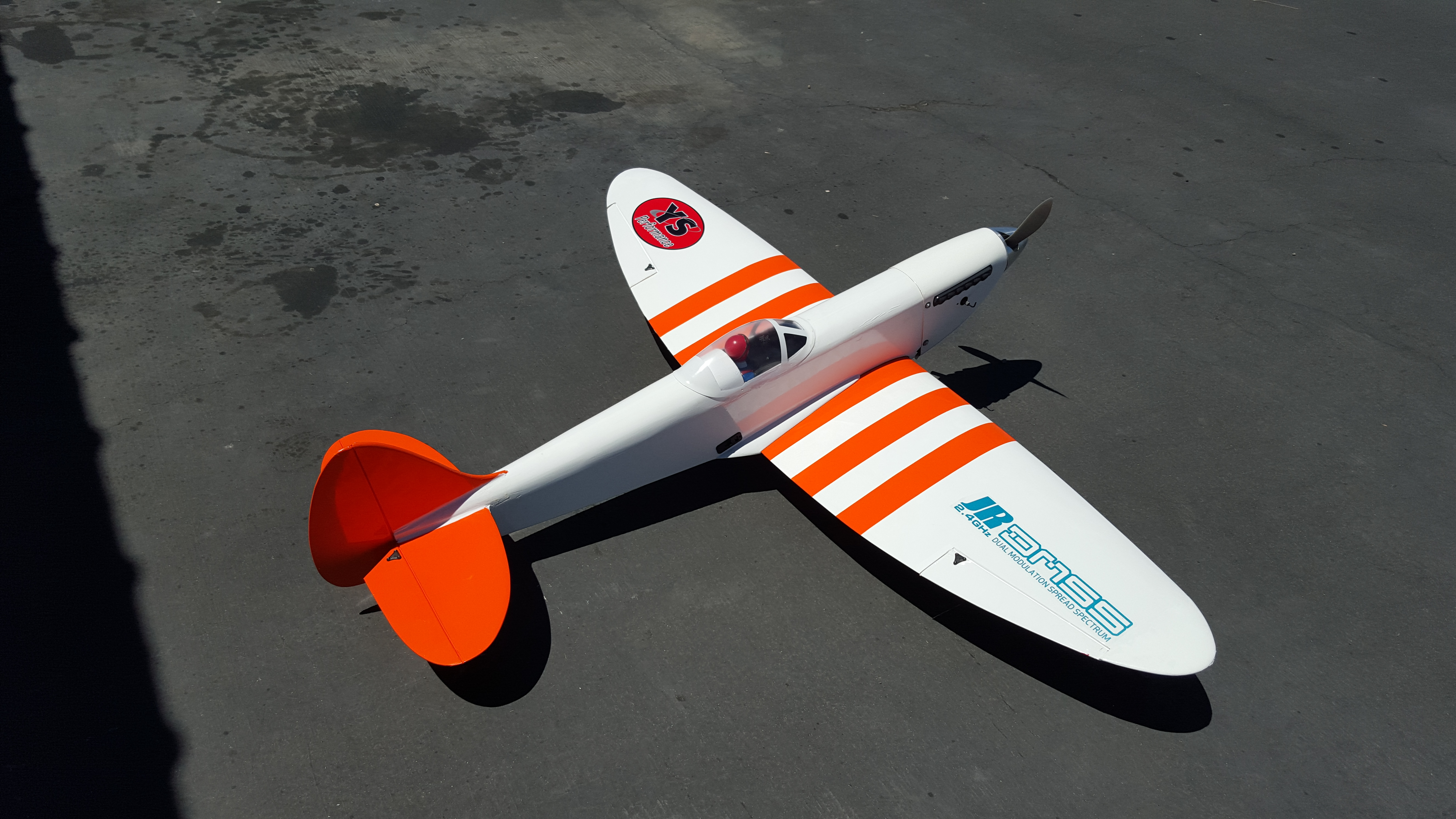

World Models Spitfire made for Gold class racing.

As far as will they hold up for the whole season if built stock, I think so if not more. Time will tell. I recovered my wing because I didnt want to try and add covering to covering and have a bunch of bubbles. I did see some sub spars in the aft section of the wing. I Did fiberglass my center section top and bottom. mainly for gear up landing and for the top so the fuselage will not dig in if at all. I will order another one my self tomorrow. I can see these thing being very dominate in the warbird racing seen which is a good thing. You can get one of these going with engine, standard digital servos and alum spinner for around 800-820 dollars. you can have it built in 5-6 hours also.

Spitfire looks good... wing is nice although I think the ailerons should be a bit more inboard where they can be a bit thicker and less prone to flutter but that is just personal preference... I have no idea why they would put a flat plate tail on a race plane, there is more drag there than two tails....

well its an ARF and to have a built up tail or a solid one sanded would raise the price way to high. The goal here is to keep the price down. My next one will have an airfoiled tail. This plane stock will break out for our gold class so not required to anything extra.

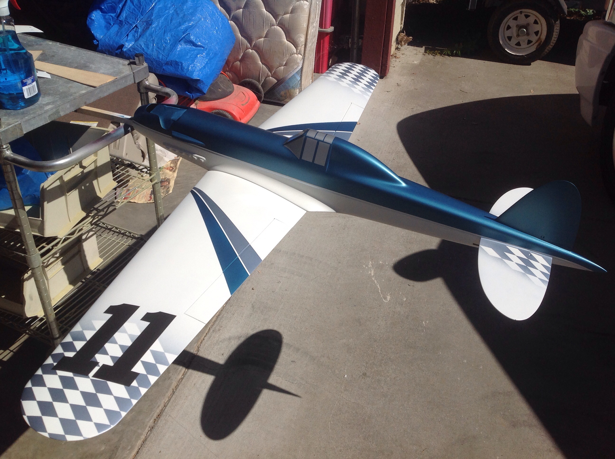

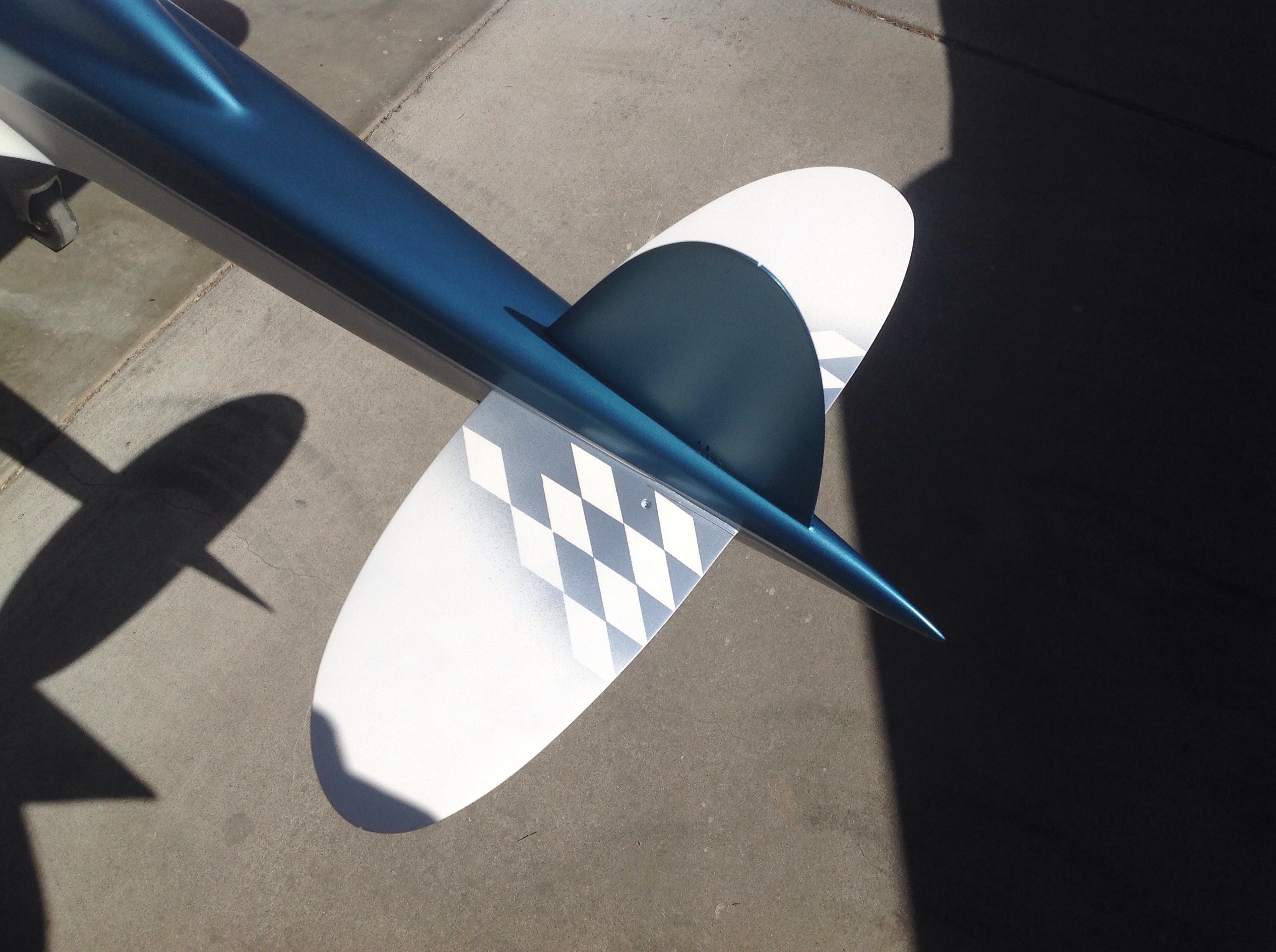

Now an update on the airplane I am building for Kaze. It's almost done. Just come clear and a couple pushrods and she is ready for delivery.

I am digging that paint job Speed!

She's a beauty, Speed!

Thanks guys. With the move and new job I completly blew the original deadline on this airplane. Kaze has been very understanding to the point I felt that he deserved something a cut above what I would have done for myself. I hope he likes it.

speed that thing is bad ass i love it
