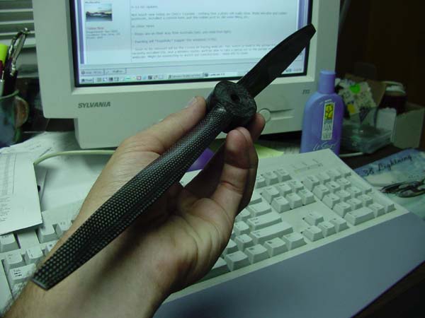

Props.... hmmm, all the way from Australia you say?
15x14 at 9500 rpm?
Is that carbon fiber?

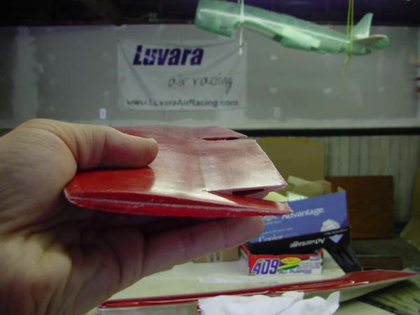

Got the camera back, so I snapped some photos

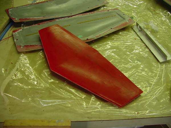

Stab out of mold with flashing trimmed
Old 06-01-2002 | 12:55 AM
My Feedback: (10)
Posts: 1,445
Received 20 Likes on 20 Posts
From: San Jose, CA
Default Tsunami - composites, part 2
Skin hinge detail

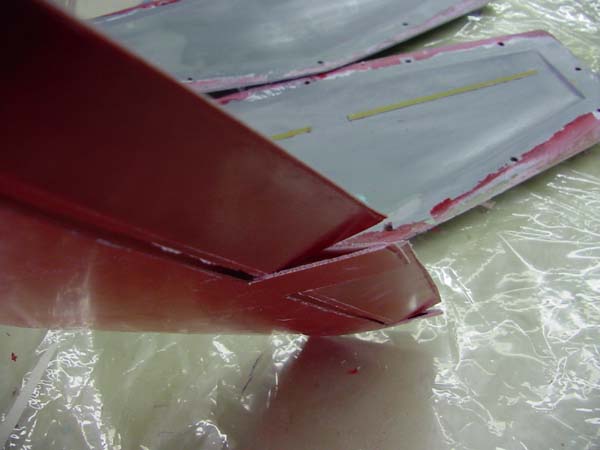

Bottom of stab with hinge up. I used 1/32" balsa on this one for skins with 3/4 oz glass on the inside and 1.5 oz outside.

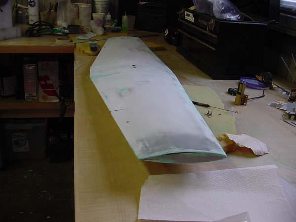

Chris's Tsunami wing awaiting primer
Old 06-01-2002 | 12:58 AM
My Feedback: (10)
Posts: 1,445
From: San Jose, CA
Chris's fuse... A little work on the fillets and she should be ready for primer.

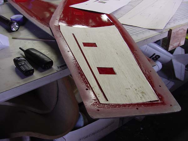

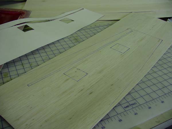

Sheeting being test-fitted in one part of the wing mold
Square cutouts are raised areas in the mold where the aileron bays will be. This makes an indent in the wing where the servo hatch will fit. I used a piece of 1/16" abs plastic that is double face taped to the mold. Really thin, what looks like scotch tape that has adhesive on both sides is used to attach it to the mold. The strip cutout is where the bottom gets a recess too. I use layers of trim tape to build this up.

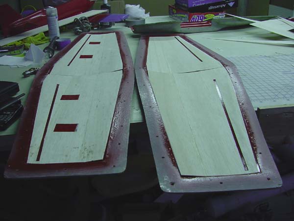

All sheeting test fitted in mold. I cut most of the glass and ran out of poop for the day. Will continue tomorrow after work.

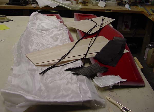

Yahoo! First evening in weeks I actually got 4 hours in the garage!
Layed up my Tsunami wing tonight. First photo was taken at 8:30pm and shows the materials basically laid out.

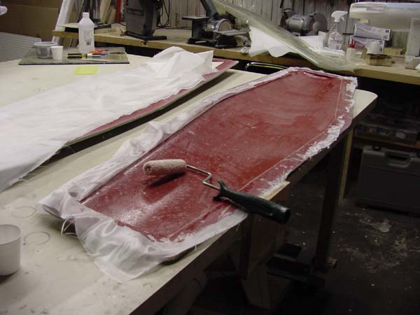

Old 06-04-2002 | 04:10 AM
My Feedback: (10)
Posts: 1,445
From: San Jose, CA
8:50 pm - Glass wetted out on top wing mold. I used two layers of 1.4oz cloth for the outer layer this time.

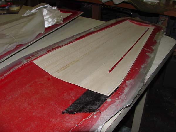

8:58 pm - Carbon put near trailing edge of wing and first wing halve core laid down

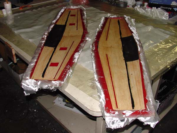

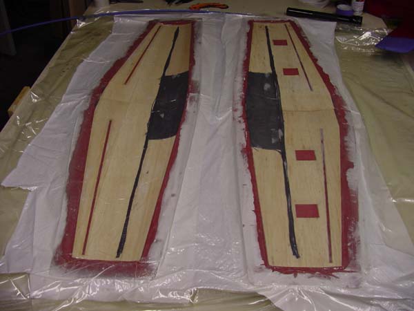

9:46pm - Both wing panels in the mold. Layup was as follows:
(Outside)
2 layers of 1.4oz
1/16" contest grade balsa
6oz Carbon near landing gear, LE, and TE areas.
Carbon tow along spar location
1.4oz glass
(Inside)

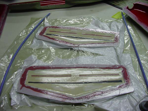

10:00pm - Peel ply was added to each halve and then they were put in the bag and the vacuum pump turned on.
