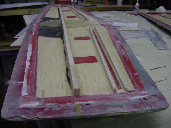

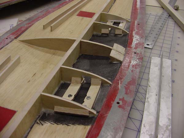

6/6/02 Update
Glued main spar in place along with sub spars near ailerons. Center rib also glued in place to prevent any possible crushing of the center section. Sanded landing gear ribs.
Wing spar layout

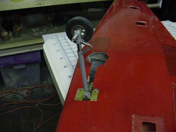

6/8/02 Update.
On 6/7 I was able to install the landing gear mounts, ribs, etc and close up the mold!
I pulled the wing out this morning (6/8) with great anticipation of improvement over the last wing. I tried a wax instead of a wax/PVA mold release combination and it worked fantastic. I was shooting to reduce the wing's weight by 12 oz and used AAA contest balsa, less glass, lighter glass, and thinner ply on the landing gear mounts....
So... results are in!
Old wing = 2 lbs, 7oz (ugh)
New wing = 1lb, 12oz
= total reduction of 11oz! Not bad!
So, the wing came out well and construction begins on the fuse tomorrow (hopefully).
I was able to primer my brother's Tsunami and his should see paint by next weekend.
Here's a photo before I closed the mold up. Spars are in place, along with lg area and center rib.

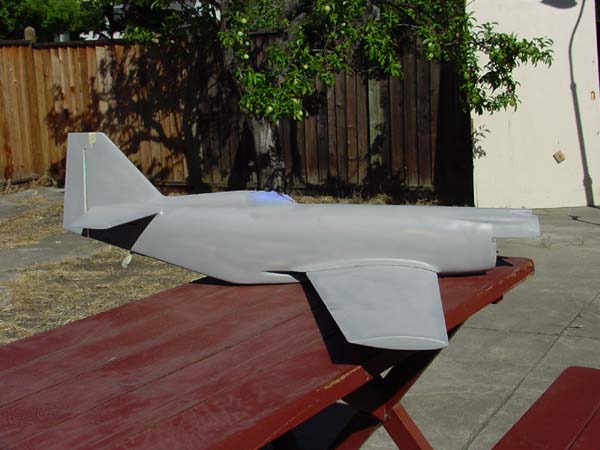

Chris's Tsunami after a coat of primer.

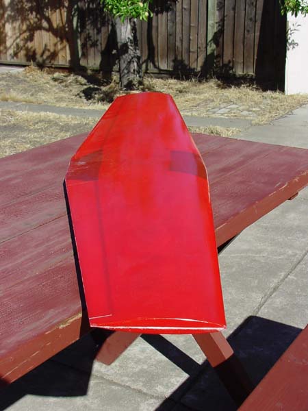

Wing out of mold with flashing trimmed. Black area is where I put carbon fiber to reinforce the areas where pressure will be put (wing bolts). I have to say that practice and diligence certainly helps when molding! I'm making progress learning this and it is rewarding to see improvement.
Michael

Landing gear install...
Well, back out to the garage! Need to lay up a fuse soon.
Michael

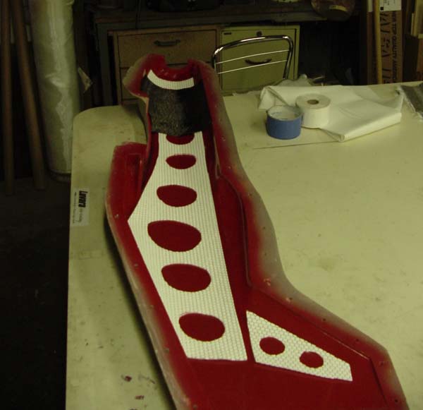

Layed up my Tsunami fuselage tonight. Started cutting glass around 8pm. Finished at 11:30 when the vacuum bag was sucked all the way down. If it wasn't for the phone ringing and well, basically running out of epoxy, it would have been an hour less. Note to self - make sure that you have enough epoxy next time! I forgot that the gallon of epoxy that I have used for making fuselages the past 2 years is finally gone! So, what did I do, you may ask? I improvised by using another brand for the last three oz. (two separate batches mixed)
Anyways, here's a series of photos.

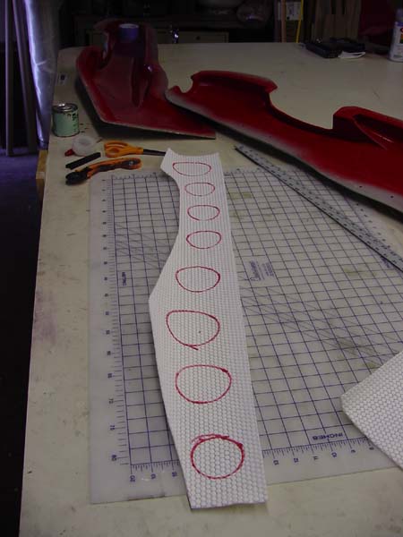

Laying out and cutting the aeromat (core material)

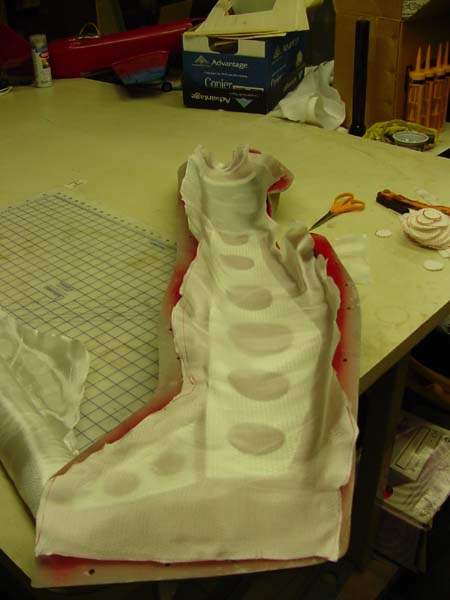

Test fitting glass, carbon, and aeromat.

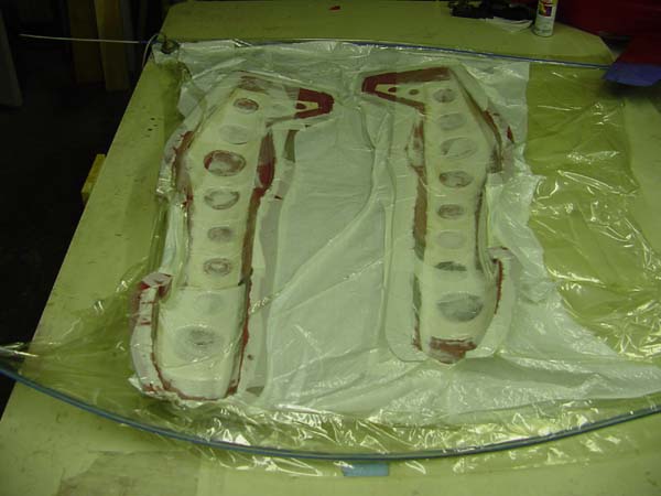

Both fuselage sides in mold... Ahh, time for bed!

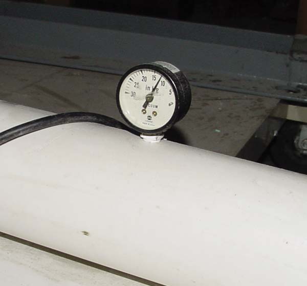

12 inches of vacuum.... that ought to be enough <g>
Results will be known tomorrow and painting will being on Chris's Tsunami.

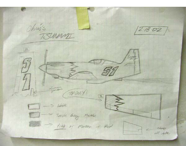

I guess the paint scheme is laid out for Chris's Tsunami... It's taped to the wall of the shop and even has a legend!

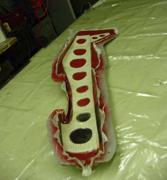

Well, eagerly took my latest fuse out of the bag this morning. Looks great with only a few blemishes. Didn't get to do anything on it aside from that, because we painted my brother's airplane....
Here's a photo of the latest layup. I tried a different aeromat template to reinforce the fuselage. Only used approximately 8-9 oz of epoxy total in the layup.

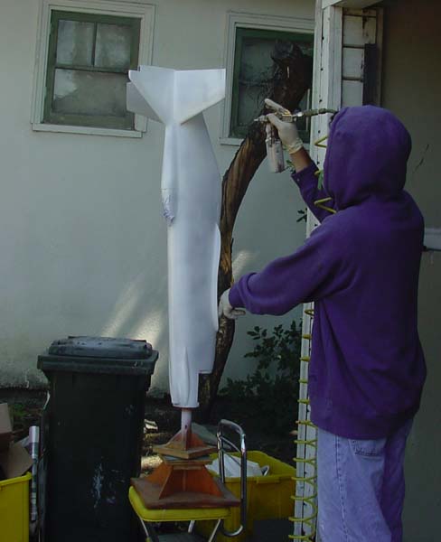

So, after a morning at our flying field, I began spraying white paint at about 2:00pm....

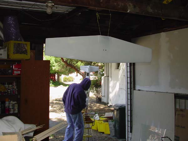

Wing's drying as I shoot the fuselage

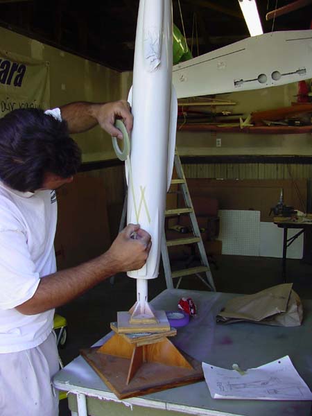

Chris masking off the fuselage with fine line tape
