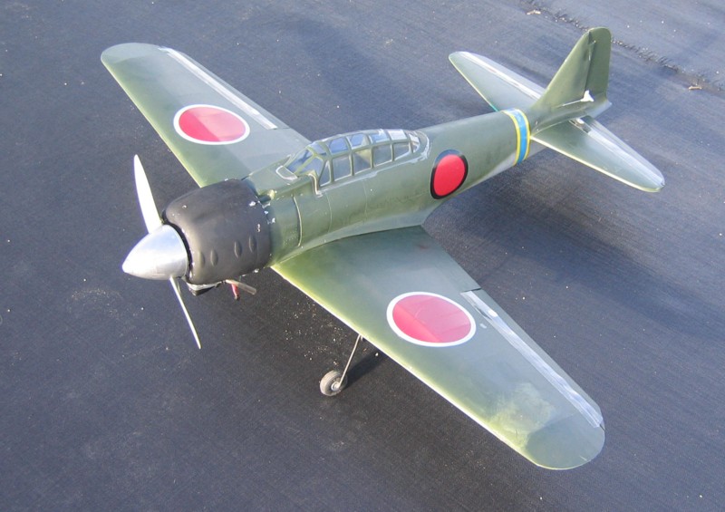

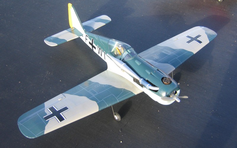

Here are some pics of the planes I mentioned above.

Default RE: Winter Racer Build and Recovering Thread.
ORIGINAL: pjakew
Being unfamiliar with the Nitromodels Zero, how would you compare the quality, and build to that of a VQ kit?
It is not as good of quality as the VQ models. It has a fiberglass fuse and built up wings and stab. It needs the weight of the big block up front to balance so the 1.10 works great. The wing is 515 squares and it flies very well. The first one I built, I put a YS .63 in it. It needed a bunch of lead on the firewall to make it balance and it wasn't even a good Bronze plane. With the 1.10 it can almost go gold. The hardware is junk but for $88 you can easily toss it out and put good stuff in it. One good thing is that the front is a full fiberglass wrap with the ply firewall behind so it is pretty tough.
Blessings, Terry

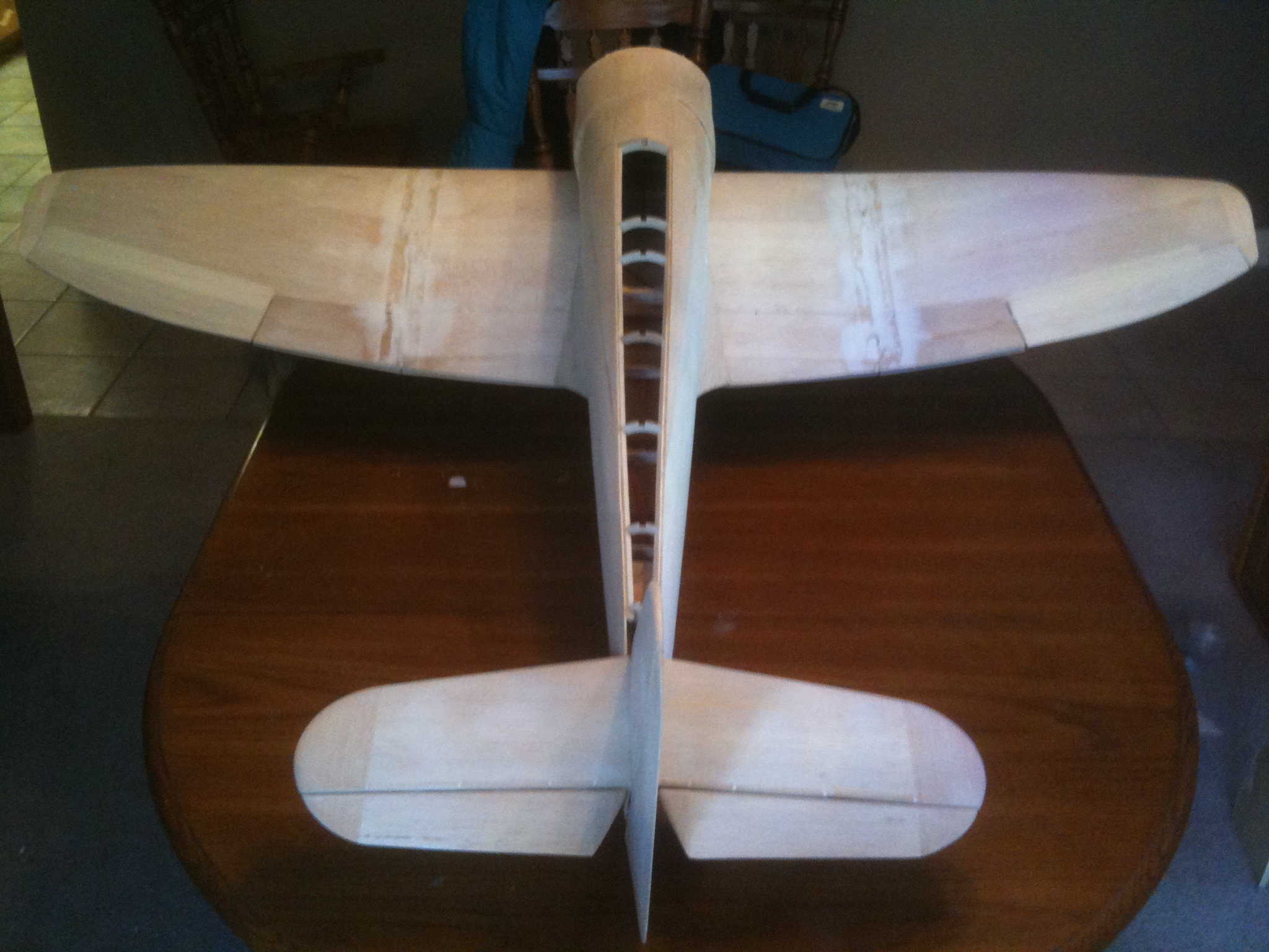

Well I haven't put pics on in awhile so here is my progress.........

That Sea Fury is coming along nice, but will it be ready by April? I neet to get my 190D done, but until I figure out the landing gear situation, on the shelf it stays.

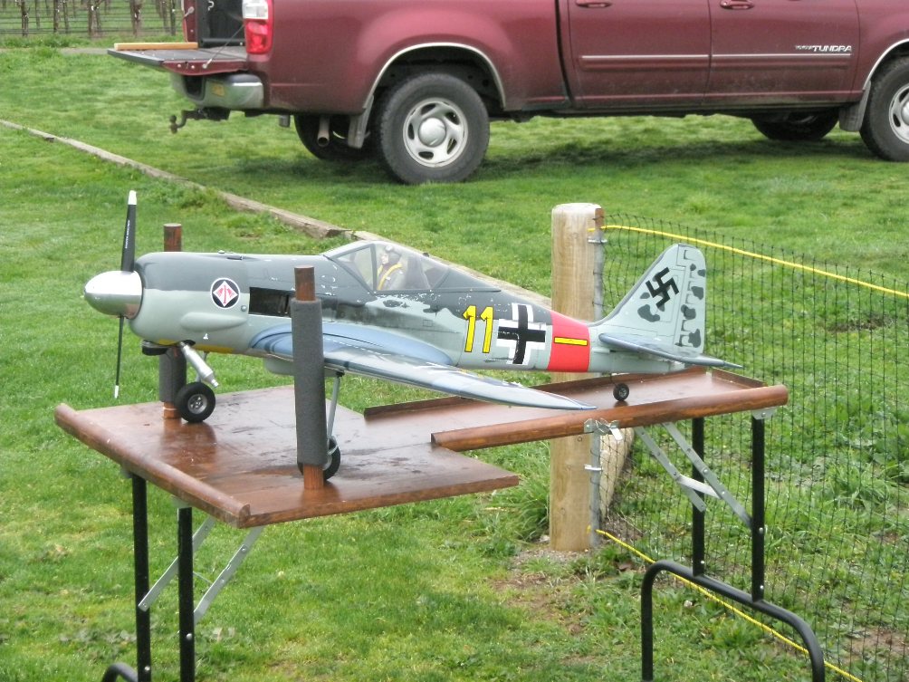

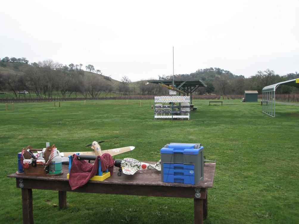

Did you ever have one of those days where you literally had to fight tooth and nail to get one plane in the air? I had one of those days.
First I tried to fly my Parkzone 109G. Something happened to the ESC because I could get the control surfaces working but the motor would not do a thing. Brought it home and changed out the esc and now it works fine. Sending the stock one back to Horizion, what a piece of S%#$!
Took me a while to get the motor on the VQ 190 started, but once I did it started running great. Took me about 5-6 restarts to get it down the runway because the grass is so tall and wet since there has been little to no dry days or sunshine. It just kept nosing over just trying to taxi the thing. Got it up in the air and on takeoff one of the wheels decided to turn parallel with the wing. So I flew it for about 4 minutes and with the gear up I slid her in. Slid real nice on the wet grass with no damage or even a scratch. I was going to tighte the set screw on the landing gear when I heard some rattling in the cowling when I lifted it up. two metric screws came out of the bottom of the cowling that must have come off the motor somewhere. I just got the motor back from YS parts and service so either they did not tighten them down or stripped the threads on the motor. I will find out this evening when I open it up. The maiden of the plane was O.K. I guess since I did not crash the thing, but it was just such a pain for the whole day at the field I just wish I would have stayed home [&o].
Will report back later when I know what is up with the motor.

Opened her up and finally found where the screws came from. The two bottom screws of the backplate had come out. Screwed them back in and they fit real snug so at least they were not stripped (thank God!). Put them back in with a tiny bit of blue locktite to keep them from backing out again. Next is the wheel, that should not be to big of a chore.
