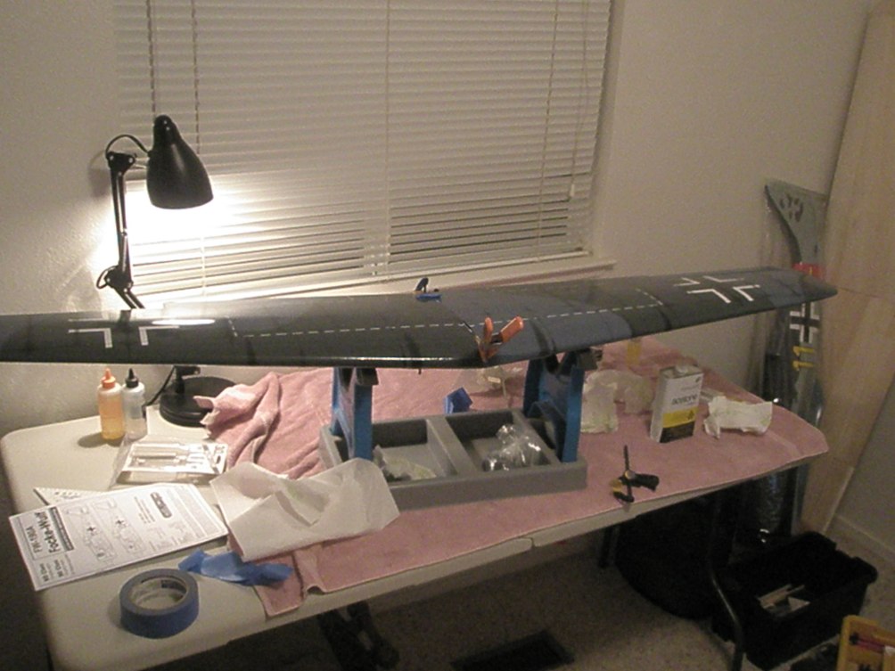

Here is an update with pics to help KEEP THE THREAD ON TOPIC.
Wing glued and went together fine, just needed to sand the spar a little to get it to fit without being too snug. Picked up some stuff from the LHS in Ukiah, but it is pretty skimpy. Looks like I will have to be ordering some stuff if I want it anytime soon.

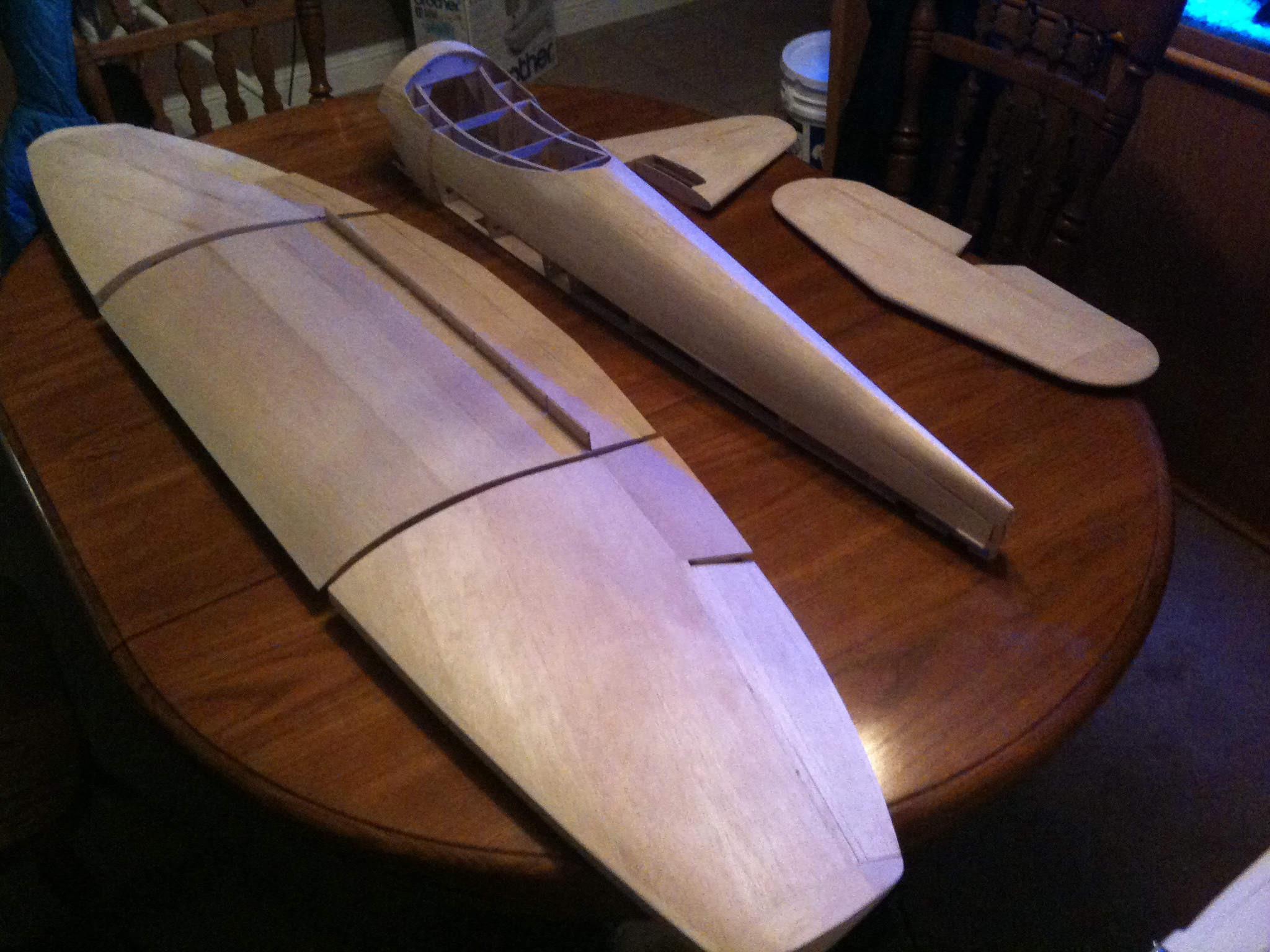

Well, I might be working on something, or maybe not. If I was, then I couldn't tell anybody. Guess we shall wait and see what I bring to the races!

From the looks of the picture your trying to get a table to fly. What are you thinking? Is it because so much of your race day has your plane on the repair bench that you thought that you would build the bench into the plane? Now that is some out of the box thinking. I now have a new hero....... all hail the Leadfoot.

Haha, that's funny Skids! Kim always told me that I can fly the box it came in, so now I'm gonna try flying the table!

I have to say Casey that I am a bit perplexed with the tail, Corsair....Sea Fury.....those are my two guesses.

Hey Jake, I would say that if I were building a new secret plane (which I'm not sure I am), I would say you are on the right track!

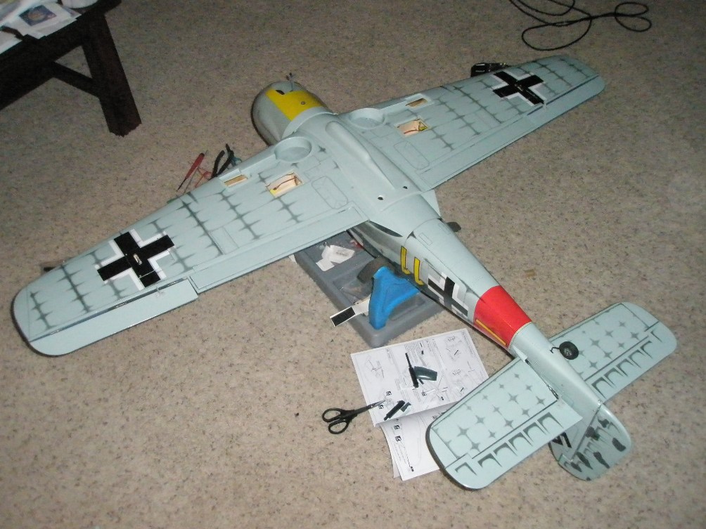

Some progress on mine. I have been busy this week so not much time on the plane.
First off, after joining the wing I fiberglassed the tongue that joins to the fuse. I remember others saying that the tongue on previous VQ kits would start to break apart after some wear so I do this to all the VQ kits with fiberglass and thin CA. Takes about 2 minutes and increases the strength of the tongue. A cheap man's fiberglassing.
Got the horizontal stab glued. It lined up pretty nice and did not need to sand to get it to fit. Also went in straight without needing to shim it to zero it out. Very pleased about that.
Went ahead and cut out the holes for the remote glow igniter. I have this on both my Macchi and Hurricane and love these things. Also made the hole for the battery charge port. Also am fitting a 16oz Dubro fuel tank. Had to shave the inside of one of the front bulkhead to get it in, but no problems. Now I just fireproof the inside of the fuse with thinned up Epoxy. Chance Harris taught me that one and really adds to the strength of the plane. Will report back when more is done.

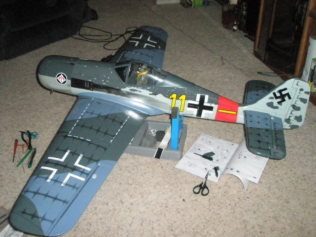

Got a little time in this week to get some stuff done. May not look like much, but it is a big chunk for me.
I got all the control surfaces glued in, so we are in business there. Also got the horns screwed in. Still need to put horns on the flaps.
Also got the motor mount drilled and screwed in. The plane came with this pretty neat jig system for finding center and drilling your holes for your blind nuts. Worked like a gem. Right now I am fuelproofing/strengthening the firewall on this thing. If you ever had a VQ kit in the past you know you need the strengthen the firewall a tad on these. Usually just a coat off epoxy does the trick. You can see the gleen in the pic.
The next two weeks I have off from school so I should be able to finish this puppy, no problem. This plane will take a Y.S. .91, but for right now it will have just a regular O.S. .91 so I can play with it until I get the Y.S. tuned up. A few pics included.
