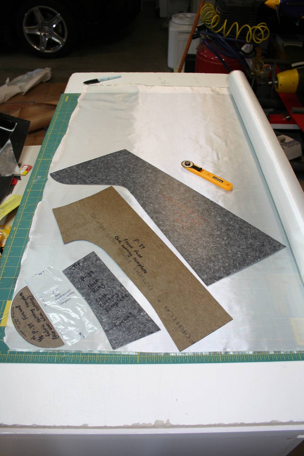

Okay, back to business for awhile . . .
I'm breaking some of my own rules. I was supposed to start this process when I had 3 - 4 relatively uninterupted days to complete this project, and that didn't happen! I have WAY to much going on to do this the "right" way. This is gonna be one of those "Do as I say, <u>not</u> as I do" kind of entries. Sorry guys! So, Step 9 really should be Step 1, and should have been done before I even started waxing my molds. By not following my own rules,and not anticipating just how much other conflicts are halting quick progression through the steps, I am letting my initial thinned epoxy coat cure way too long before adding cloth and I will notend up witha solid chemical bond. I'll talk more about this at the end.
<u>Step 9</u>:
Beings I didn't do this at the beginning like I am supposed to, It is time to start cutting my fabric. First, I pull out all my templates(pic 1); then, clean and prep my cloth cutting table (pic 2). I have a fabric cutting mat and Olfa fabric cuttersthatmake life SOMUCH simplerthan trying to cut fiberglass with scissors. These tools are VERYWELLWORTHTHEMONEY! I have templates for all the wood parts (wing ribs, fuse formers, etc., that I make out of formica) to build other structures of the plane, and then I have fabric cutting templates. Fabric cutting templates can be made from just about anything that will not snag the fabric. The P-51 fabric templates show templates made from mostly paper and cardboard (pic 3); and the P-39 templates (in pic 2) are made from my favorite material . . . formica. I misplaced most of my oldP-47 fabric templates (they were made from the blue plastic sheet that was a backing liner from some old 3/4 oz. FG cloth), and had to make new ones. Yet another reason why this should have been done before-hand! All these little delaysreally start to add up!
<u>Step 9</u>:

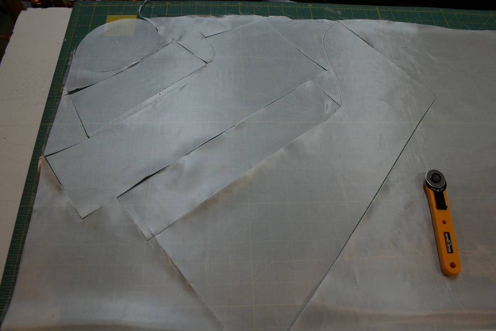

Here I am laying the templates for the P-39 out on the fabric.
You might notice that I am trying to cut my parts at approximately a 45 degree bias. The fabric tends to take compound curves better when it has been cut at an angle to the weave. Following the weave horizontally or vertically doesn't seem to work quite as well, at times. Also, don't get carried away trying to put everything at exactly 45 degrees either. You'll have too much waste; and, from what I've read, the structure is supposed to be stronger if the weave patterns vary somewhat. The best analagy I could give is to think about how plywood is stronger when the grain patterns are alternated, as opposed to all running exactly the same direction.
Also,I'll bet you are thinking, "The dimensions of the fabric cutting templateslook "off" somehow." They probably seem too tall to you, when compared to the horizontal axis. That is because they <u>are</u> a little taller than they are wide. Remember the sides of the fuse are not straight, they are curved, so it takes a little extra fabric vertically to compensate for this fact.

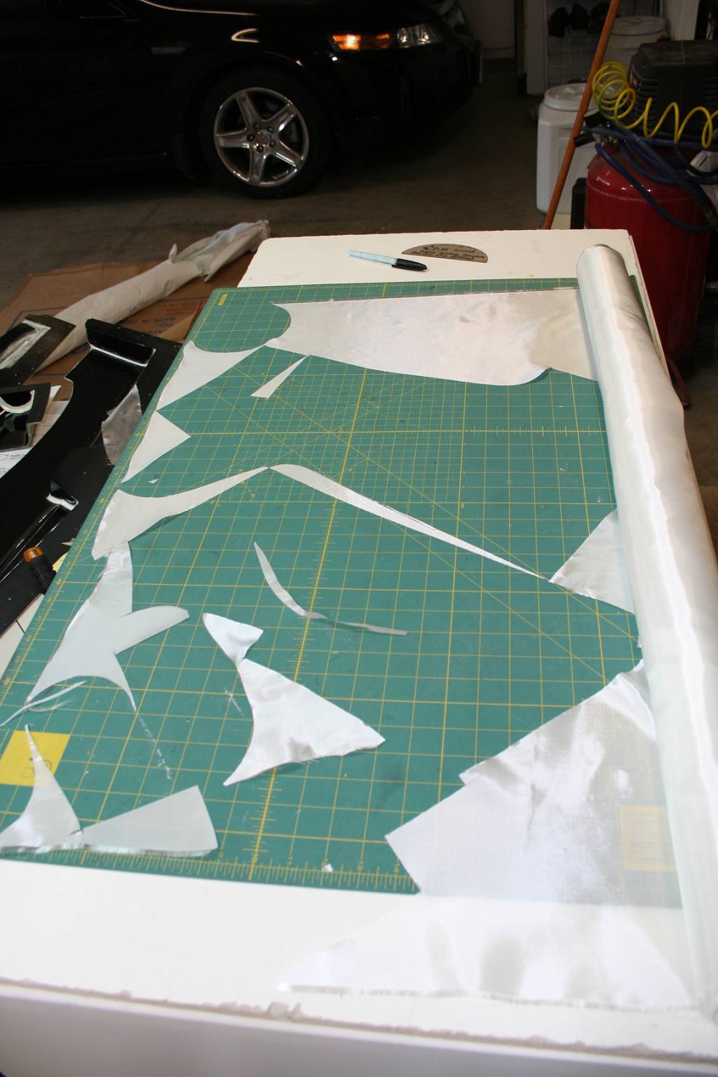

Cutting around the templates . . .
Man, my new, smaller 28 mm Olfa cutter takes those curves great! If you are going to buy a cutter, I think this is the one to get.

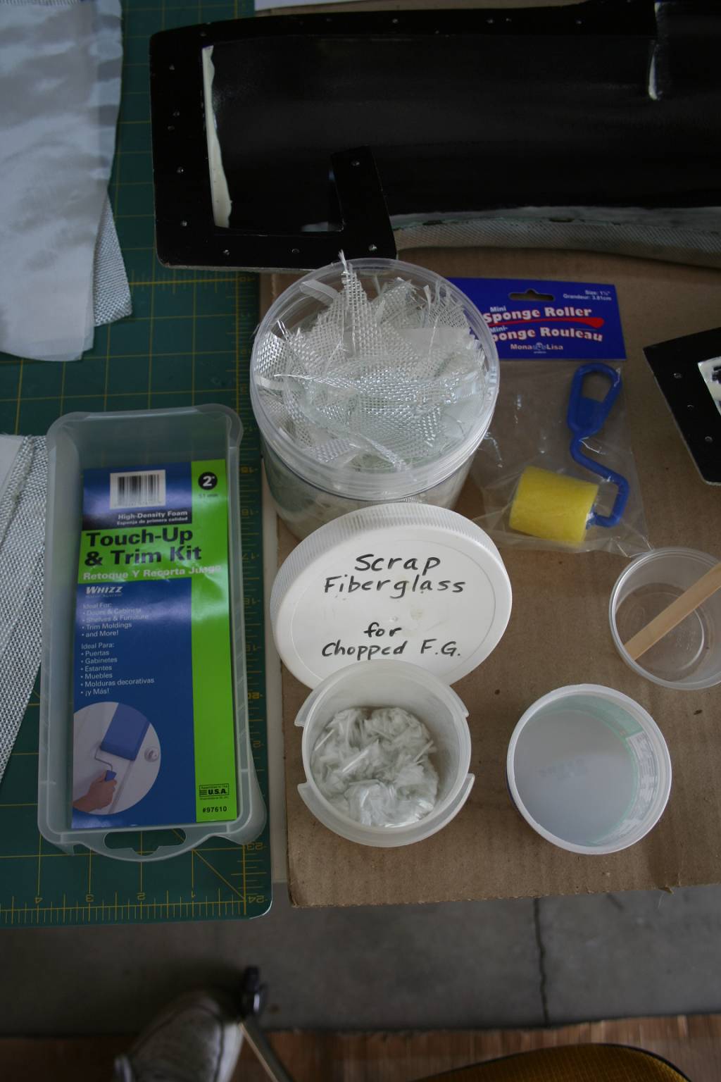

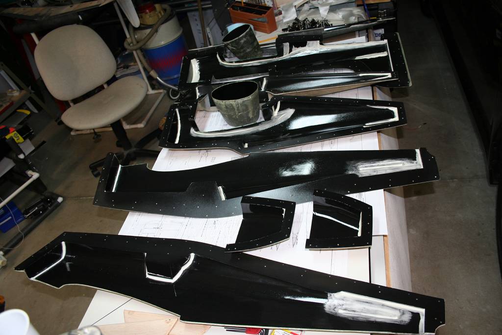

I decided to start laying up the P-47 first. (Probably because I was so happy with the prototype's performance during the "Big Kahuna" SAM Warbird Race, and expect this one to be lighter, and therefore better.)
Here are shots of me getting everything I need laid out:<ul>[*]fuse halves[*]major sections of cut cloth (I used a 3 oz. tight weave, followed by a 6 oz. loose weave)[*]scrap cardboard to protect my work table and gloves to protect my hands(that epoxy gets messy and can be troublesome!)[*]flux brush[*]1-1/2" disposable trim roller[*]1" brush (the roller worked so well, that I never ended up needing this)[*]Also pulled to the workstation before starting, so it would be handy,was my scrap FG cloth, Olfa rotary cutter, a trash can, and a couple of paper towels.[/list]Once you start mixing epoxy, it is like a race; and, as I said earlier: "Life revolves around cure times."
By the way, the light spots on the top nose section and just below the "razorback" are from me sanding out some minor imperfections that I couldn't remove from my original plug. That is where I sanded through my original "tooling coat" that had graphite powder mixed into it . . . thus the black finish to the rest of the mold surface, yet some light spots. This variation would be similar to that caused bysanding through the primer on a primered surface. That taught me to do two black tooling coats, ever since. (But that is a topic for another thread.)

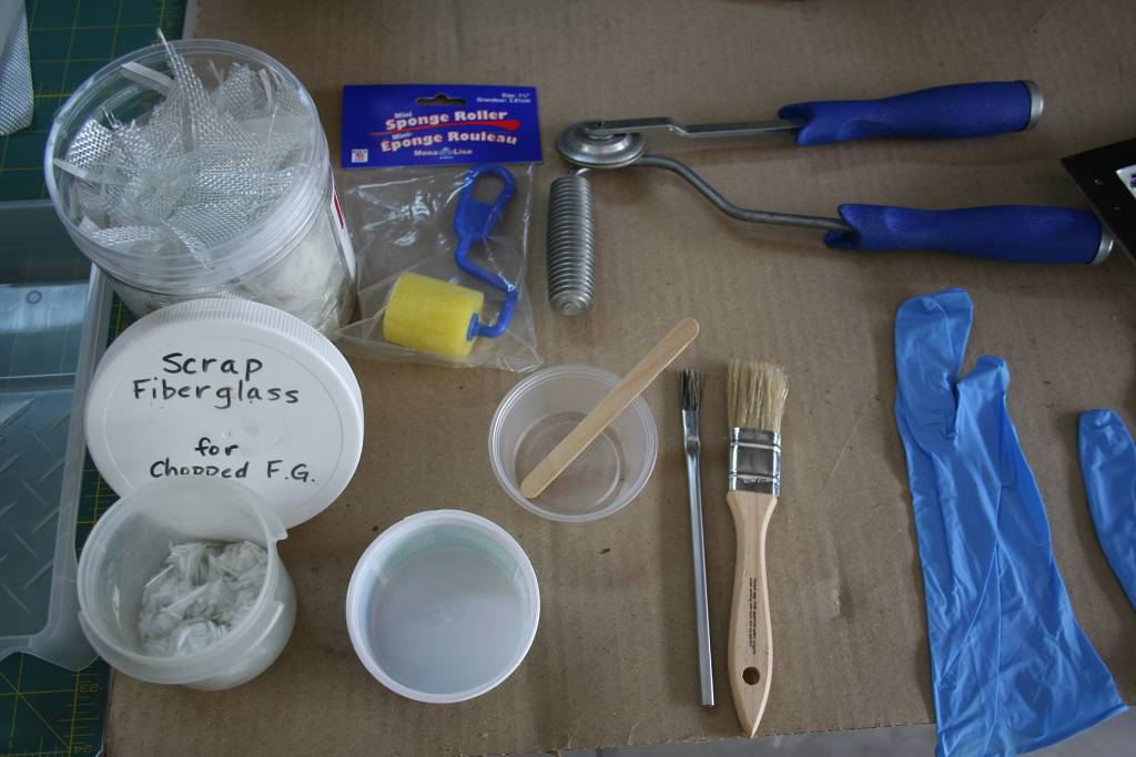

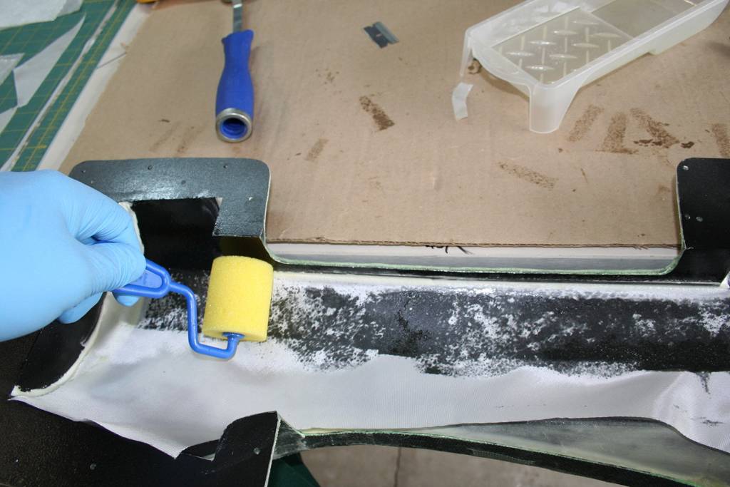

#47
Another new method I am trying out with this build is to apply most of my epoxy using a small trim paint roller, rather than a 1" brush. My hope is that it will:
Other materials pre-pulled to the workstation and at the ready, notmentioned in the prior post,are:
- speed up the process of wetting out the cloth
- more evenly distribute the epoxy to the surface of the mold
- help me to use less epoxy and save on weight. Thisis importantbeings hand lay-ups supposedly use 30% more epoxy than vacuum bagging, and I don't have any vacuum bagging equipment, yet.
- by largely eliminating (or at leatminimizing) the use of the 1-1/2" bristle brushI hope to eliminate or minimize thesnagging of the bristles on the cloth, and therefore the deforming of the weave ofmy cloth.
- chopped fiberglass
- mixing cups and popsicle stick for mixingepoxy
- mini paint pan
- denatured alcohol
- composite rollers (the metal rollers with blue handles at the top of the 2ndpic)
#48

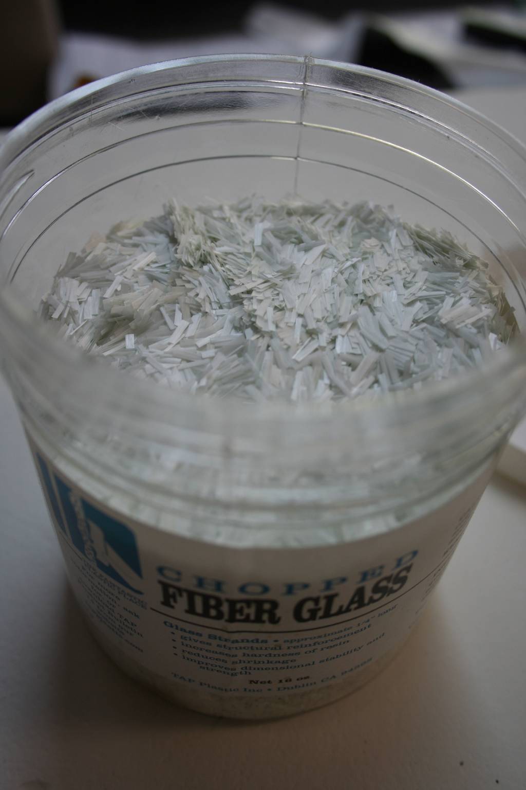

I have not been pleased with the commercially available chopped fiberglass. I stays too rigid (like mixing in uncooked long grain rice) and does not smoothly conform to the surface it is being applied to. (See pic. #1) That makes it nearly impossible to get the cloth to lie down and conform to the mold surface adequately. In turn, this weakens the strenth of the layup, which is counter tothe point of adding it in the first place.
Therefore I take the really small pieces of my scrap FG cloth and put it in a small Tupperware container. I then stick the tips of sharp scissors inside the container and cut repeatedly. I want thecloth to be mainly in individualstrands, but don't overdo it or you won't havemuch strength being added(usuallyaboutthe time myhand starts getting tired, anyway). In my opinion this is a filler material that adds at least a little bit of strength, as opposed to microballoons, and also helps to hide the weave ofthe cloth being applied. Andby using the scrap, it is essentially free (I was going to throw it away, anyway), while working better for my needs than the commercially available option.

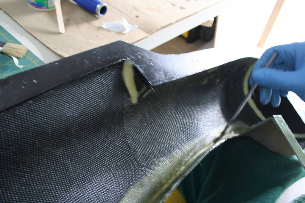

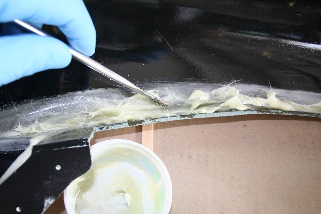

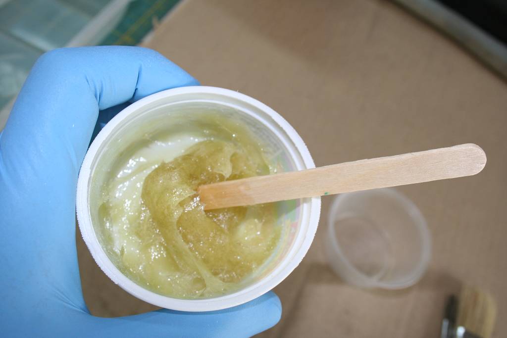

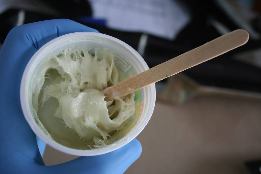

Using the pump dispensers, I mix some epoxy into a shallow cup (pictured is a Cozy Shack Pudding conainer). As before, mix epoxy thoroughly before adding filler.
Add chopped FG strand and mix.
#50
I use this "slurry" to help partially fill in the still-too-tight-for-clothareas of the wing fillets. This gives me more strength . . . certainly less brittleness . . . than microballoons.
