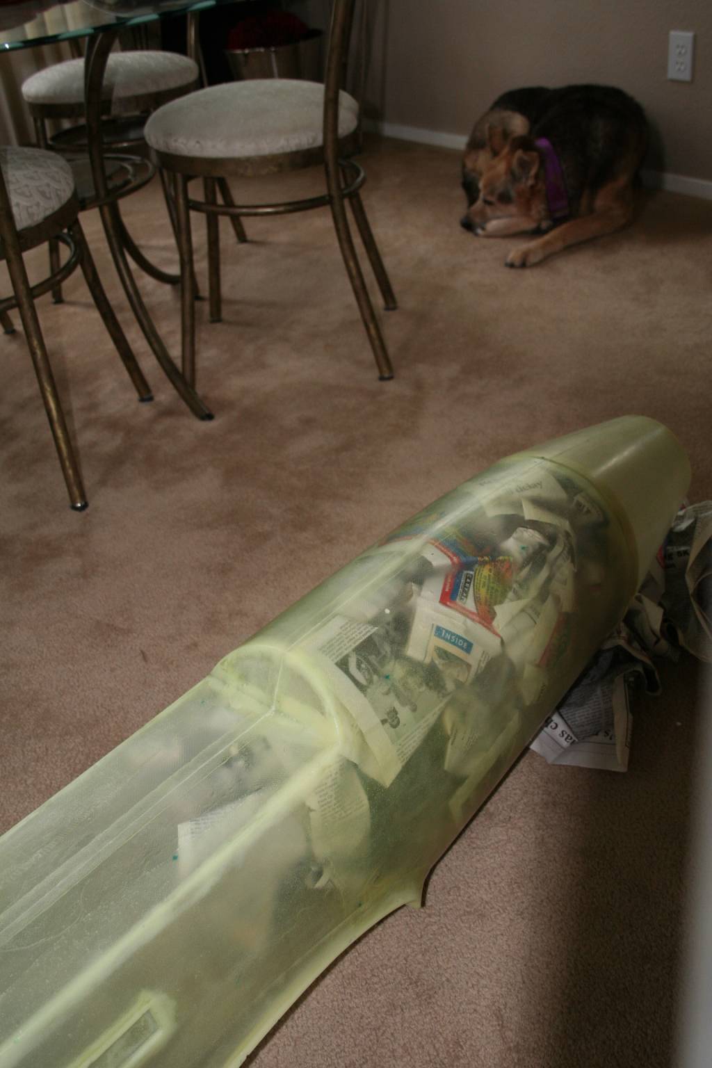

Okay, so Skids says I need to get back to this, and I don't want to let him down, so here we go . . .
So the next morning I wake up and I have a little . . . well, more like a big surprise waiting for me! I received my fiberglass fuse for my 1/4 scale P-39 from Bob Neider at American Eagle. Thanks Bob!!!
I can't wait to see what it looks like with a 96" wing sitting under it. (I'm still waitiing for the rest of the order to arrive.)

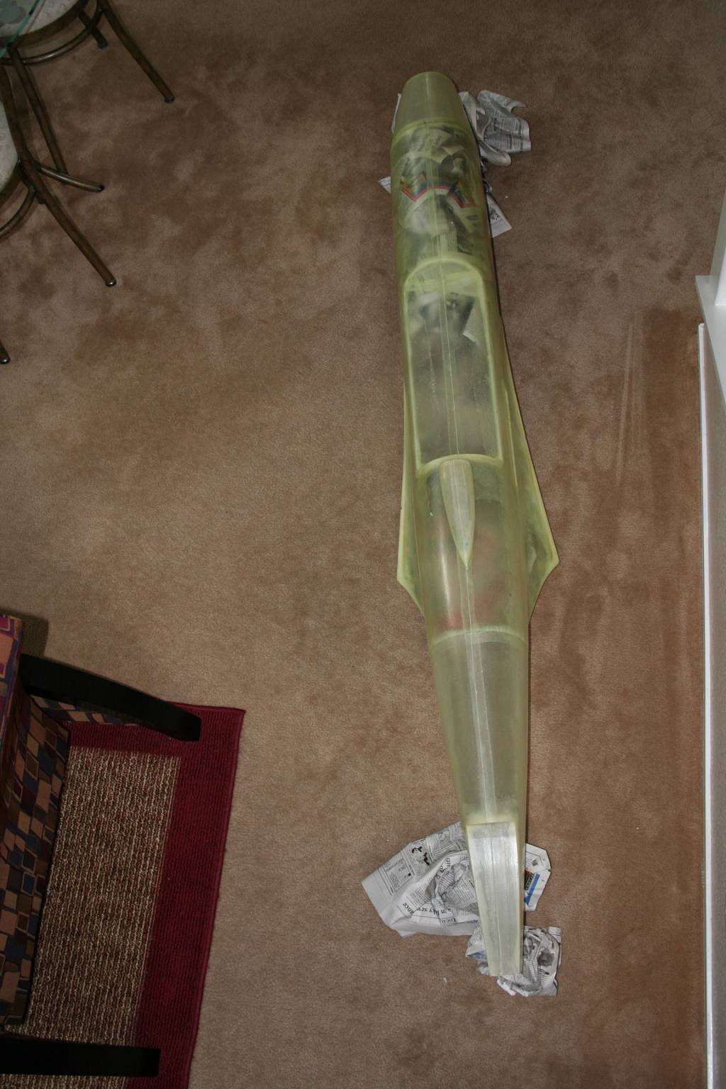

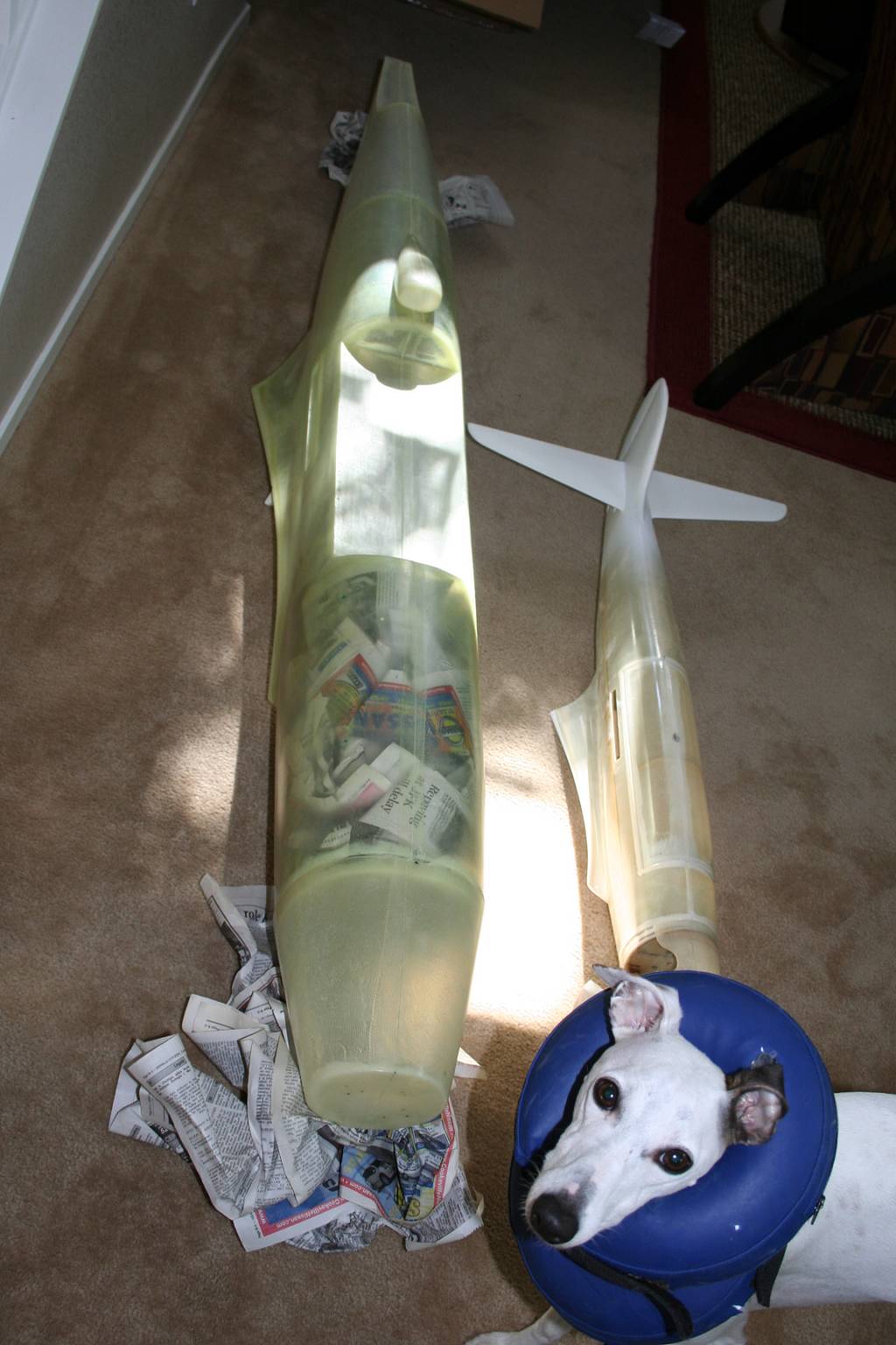

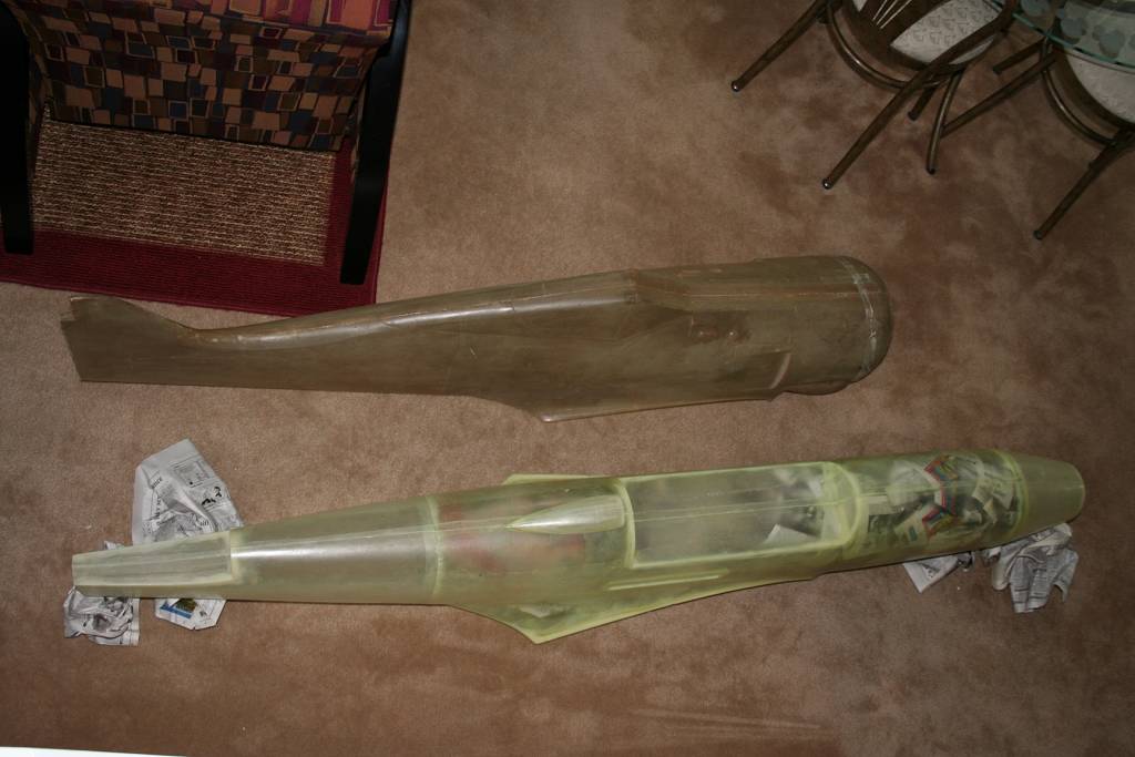

This thing is a MONSTER! I'm gonna have to buy a bigger truck or a trailer (hook me up Planebender!) just to get this thing out to the field.
#1 Look how much bigger it is than even an o-l-d 1/4 scale Fw190 fuse I have.
#2& 3 So I put one of my 1/8th scale P-39 fuses next to it for reference, and of course I can't keep the dogs out of my shots. Every shot one of them has to walk through the frame. It's like my build: it seems everyone and everything is conspiring against me to make it harder that it should be! But at least they offer another sense of perspective.
Talk about motivation to get back to work on the new 1/8th P-39 lay-up.
(Oh, and for those kind enough to call me the next day and ask how Devo (the whippet) was doing after I had to rush away from the Big Kahuna race, Sunday, she is doing great. Also in picture #2, you can see her wearing blue inflatable inner-tubes around her neck to attempt to make it more difficult for her to get at her stitches. . . so "no", I don't have bizarre tastes in animal collars.)

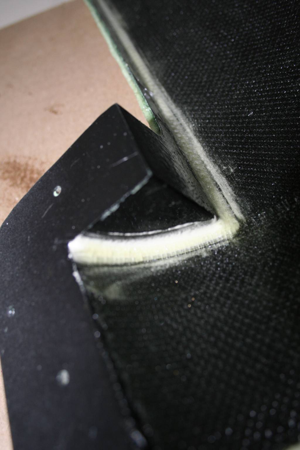

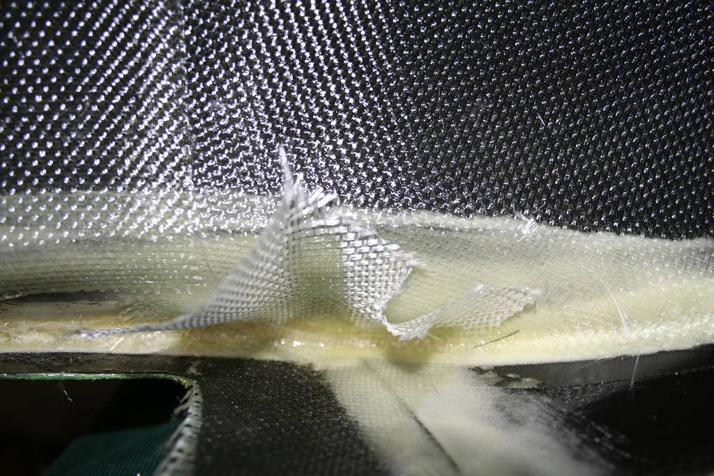

#1 You also have to be careful not to accidentally cut off any of the raised"keys" on the lold half that has the raised part.
#2 This is what taught me that lesson. Notice the raised key at the left of the mold (almost dead center of picture) has been cut off. What a rookie mistake I made a few years ago!

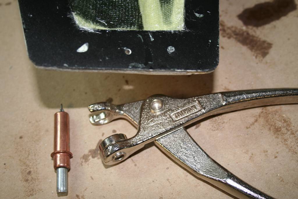

After everything is trimmed, I am ready to join the mold halves. To hold them together relatively tightly, with no investment in specializedequipment,one could use binder clips (available at a Staples or OfficeDepot near you).
#1 However, I did take a little bit of a plunge here and boughtseveral klecos and a pair of kleco pliers to hold my molds together even better. I ordered mine from FibreGlast. I think there are very much worth the investment. In fact, I only have enough to join one mold together, so I will need to order more of them.
I believe that klecos are most commonly used by the aerospace industry as a way of temporarily holding perforatedaluminum sheeting inplace on aircraftuntil replaced one at a time with rivets. (Is that right, Tommy Gun?)

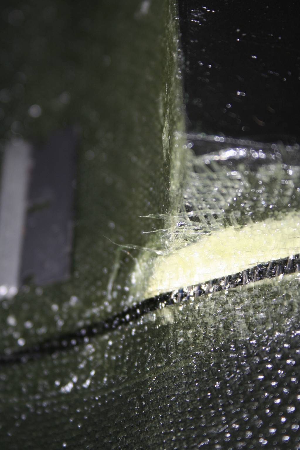

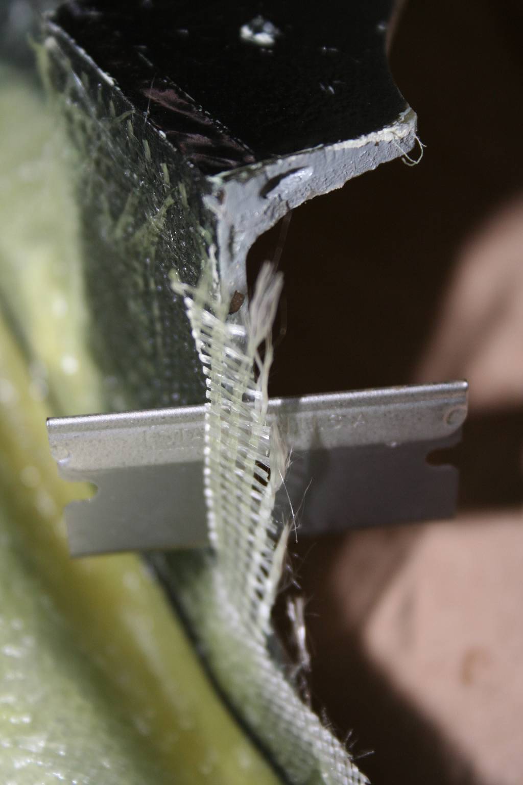

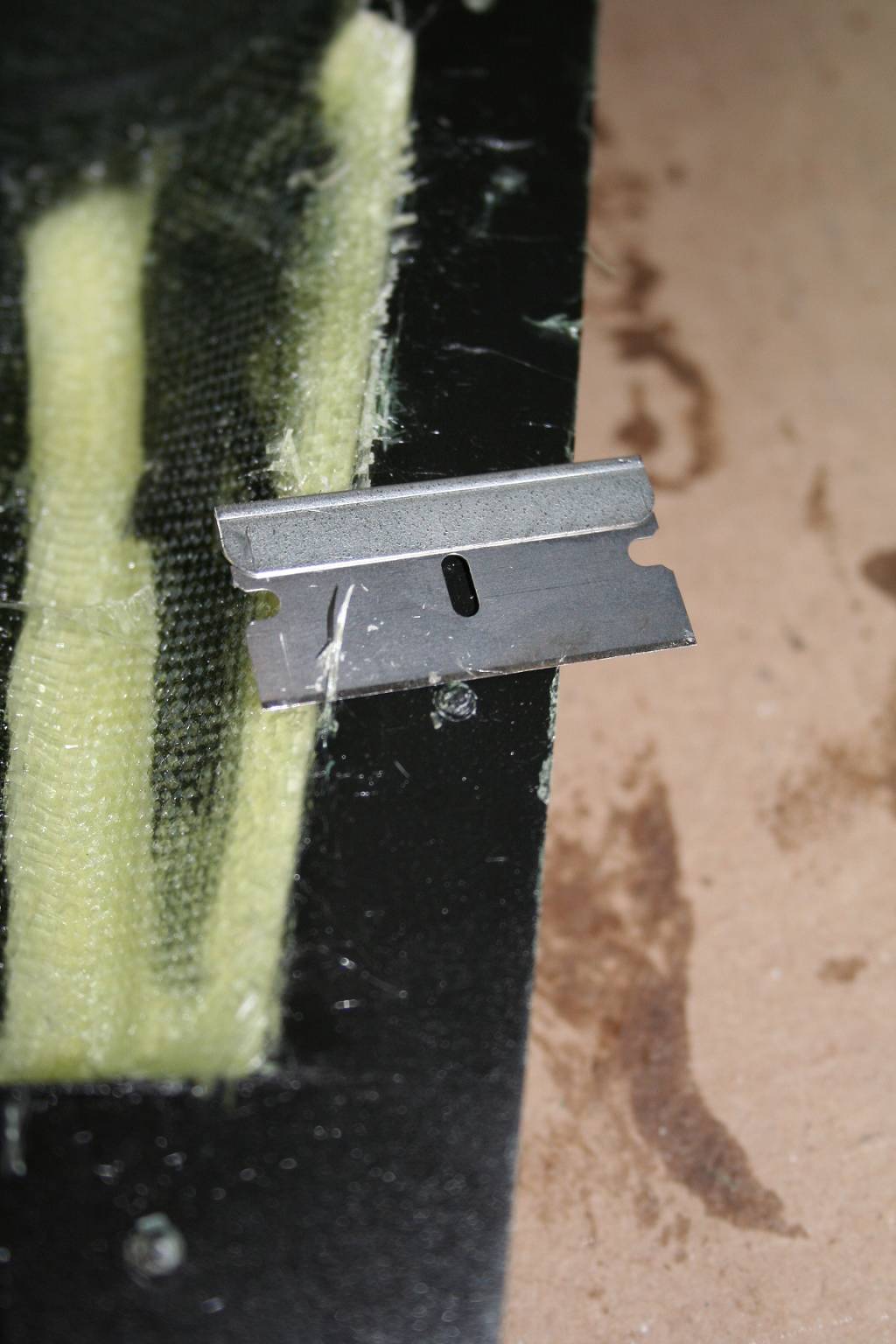

Before you permanently join the halves, take a few minutes to find those "stragglers" . . . those fibers that partially unraveled or for some other reason did not lay down properly. Now that they are wetted down and partially cured, they will poke you pretty good. The closer they are to being fully cured, the more vicious they get. They are like sharp needles; and much too often, when they poke you, they break off and embed themselves under the skin,like slivers on steroids!
Either sand them (I've learned the hard way to fold the sandpaper over or they will often pass through one layer and still get you), or cut them with a razor or X-acto blade.

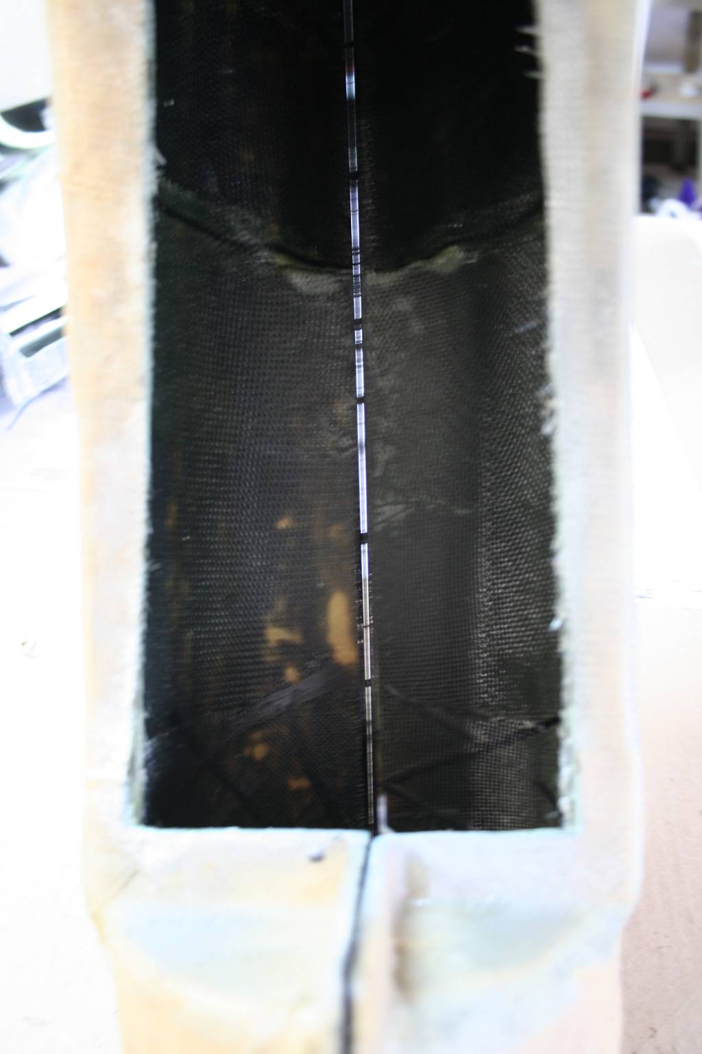

#1 Now when I trial fit the fuse halves, that's what I want to see when I look through the wing bay into the mold at the top seam. That barely visible light-linemeans that I have a nice, tight fit and am ready to join the halves.
#2 I use the kleco pliers to install the klecos. Because I am saving some of my limited number of klecos for the P-39 also, Ionly have enough to put them in the most criticalareas , then put plenty of binder clips around and in-between to still hold all areas of the mold together tightly.

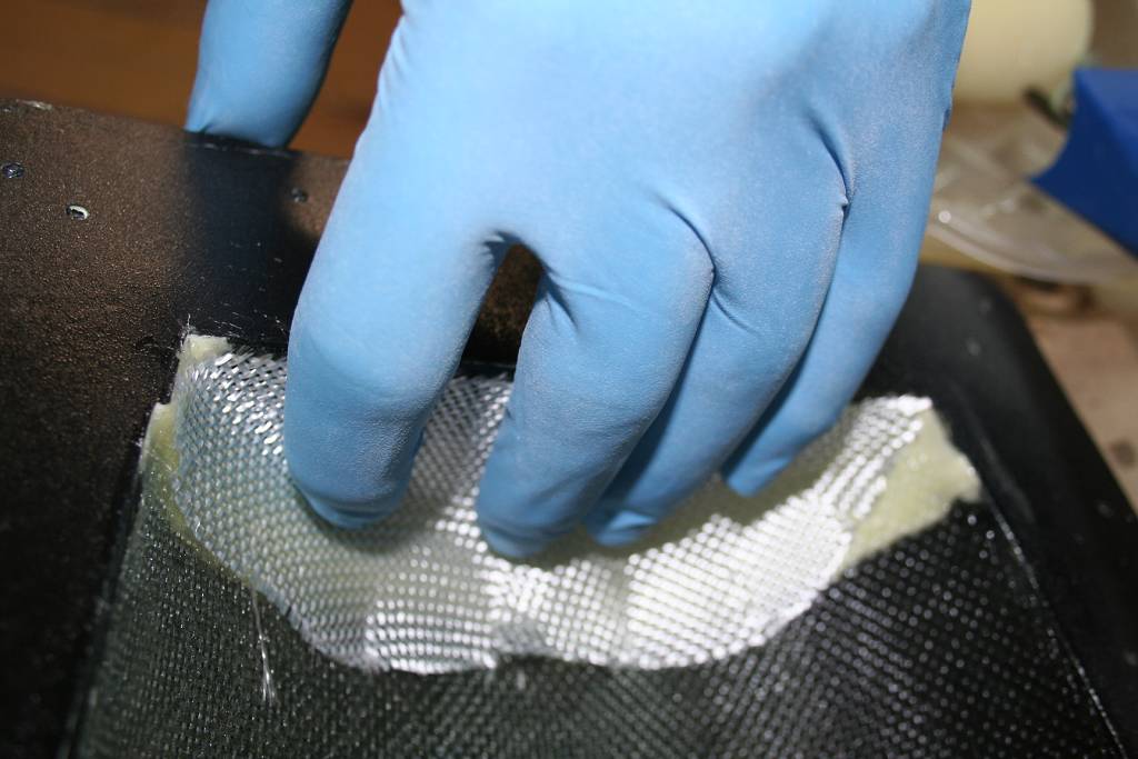

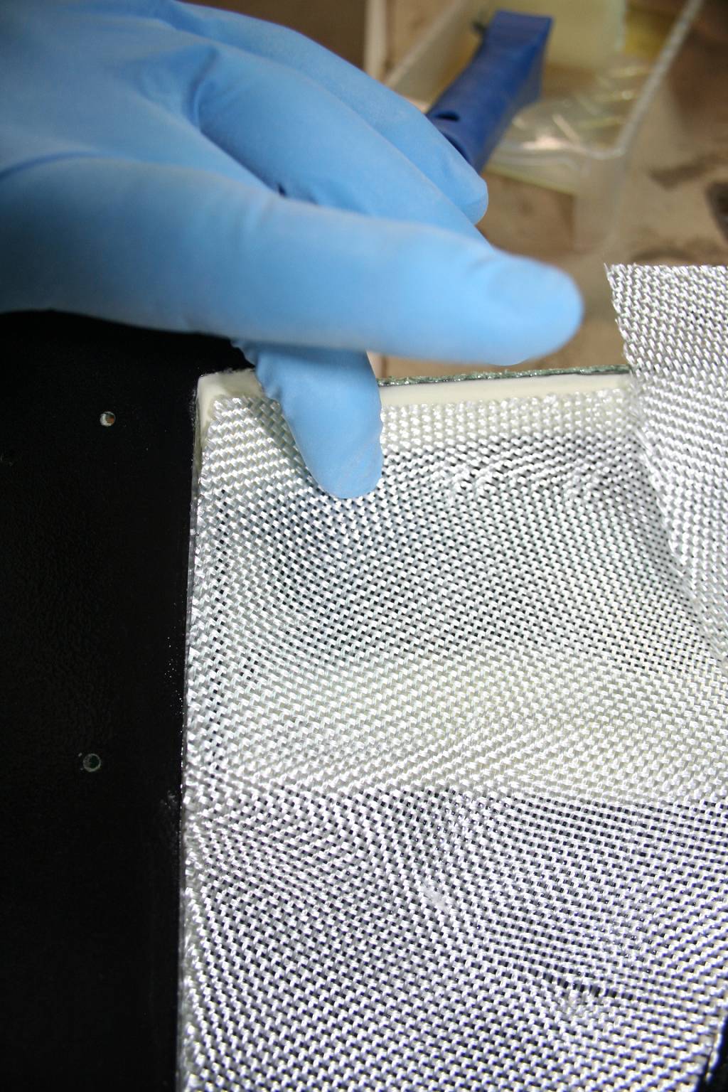

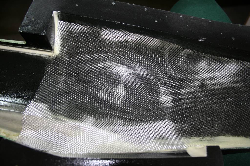

#1 Here is the second layer of 6 oz. cloth being put in place.
#2 Fiberglass (especially this looser weave) is easy to manipulate and draw it to fill in the initial gap in the corner.
ID:	1423792   Click image for larger version

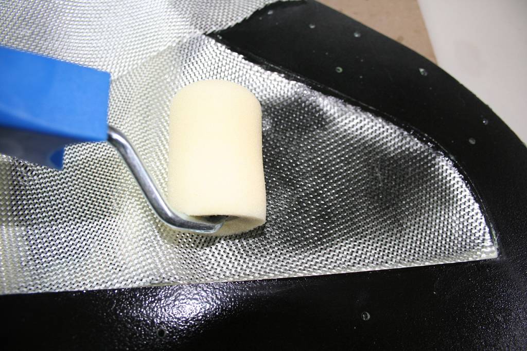

Got my epoxy and roller in-place and ready to go, and startrolling downthe vertical fin

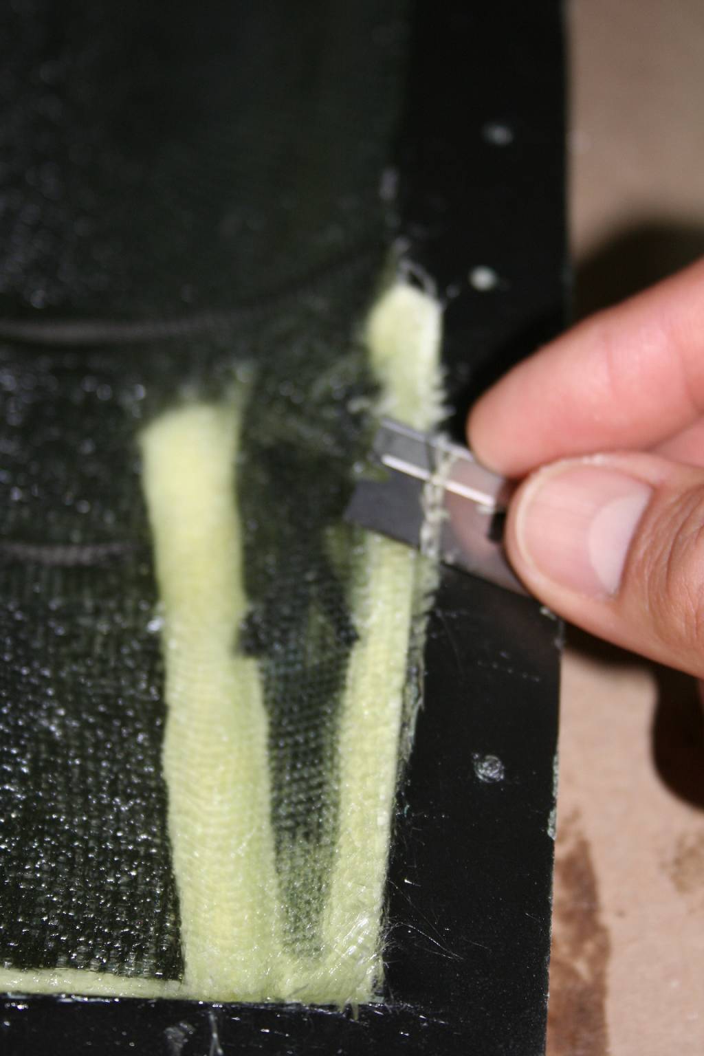

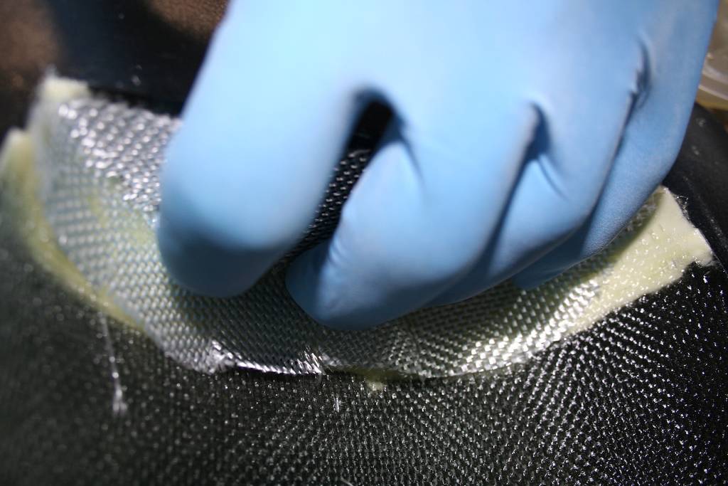

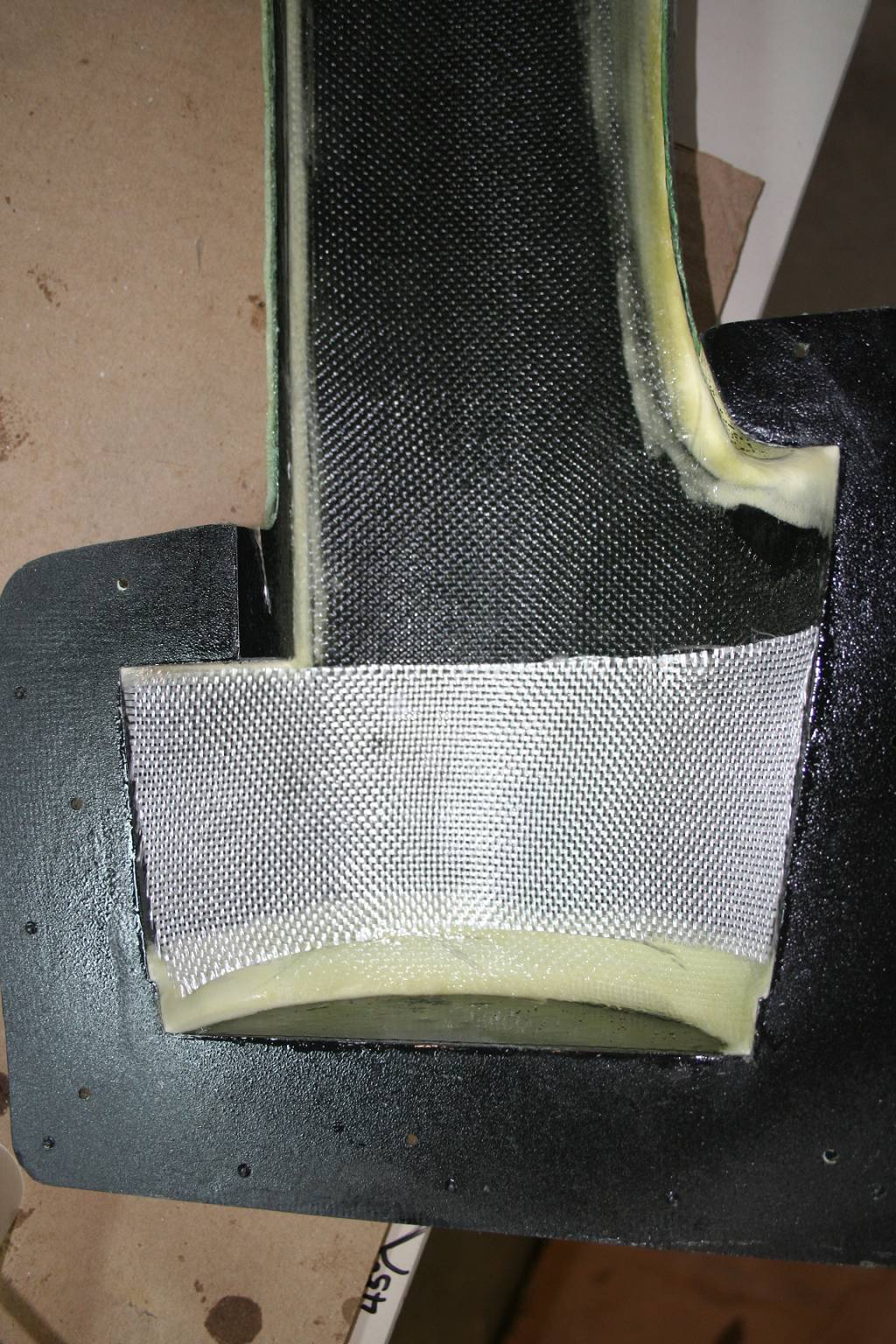

Because that stab saddle is the most difficult part for me to get to lay down well, and still keep everything lined up well with all those curves, I get this area down first, thenwork down and forward on the fuse.
ID:	1423796   Click image for larger version

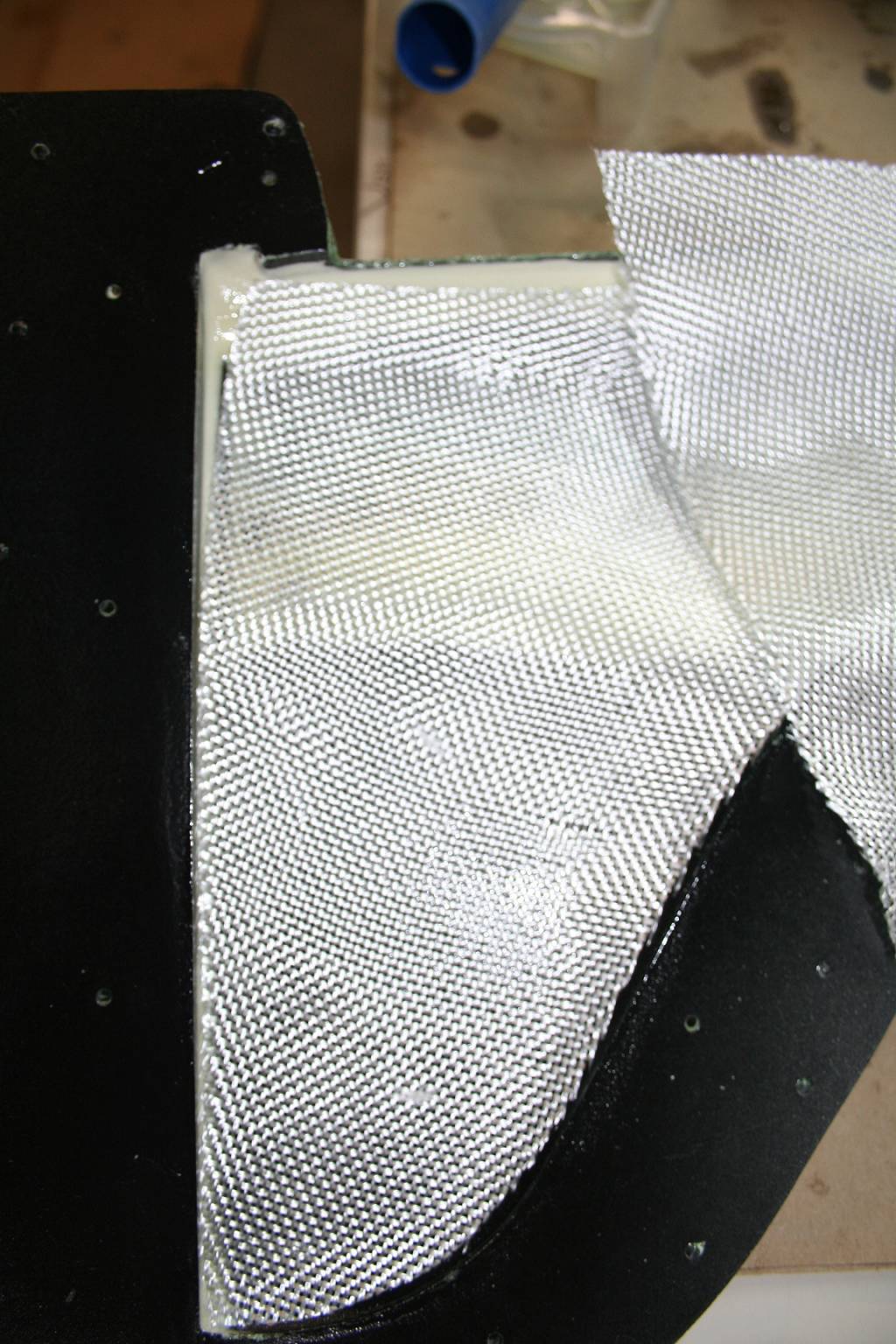

Okay, that piece is wetted out. Let's overlap with the nose ring piece.
ID:	1423801   Click image for larger version

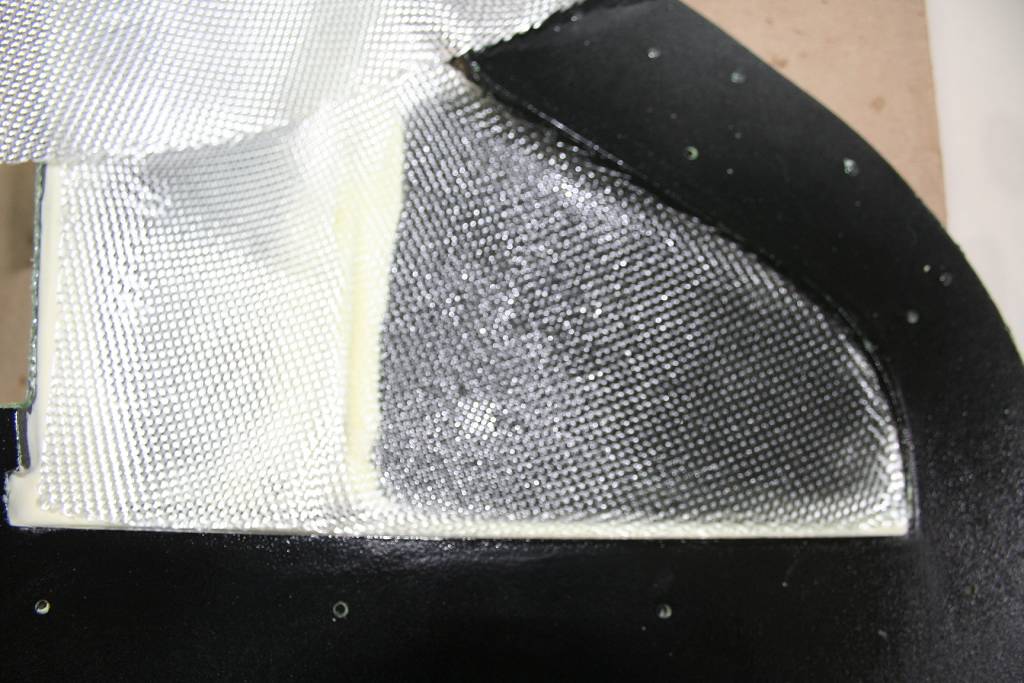

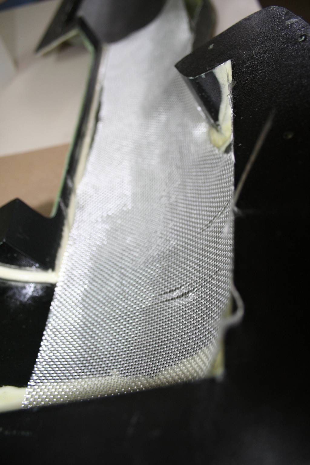

Overlapping the firewall piece and getting it into position. Notice the relief cuts that are necessaryfor the cloth to seat properly with all these complex curves. All these overlapping layers will really at to the strength of the nose section, to hold up to the torque ofthat YS110.
ID:	1423803   Click image for larger version

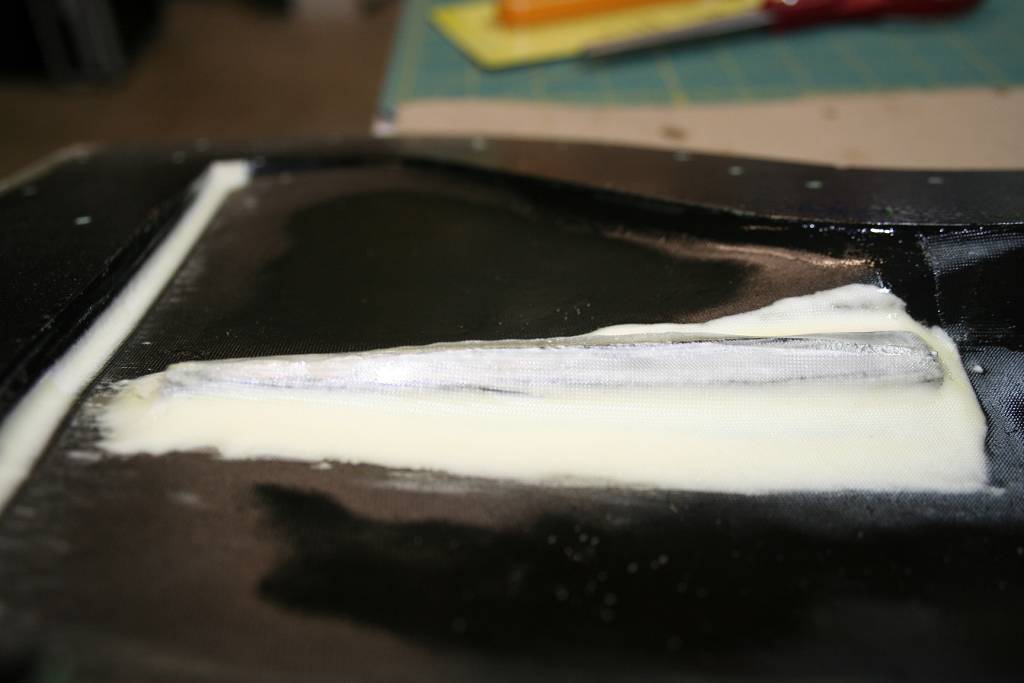

Cutting out some triangles from my scrap that will used to fill the areas that would normally butt up against a former.Like the previous piece,these willbe given relief cuts, as well

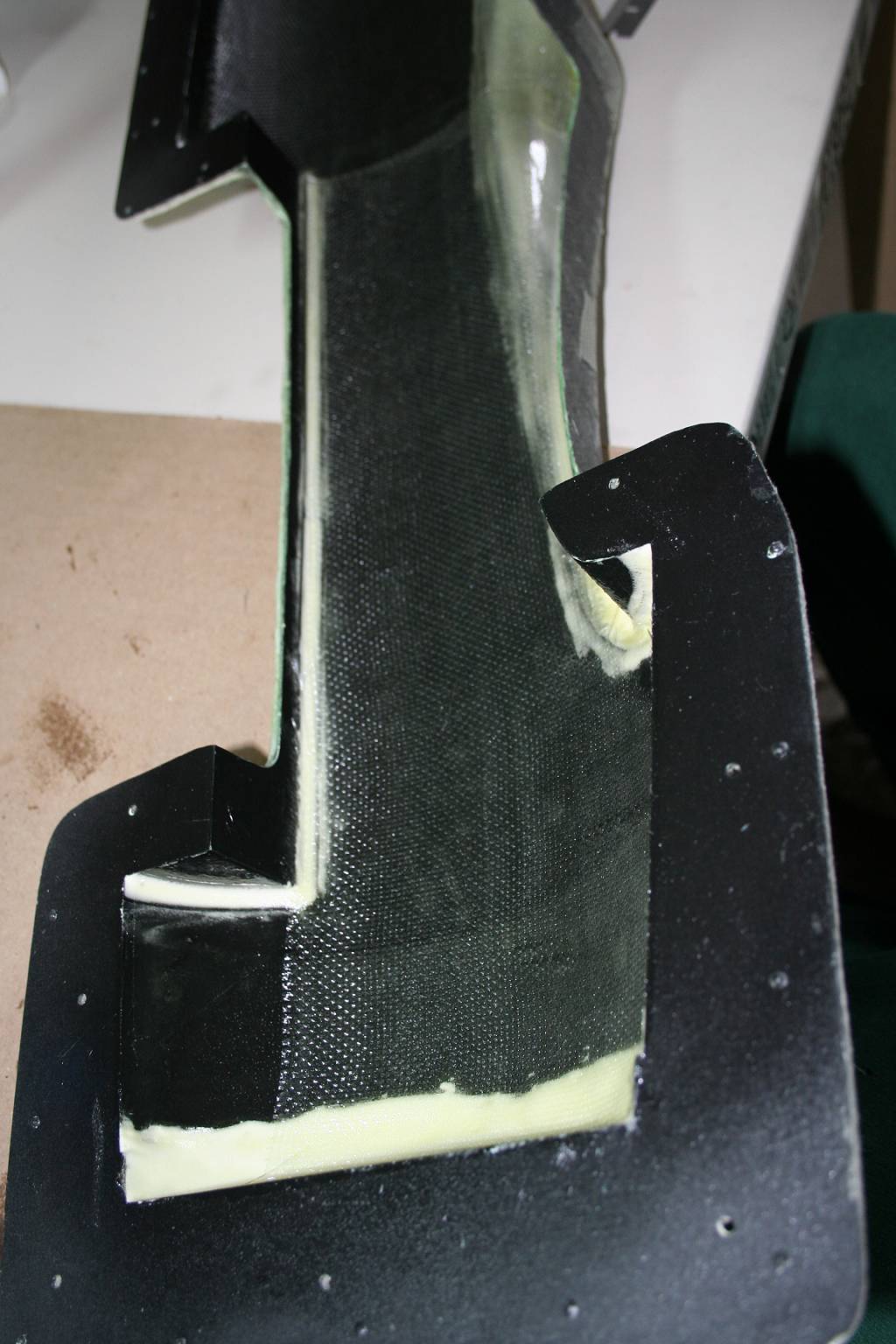

As with the P-47, I also use small scrap pieces to reinforce the wing hold-down block and line the wing fillets.

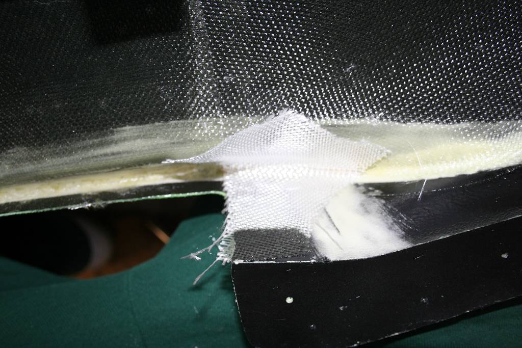

Again, notice the relief cuts so the piece will conform nicely when wetted out.

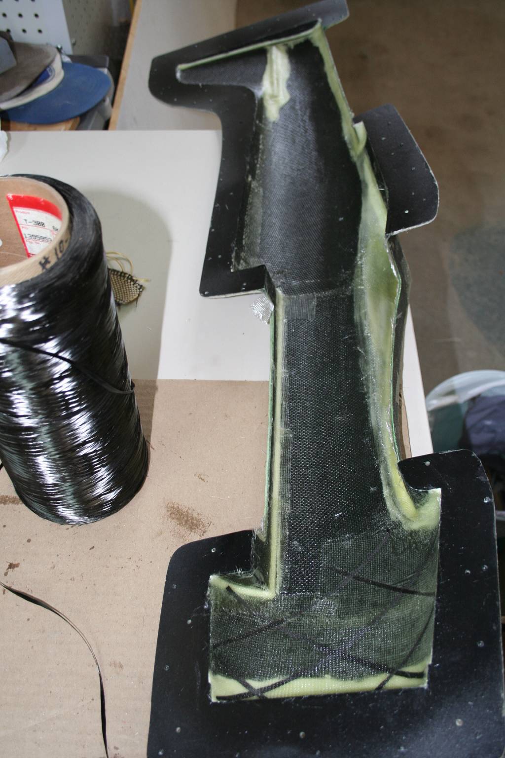

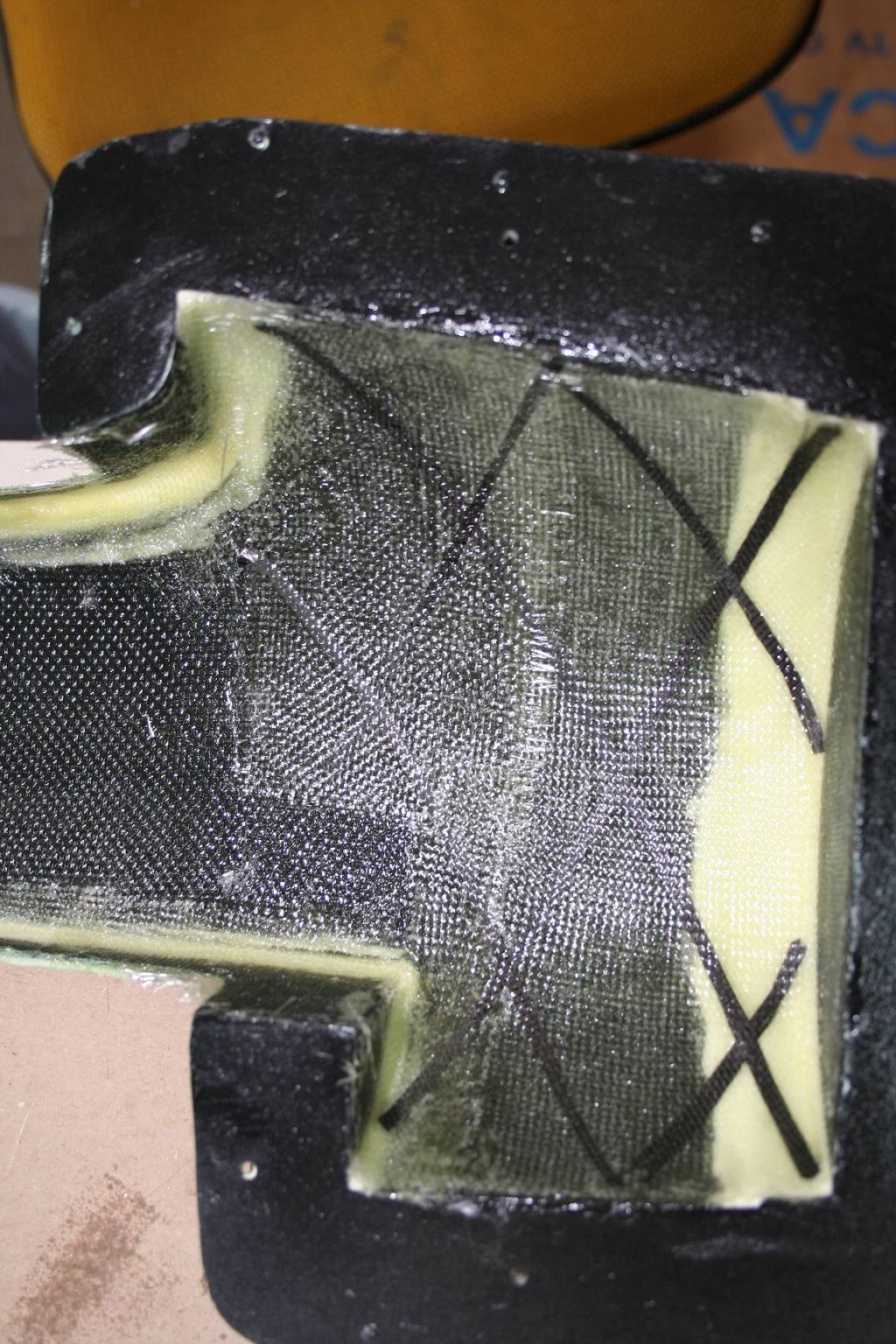

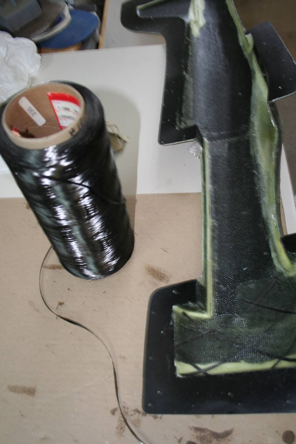

First half is nearly done. Just gonna add some carbon fiber tow to further strengthen the nose.
ID:	1423813   Click image for larger version

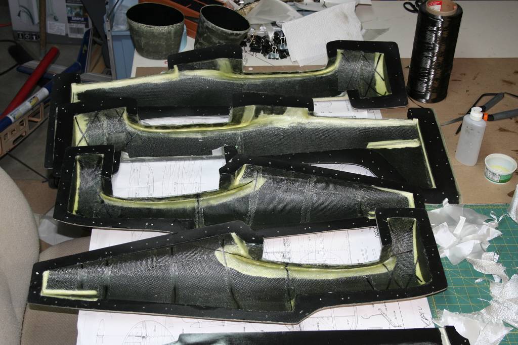

Finally, the first half is done!
Here's a closeup of the nose with another nose-ringlayer and a couple more scraps to cover the tow.
ID:	1423815   Click image for larger version

The other half of the P-39 is getting done in the same fashion.

So, here are the 4 mold halves that comprise the P-47 and P-39 that are ready to be joined.
(I was just trial fitting the P-47 earlier, and also trying to show you what the klecos were like and how they work. I am going to wait overnight to let the P-39 set up before seaming / joiningboth fuses.)
