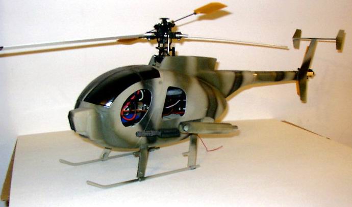

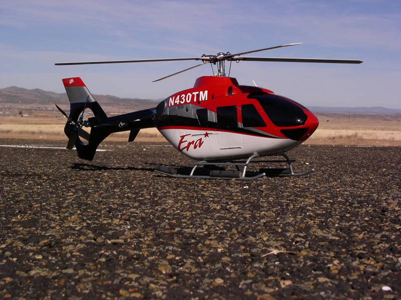

The Align fuses will make a darn nice scaler with a little effort... [8D]

Very nice, who's head did you use? Gary.
Old 04-25-2008 | 06:47 PM
Joined: Jan 2007
Posts: 287
From: Prescott Valley, AZ
Default RE: scale body
Thanks!
It's the Flying Hobby/ Lightning Heli head out of Hong Kong.

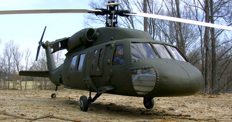

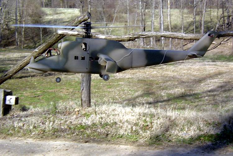

I think these are the badest looking 450 bodies yet, thern again I am being a little bias.

A little bias because they are your bodies? lol
Old 05-02-2008 | 07:00 AM
darthdrk's Avatar
Joined: Dec 2002
Posts: 1,169
From: Munford, TN
I dont think I hid anything My tag gives it away.

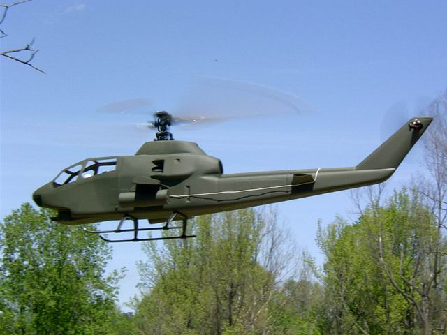

Hi my son asking about where to get a Cobro scale body for his trex 450, I was wondering if any one had tryed puting the new cobro body for Thunder Tiger 325 on a trex 450, will it work.

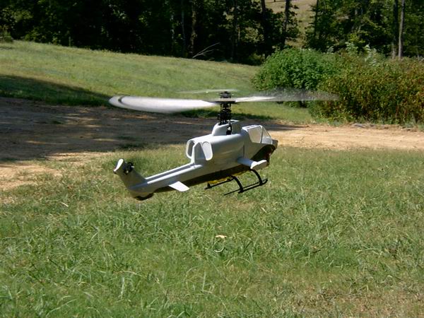

Ive read in another forum that the 325 Cobra will not fit, something about the tailboom sits about an inch higher than the T-rex.
if you do notice the MT325 Cobra isnt exactly scale.
I run an electric tailmotor in my elevated tail bodies and with this , Im limitless as to where I can place my tailrotor. When going scale, you should expect to do some mods depending on the body style youre seeking. On my elevated tail bodies, I usually remove the stock tailboom, belt and all thats associated with the taildrive and i then install an electric tailmotor to drive the tailrotor.
I do two versions of the cobra, one is the Marines version and the other is the Army version. Personally I like the Army version better (I was in the Army and served as a Helicopter repairer) My Army version is about 20-30% bigger and will accomodate all 450 size helis but for the elevated tail, I do recommend removing the tailboom and go electric tailmotor which I think would be easier than doing a mechanical elevated belt drive tailrotor. There is a mechanical elevated tail drive system available for the T-rex but I have not purchased one and I dont know much about it. I switch scale bodies so often sometimes (depends on what I feel like flying) that each helis elevated tail rotor is in a different location. The mechanical belt drive elevated tail drive unit is not a one size fits all for scale applications.

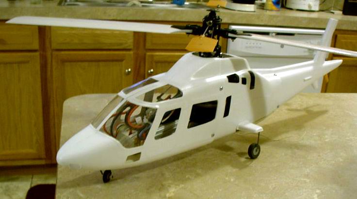

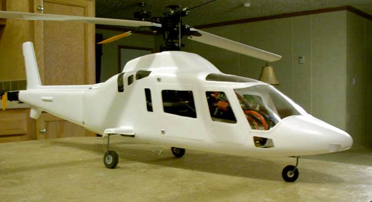

I fly all my fuselages with the most common standard setups. You dont have to use any special or bigger battery packs or any special motors to fly my bodies. The fuselages are light weight and the fly really well on most standard 450 size helis and power systems.
As far as the A109 I do have one. I just put my Belt CP inside of one. I dont do retracts on many of my models, I myself try to keep it simple basically to show a person can still have a nice looking scale heli without investing alot of time and money. The landing gear on my 109 is fixed but the nose wheel does caster to allow for ground taxing .
