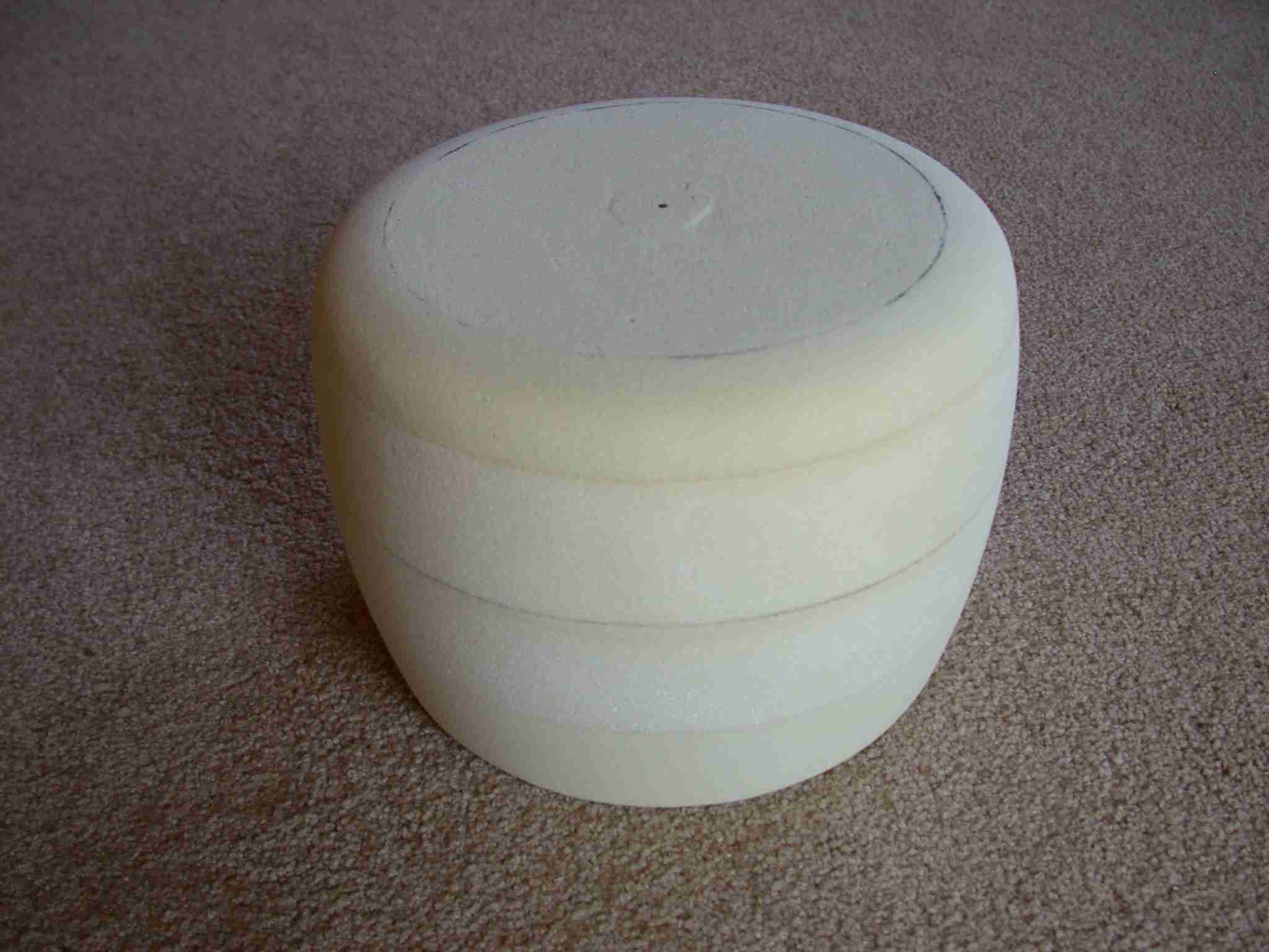

A less expensive alternative is to carve and sand a foam block to shape and cover with fiberglass and epoxy. Then you want it hollow you can cut out the foam and finally dissolve the last little bit with many solvents including gasoline.

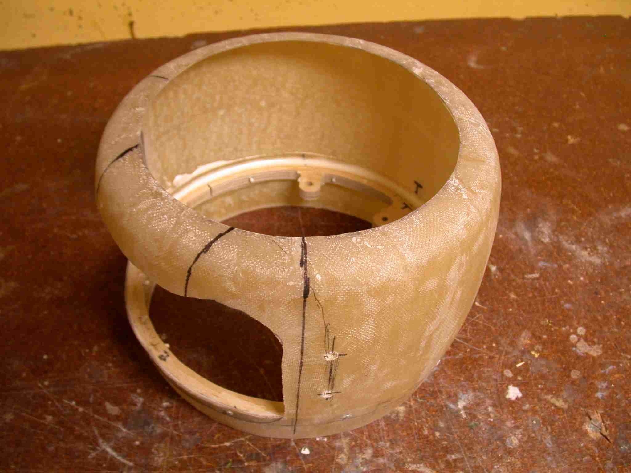

fast approach would be to turn the whole thing using a 4 " diameter to a small radius at nose,allowing a bit for trimming,then take out a 1 inch chunk in the middle about half way,slice it and paste back together and sand to smooth.In other words,the cone is sliced along twice for 2" and cut across once,with the band saw.The shape is then very close to being what you need.
Old 03-19-2016 | 06:10 PM
All Day Dan's Avatar
Joined: Dec 2002
Posts: 4,606
From: MANHATTAN BEACH, CA
Ive done several cowls using R8893's method. All came out great. Dan.

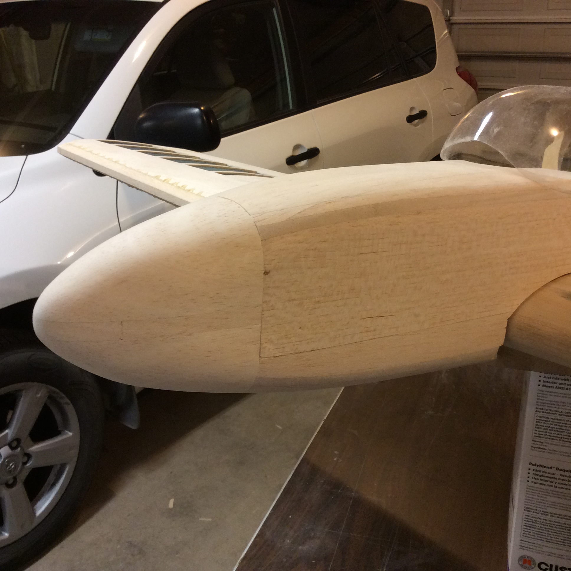

I already bought a super light balsa block from hobby lobby with a 40% off coupon and glued it up. I glued the top and side profiles on the block, cut them out on the band saw then tack glued it to the front of the fuse and sanded round. This is what I came out with so far. I still need to remove it and hollow out the inside some. Total cost of just the nose cone is $4.50. Kind of a expensive piece of wood but it is done now.

the shadow lines seem fine,so ,in my opinion,you are good to go

John, for someone that was worried about their skills you did better than most that would feel they didn't need any advice. That looks lovely.
My only suggestion is to leave the wood block a lot thicker than 1/4 inch. And in fact for durability against any nasty landings and given that many of our models often need nose weight anyway you might want to consider leaving it solid. In particular if you started with a block that was softer and lighter.
If you hollow it at all maybe it would be just to add any additional nose weight. So given all this I'd suggest that you leave the block only tacked in place for now. Finish off the model and cover the wings and tail. Place the components and check for balance. Then bust the tack glue spots and depending on any weight trim either just glue the block on as solid or hollow it to lighten or hollow to allow placing the lion's share of any ballast you need. THEN glue it into position permanently and cover the fuselage for a seamless look.
If you have access to the rear of the block through the nose bulkhead via the nose gear well you might also consider a small hollowed area and a plug in the plywood bulkhead to allow you to feed in and remove some lead shot as an aid for final trimming with flight testing. After all the further forward it is the less you need.

That's some good advise bMatthews. I never thought that far ahead. I am hoping for no additional ballast as my battery and servos were going to be placed last. I will leave it in place until nearly complete then.
