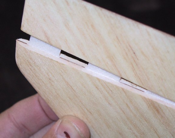

Having come from a pattern background, Ive had to re-think my hinging program for little, fast racing & electric stuff with teeny weeny stabs & surfaces. Cutting a center slot for an insert hinge & aligning the flying surface on something 1/8 - 1/4" thick stock is no fun, so...

Heres another method where the left/right balsa sheets are laminated on a 1/64" ply center section. The 1/64 has 'pockets' cut out of them spaced & sized to accept those mylar ca glue-in type hinges. After the shaping the profile, the flying surface is cut away exposing the pockets (the 1/64 is the right thicknes to accept the ca hinge). The hinges are glued in place & are perfectly centered, no messin around. The 1/64 also helps define the c/l for those oh-so important razor blade trailing edges. I like everything about this method except the extra weight so I ended up making lightening holes.

...the (stab) template for making the 1/64 ply section showing the hinge pockets. Forgot to mention, getting the outboard hinge real close to the tip edge without splitting is no longer a problem.
