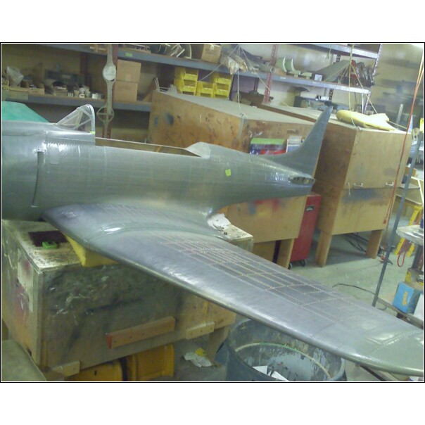

Even this is less than a CNC Lazer cutter. Not available just yet. But it will be.
