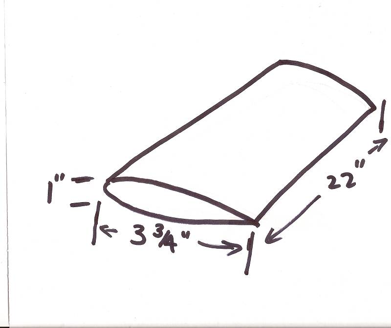

I have had a thread going for a month or two under "Big Plane Build". However I seem to have hit a snag....the aileron sevos seem to want to buzz at rest when they are in the aileron neutral position. The servos are brand new Futaba 3010 one on each aileron the links are short and straight with only a little bit of play, there is no binding on the servo horns or with the push rods and they both sit in a Slec aileron servo tray and well secured. The ailerons are vennered foam.
ANY IDEAS PLEASE[:@][:@] Here is a sketch for the aileron dimensions

Can I start with a basic question but - do they buzz when they aren't connected to the ailerons?
Second question - do both buzz or does just one?
Third question - are they on independent channels or a y-lead?
Fourth question - if you move the aileron with your hand can you make either on stop buzzing?
Fifith question - is it a 'buzz' or a 'BUZZ'?

1.no they only buzz when connected to ailerons
2. They both buzz but if you waggle the TX stick they will come to a point and sometimes syop buzzing
3. Independent channels 1 and 6
4. Yes
5. It is still a buzz thats the problem. There is no servo twitching at all and they respond well to TX commands.
I think that is everything!!!

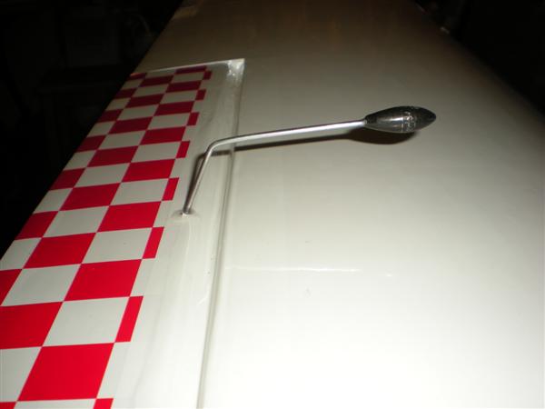

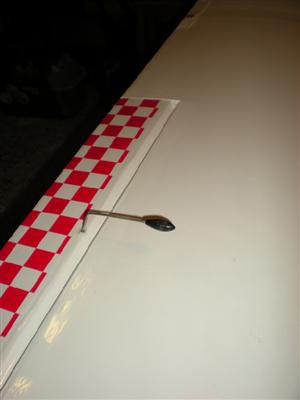

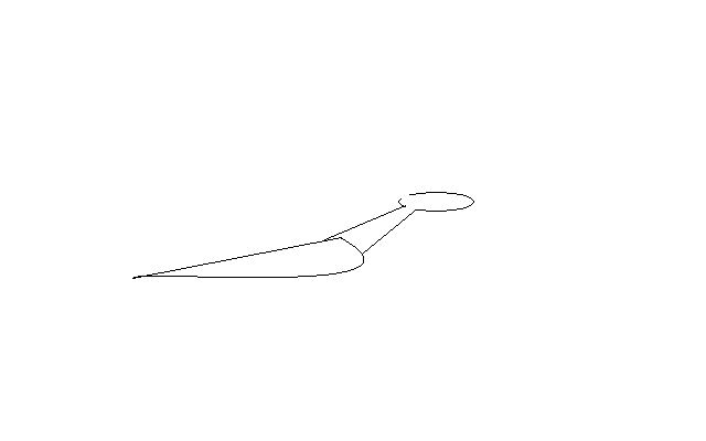

This is because you have the weight of the ailerons trying to cause them to lower. This lowering tells the servo that the mechanical position is not correct so it tries to raise them back up so this cycle repeats rapidly (the buzzing noise). If you hold the plane so the nose is up, I'll bet the buzzing stops as the ailerons will not be displaced by gravity forces. Solution, statically balance the ailerons by adding weights forward of the hinge line.

I will put on some static balancing on the ailerons and see how it goes. Better to experiment in the workshop than take a bin bag out to the flying strip!!

My Feedback: (11)
Usually, balance weights are on the underside of the wing, or on a rod that goes straight forward so that they are inside the wing. On many full-size airplanes, the hinge line is displaced a bit aft of the aileron's leading edge, and the weight is contained in the leading edge. Balance weights are mostly used for flutter control, and not to prevent the buzzing of the servo.

They look good!
You have done a great thing to prevent flutter of those surfaces.
As others have stated, buzzing due to centering is OK; however, buzzing at full deflection positions should be avoided, mainly because battery overdrain.
Long flying live for your new model!

Got the balance weights done, some pictures included, do they look alright?? The servos have stopped buzzing at nuetral,thanks everyone for the help
BTW, your original concern of the servo buzzing at neutral is normal with digital servos. I'm not familiar with the Futaba 3010, but if it is digital and buzzing a little all the time, it's doing what it's meant to do. Birds gotta fly, bees gotta buzz and so do digital servos. Lose the counterweights and go fly!
