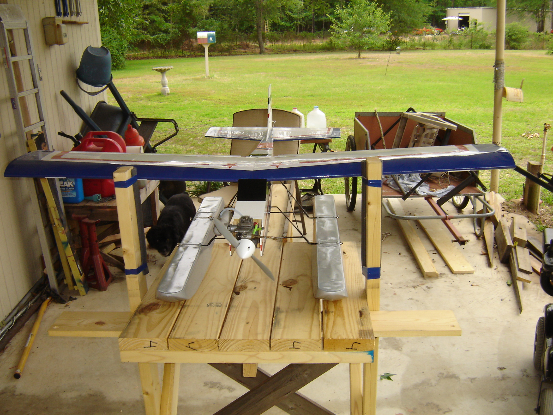

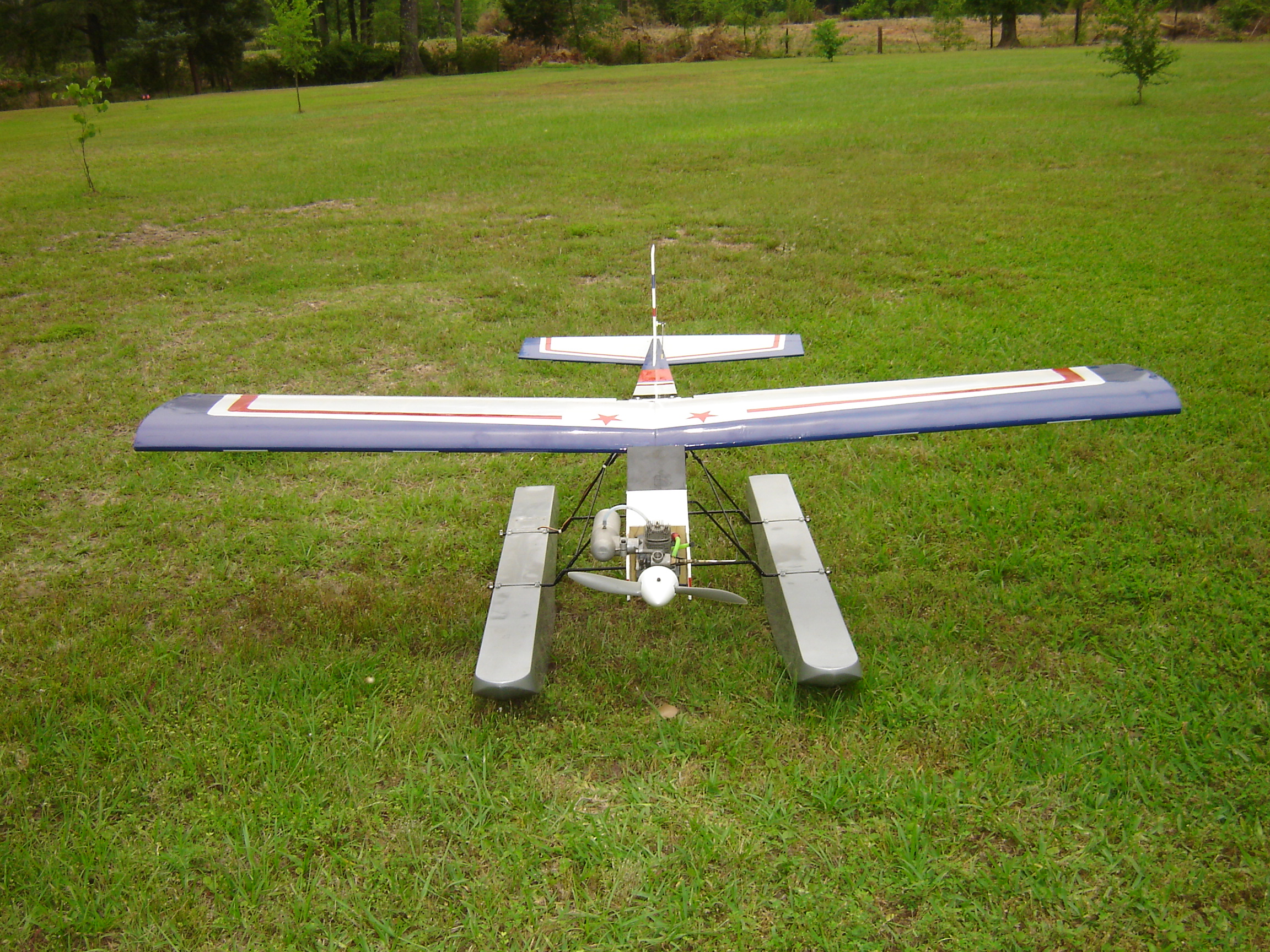

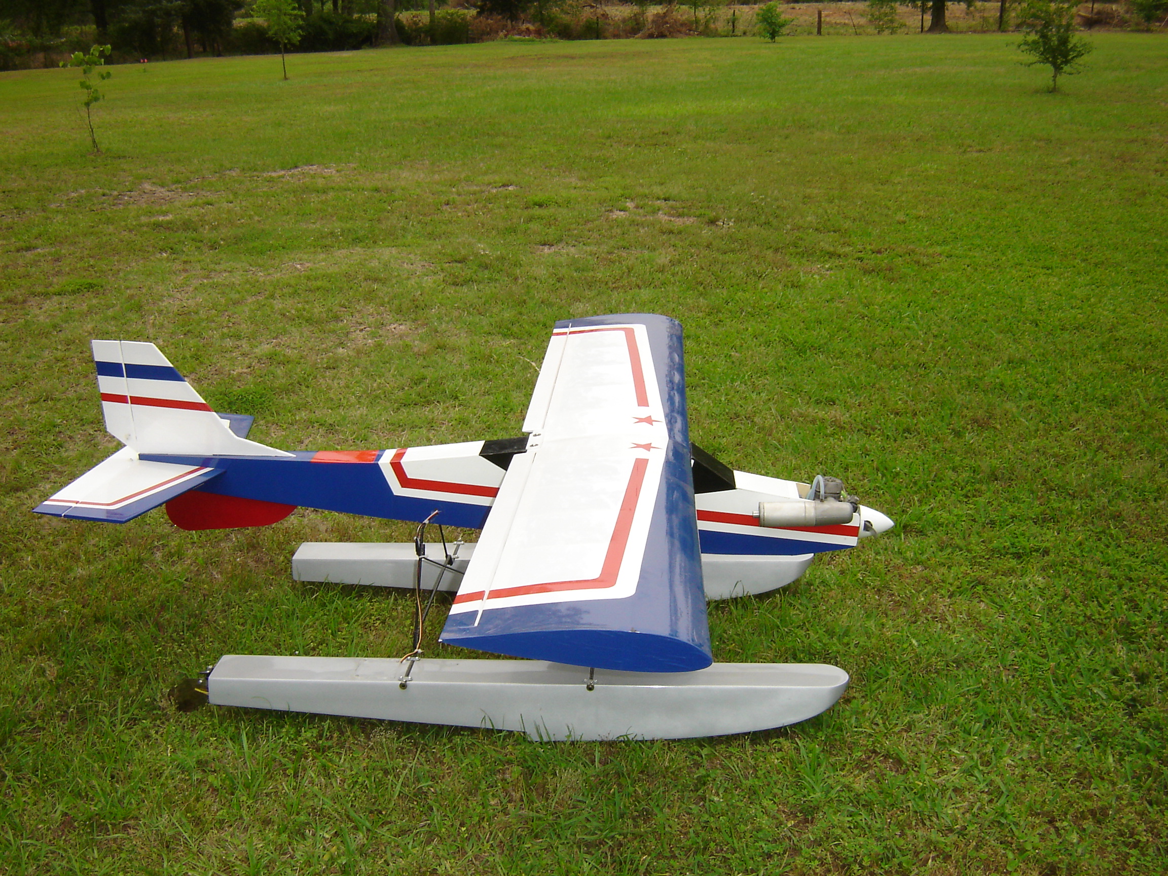

Here's a few pictures of my float plane.

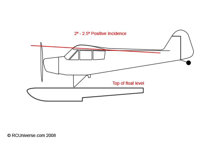

It looks like you have an incidence problem. The plane seems to be pointing nose down.
With the top of the floats level, the wing should sit with about 2 degrees of positive incidence.

That first pic looks like the floats are too far back, or is it just the angle of the picture. Your step on the floats should be about 1/2" back from the CG of the plane. The tips of the floats should be around 2" past your prop. If your floats are back to far that is why you are so tail heavy. You can get the 6 oz spray can of CX thru True Vallue Hardware stores for $9.95, my local store had to order it for me as they did not even know what it was. It is listed in there store order book under lubes and oil, I had to call CX to get TVs part #. You then need to empty the spray can into a jar. I just put a lillte hole in the lid to put the spray straw into then plug the hole when the can was empty. I have been using the same jars worth for 3 years now so it will last a long time.

Well I went to www.gettingairborne.com and looked and read about float plane setups although i did install the floats just as great plane instruction said to they were mounted wrong they were to for back and {over 4inch Behan the cg} and the wing was not level with the floats and many other problems i desided to take the flosts off and not use this plane as a float plane. but i want to thank everone the tryed to help me thanks.

Luker!
Don't quit now, you're almost there!
Everybody makes mistakes rigging his first floatplane.
I have a website to help you. It's also a sticky here.  www.smilesandwags.com/floats.html

Hey Luker, I agree with Jim, that plane looks like it should be an exellent float plane, high wing with a good amount of wing area, everything you want in a float plane.
