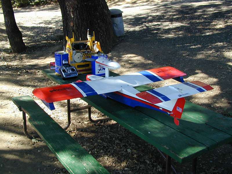

Old 12-16-2003 | 02:23 AM
My Feedback: (72)
Posts: 1,823
From: Gardnerville, NV
Default RE: Seamaster Engine
I'm using a OS 50 2 stk and my Seamaster is a rocket.
I bought a second wing so I can convert it to a twin using OS 40 engines,
It's almost finished.
I've flown the plane from water and black-top in stock form, flys great.
Old 12-16-2003 | 11:14 AM
Goinstraightup's Avatar
My Feedback: (26)
Joined: Dec 2002
Posts: 2,307
From: Baraboo , WI
Would love to see pics of your Seamaster twin Carlos
Jeff
Old 12-17-2003 | 10:25 PM
Joined: Jul 2003
Posts: 10
From: Kuala LumpurW. Persekutuan, MALAYSIA
Carlos, please show us the Seamaster twin engine version. I wanna to see how you did it.......

Old 12-19-2003 | 08:06 PM
My Feedback: (72)
Posts: 1,823
Default RE: Gonstraightup & badul:
First attempt...
Seamaster twin with OS 40 SX and Lainer wing floats.
Sorry, it didn't work...
I know how to e-mail pics, can someone post them for me?
[email protected]
Old 12-19-2003 | 10:09 PM
Posts: 763
From: Redwood City, CA
Sent you a PM Chuck
Old 12-20-2003 | 08:04 PM
Posts: 763
Here are some of Chuck's piccies....
The engines are OS 40 FSR ABC with 8oz oval tanks, plastic nacelle covers and the wing floats are from Lainer.
Edit: Added the float picture.
