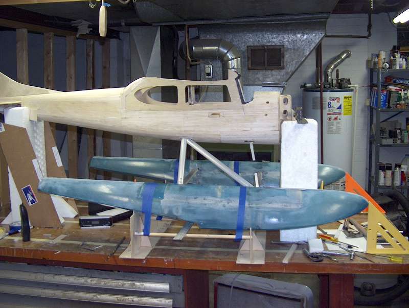

Here's a little winter project I'm working on for a friend

Another shot.
182 Cessna Skylane,96" span, Fiberglass Masters floats, Sea Commander spreader bars and struts, G38 power.

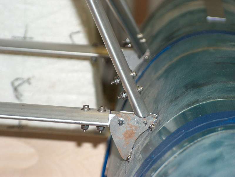

Photo of the float attachment. The Sea Commander hardware is neat.

Here's a photo of the finished mounting system.

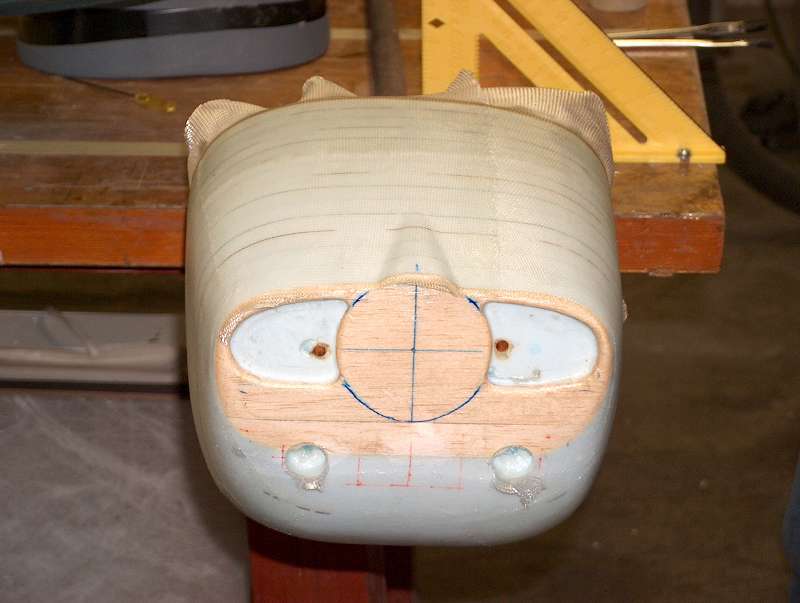

New Cowl complete with landing lights.

Engine and cowl installed finsihed off with a Truturn 2 7/8" Ultimate spinner.

Default RE: Cessna Float Plane Project
Flier,
Here are some photos of the N strut attachment. These are the front attachement points in my case, I used the tabs on the Sea Commander brackets, the 3/8 x 5/16 key stock provide in the attachment was saw cut so that it sides over the tab, I then drilled and tapped the key stock for 4-40 thread, access holes were drilled to get to the socket head screws.
Old 12-30-2004 | 09:43 PM
Posts: 1,912
Received 57 Likes on 55 Posts
From: Springdale, PA
Aother of the front attachement point
Old 12-30-2004 | 09:47 PM
Posts: 1,912
The rear attachment, the tabs were removed from the attachement brackets, both front and rear, a saw cut in the spreader bar key staock provides access for 1/16 stainless steel sheet stock.
Old 12-30-2004 | 09:50 PM
Posts: 1,912
The key stock is saw cut and slid of the stainless steel and attched with a 1/2" long 4-40 screw, this screw is hidden in the streamline tubing.
