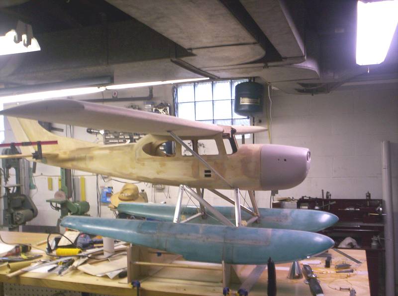

Well after a year I decided (a.k.a. ran out of my own projects) to get back on this project and will be posting photos along the way. After staring at the fuselage for over a year while building a Giles 300 and Christen Eagle, I just couldn't figure out how to make the airframe look as good as the floats so it's time for new wings and tail featherers. Here are the photos of the Giles and Eagle that took me away from the Cessna.

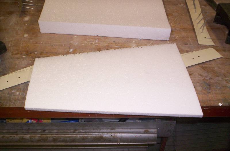

The new wings and tail will be foam cores, I'm using the NACA 0006 airfoil for the horizntal and vertical stablizers, ordinates were downloaded from the net. The cores taper to nothing at the trailing edge to provide a thin edge when sheeted.

The tail plane parts are in the vacuum bag, once the leading edges are installed, the plane will go back on the floats to set incidence. When I installed the floats earlier, I had to make some compromises since the horizontal stabilizer was not square to the rest of the plane.

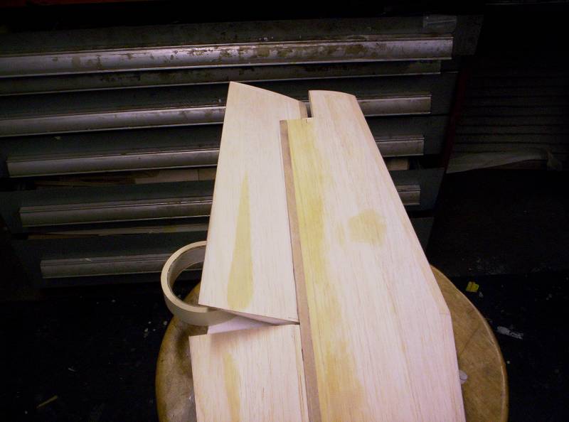

Working on finishing off the tail plane parts, the vertical stabilizer is about complete, still need to cut off the rudder. The horizontal stabilizer is little behind, making progress.

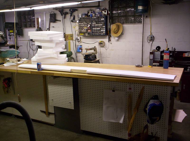

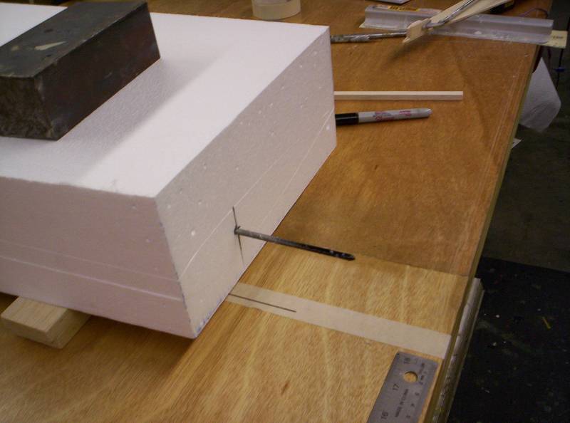

Well the new work bench is complete and time to get back to work on the Cessna. A 48"x48"X5" block of 1# virgin foam was ordered for the core, the wing platform is laid out and I cut a couple of sections tonight, I may finish the rest tommorow before Miller time. The entire wing will be skinned as one section to avoid butt joints and glass tape reinforcement. Both wing skins are glued up, that took several days of butt gluing and edge matching to get the 96"x 16" skins finished. This will be the largest one piece wing I have made , the previous wing was 72" for an Ultimate. I can see the light at the end of the tunnel.

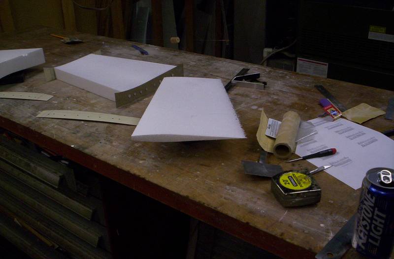

Well here's all that left of the 48"X48"x5" foam block thanks to my favorite foam cutting assistant, Debbie, my darling wife. Cores are cut and ready to be jointed. I also pierced a hole through the foam core for the servo and navigation light wiring. This was the finest block of foam I have cut to date possibly due to the time of year it was blown, May. I've purchased 1# virgin foam from the same manufacturer for many airplanes but normally in winter months, this is first time the foam was manufactured in warmer climate. Maybe I'll stock up.
The light is getting brighter, any thoughts on what I should charge Rudy for the project?

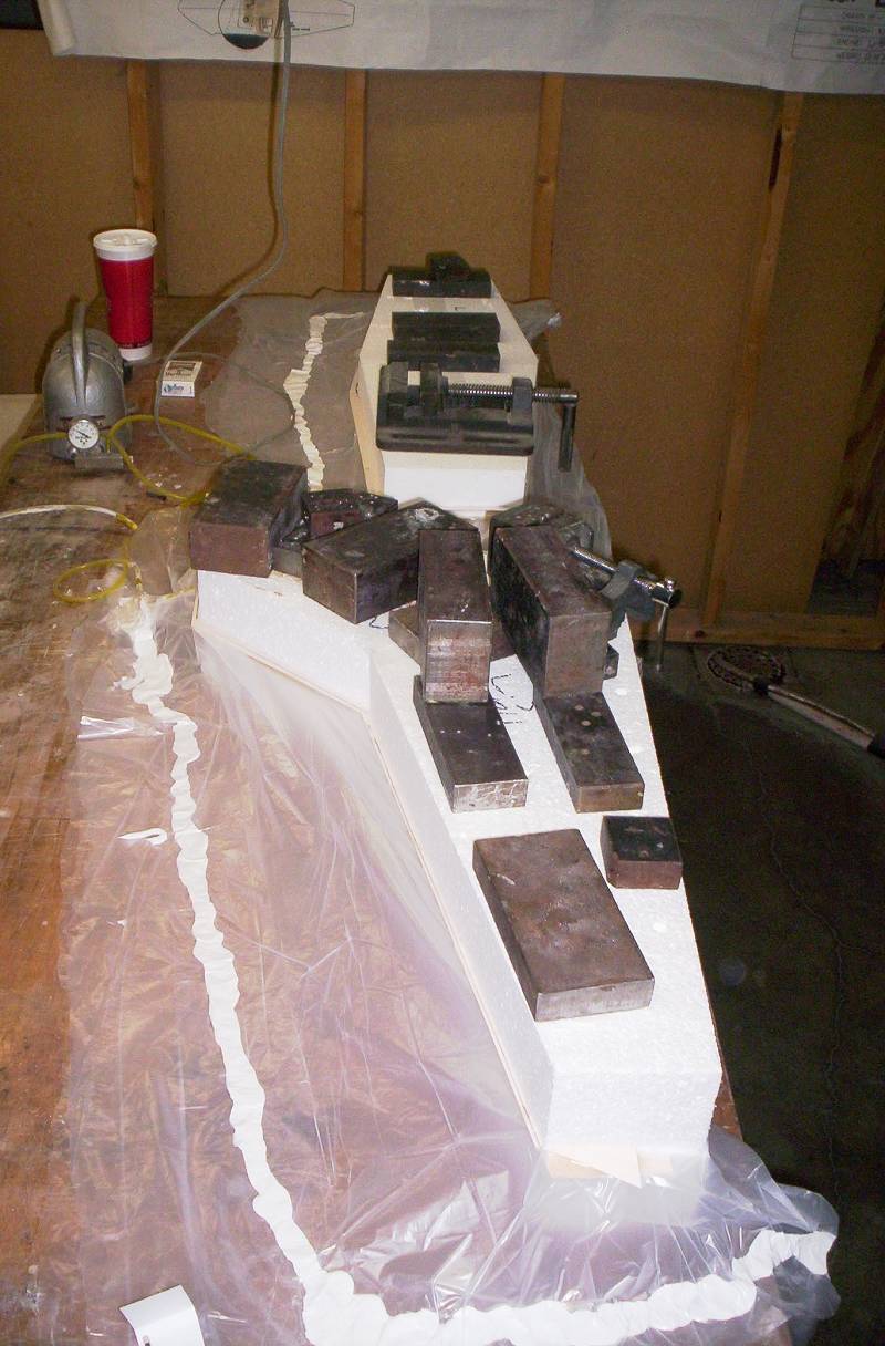

The wing skins are vacuum bagged ready for wing tips and leading edge, working on the navigation light mounting before I can glue the tips on. I used Gorilla glue for the skins, normally use Probond, Gorilla glue sets a little quicker than Probond. I was stepping and fetching this morning once the glue started foaming. Of the poly glues I've have used, Titebond works the fastest (2 hours in the bag), then Gorilla (4 hours in the bag), finally Probond (5+ hours in the bag). I couldn't find any Probond and settled on Gorilla glue, with a wing this size, I should have waited until I found Probond.
