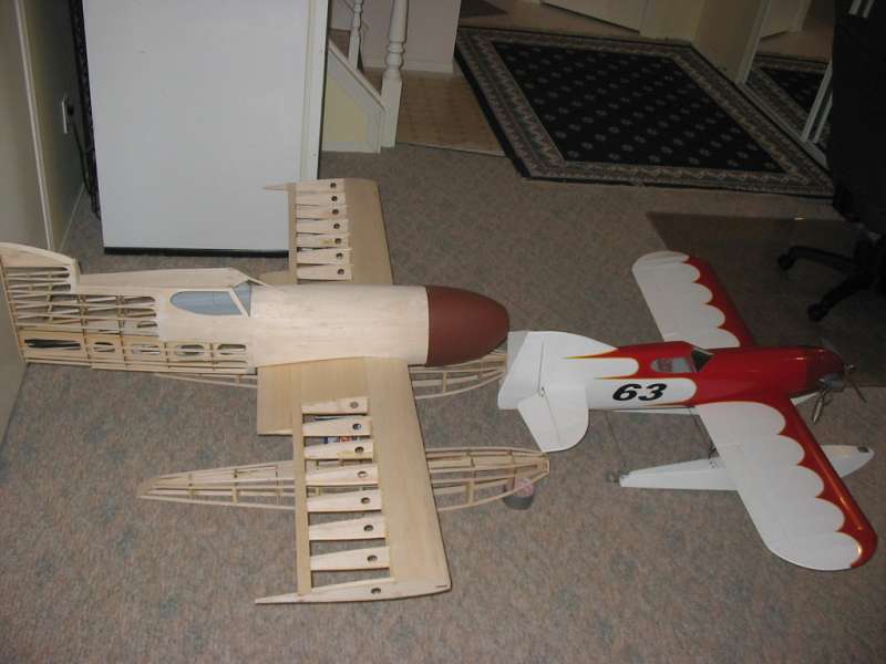

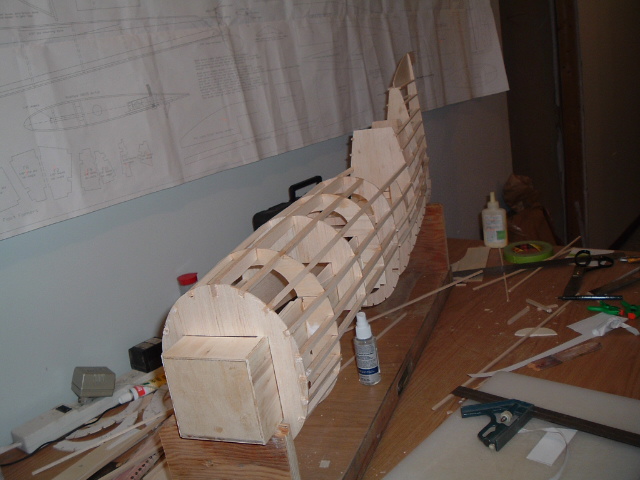

Hi all
I started building the SeaVeeBee on Dec 9th. Thought you might be interested. The plane was designed by Terry Lewis (who goes by the name of CanadaGoose on RCU). Drop by his website for a look at some real cool planes. http://www.tjlewis1.rchomepage.com/
The SeaVeeBeehas a 70"ws and is a very unique design, kind of a 30's racer look.
I'm going to power her with a 120 4C. I'm leaning heavily towards the RCV SP but may go OS. Not sure yet. We'll see what Santa brings.
Anyway, here are some pics. Hope you enjoy.

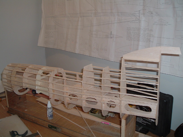

Fuse crutch with some formers and stringers going on.
[img][/img]

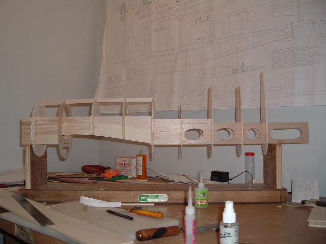

Here are some of the before mentioned fuse crutch. Sorry these are a little out of sequence.
[img][/img]

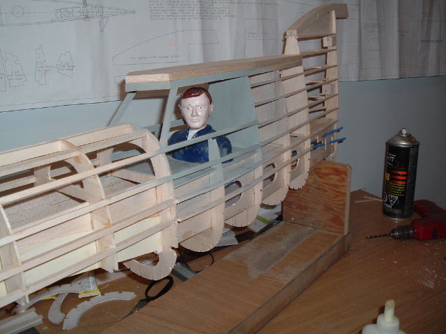

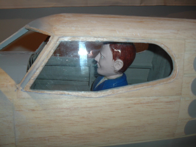

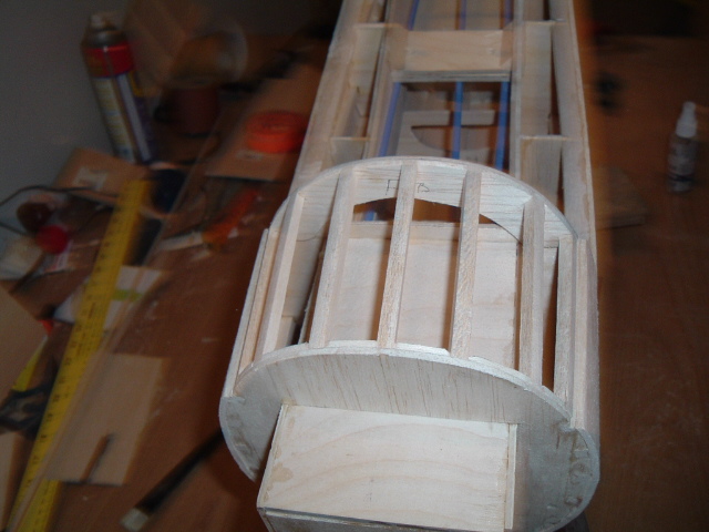

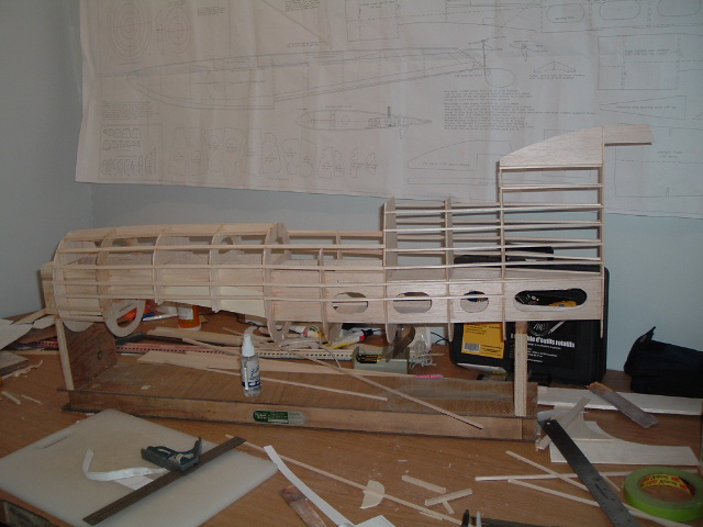

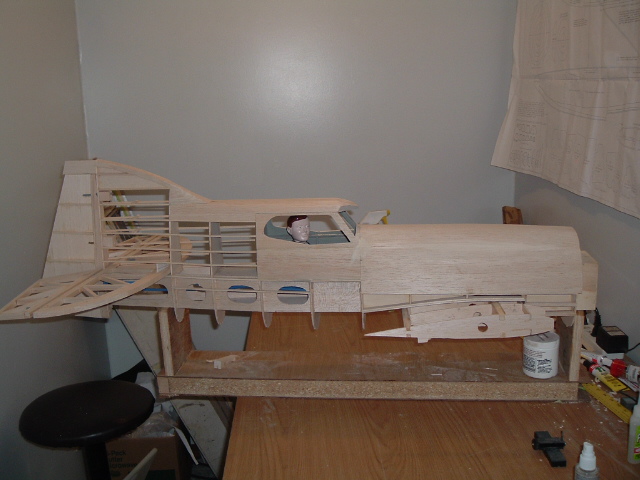

Tail going on and some cockpit shots
[img][/img]

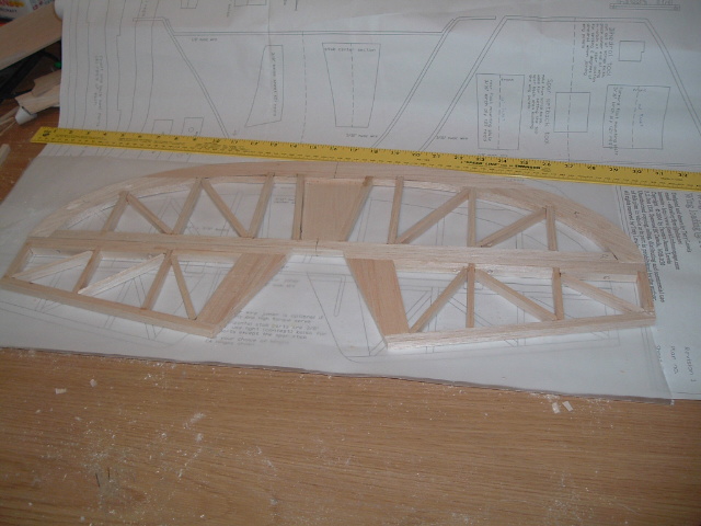

Horizontal stab
[img][/img]

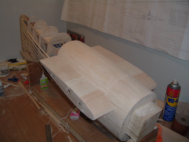

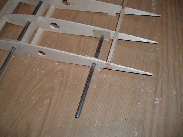

This is my first deviation from the plans. They call for a one piece wing but I opted to go with plug-in panels for easier transport and setup at the lake.
[img][/img]

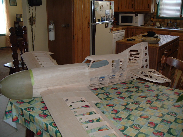

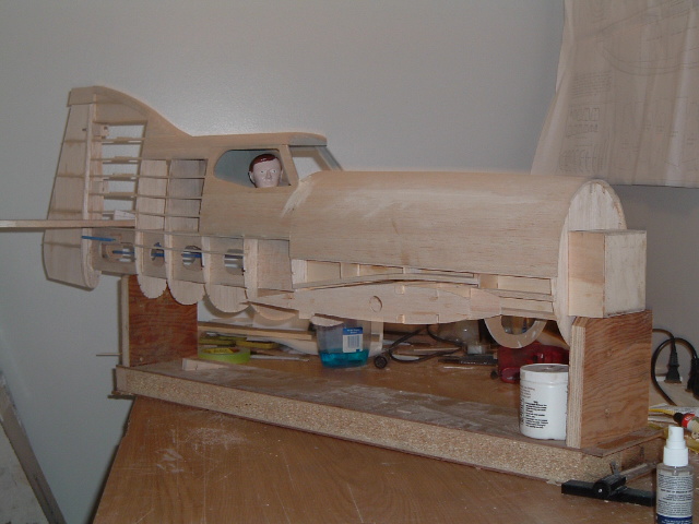

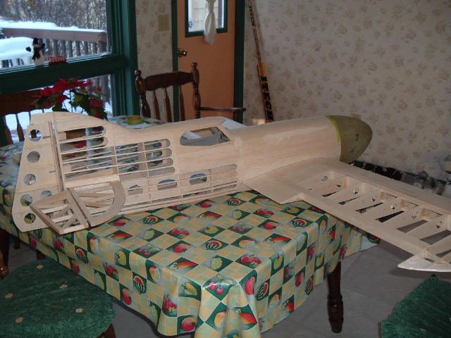

Fuse partially sheeted and center section in position. It will bolt on like a normal wing with dowels at the front and nylon bolts at the back.
[img][/img]

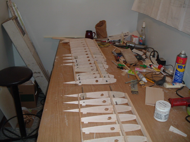

Wings framed up. Sorry but the pics aren't that good.

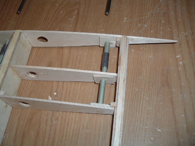

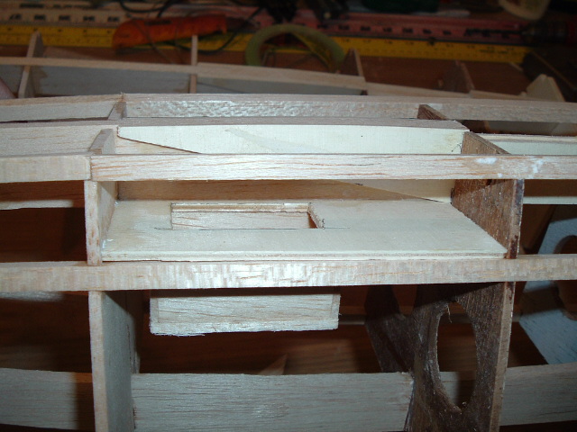

Setting up the wing plug-in hardware.

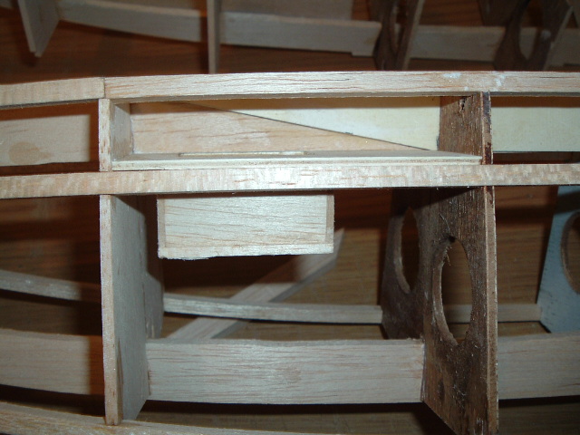

Old 12-23-2004 | 04:09 PM
Meesh's Avatar
My Feedback: (135)
Posts: 2,798
From: Dracut, MA
Default RE: SeaVeeBee project
I saw plans for one of these today on Ebay.
Sure looks nice all painted up.
Great job! Keep us posted on your progress.

Building the bottom hatches.

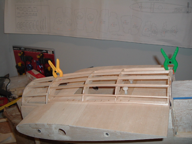

Here are the hatch frames. Will strip plank them.

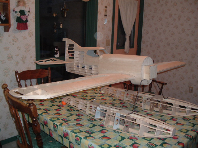

The Veebee is framed and needs ailerons built and a bit of final shaping before covering. Oh yeah, and the floats. The cowl is from Conachen Aviation. A very nice piece.

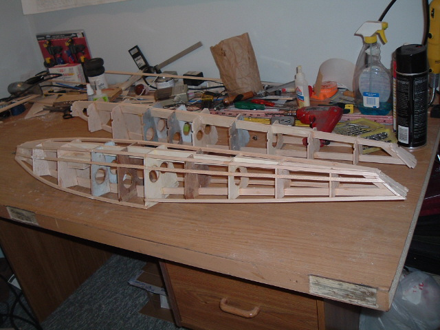

Thanks StephanP. The projected weight is about 12 lbs.
Here are the floats being framed up. The dark colored formers are wall panel board as I ran out of lite ply. I am mounting a servo in the float for the water rudder.

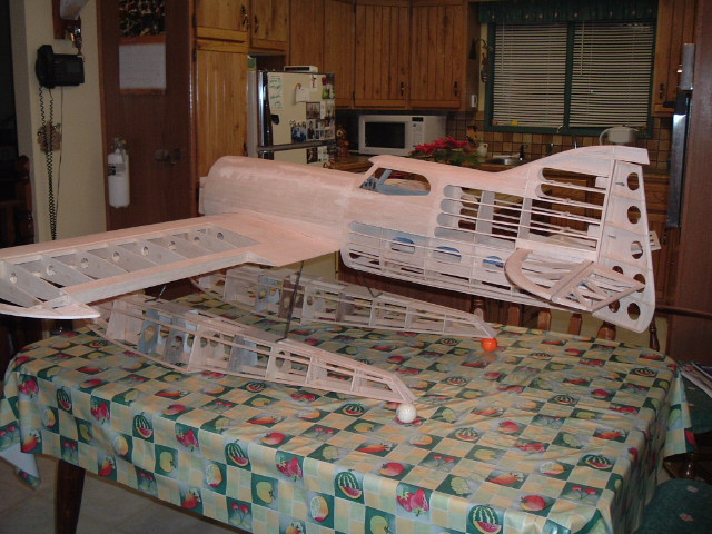

Old 01-30-2005 | 10:50 AM
Joined: Feb 2003
Posts: 108
From: Asquith, SK, CANADA

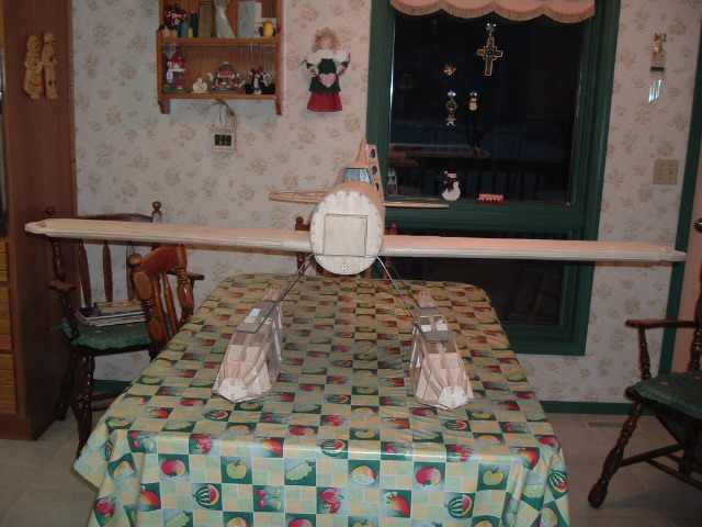

The VeeBee is now a SeaVeeBee. Just have to build the ailerons and sheet the floats then she's ready for covering.

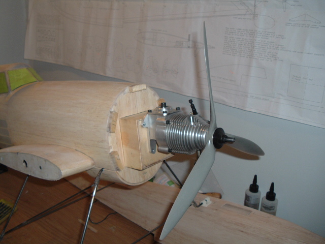

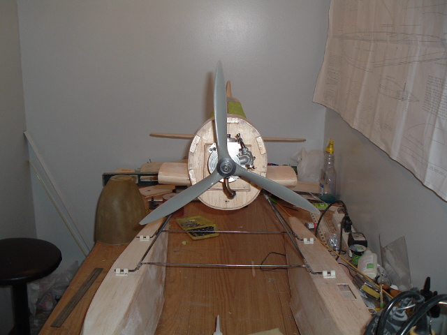

Here are a few more pics. I chose the RCV 120SP to power this bird. I think it will be a good combo.

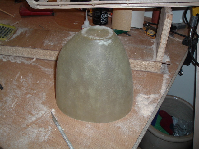

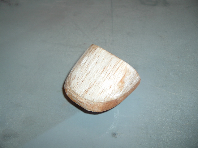

Thanks txaggie. I'm a bit behind in posting so here goes.

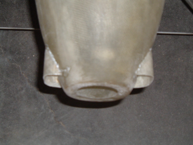

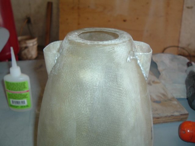

I had to make a couple of air scoops for cooling. I made a plug from balsa and waxed it with Minwax furniture wax. Next I layed on 2 layers of 2 oz cloth and finished it off with 1 layer of .75 oz cloth. I brushed on a good coat of Zpoxy and let the scoops set up overnight. They popped right off the mold and I finished them up with a bit of 220 grit paper. Next I cut the air inlet holes in the cowl and glued the scoops on with medium CA. I smoothed the joint out with a bit of fiberglass based bondo then finish sanded then primed and painted.

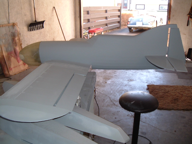

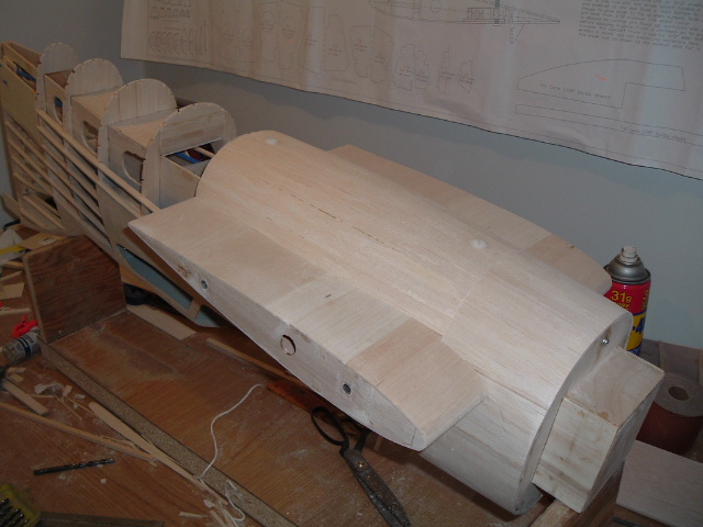

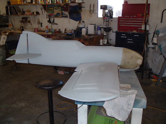

Here is the Veebee in primer. I use DuPont 30s auto primer. It fills very well.
