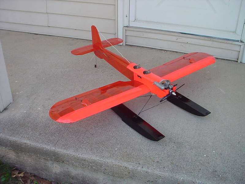

Heinkel 31 Float Plane

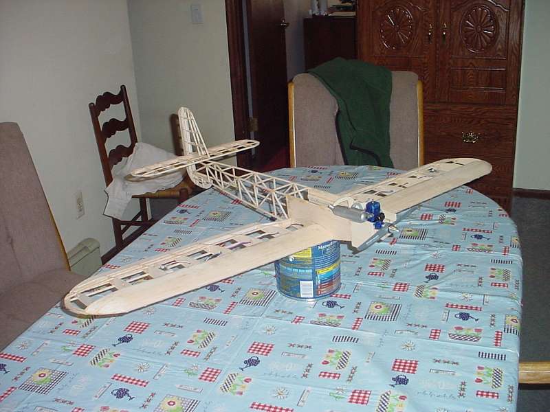

This is from Ed Westwood's plans, published in RCM, Feb 95. The 31 was the last of a series of low wing floaters designed by Ernst Heinkel in the '20s and 30s. Ed says it's easy to fly and quite aerobatic, which is why I chose to build it after having the plans for at least two years. (Didn't have all the requisite skills until recently.)
He used a geared Cobalt 035, but says you can also use a .10, so I've got it set up for my LA. If it needs more punch, a Magnum .15 fits on the same holes.
Had to use a wing jig for the wing and all tail surfaces, due to mostly symmetrical airfoils. I built wing, stab and fin in one piece, and then sawed the ailerons, elevator and rudder off. Never did that before. Kinda fun. Fuse is mostly sticks, and very tedious, but interesting to build.
Fuse is not quite completely framed up, but that and the floats should be finished next week.
Should have her done in time to test fly as the ice retreats from Lake Cadillac.

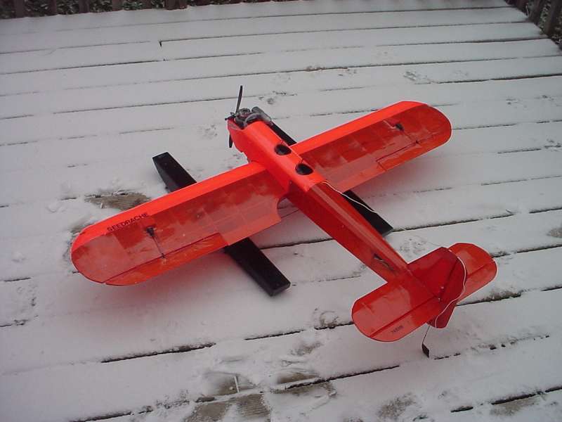

Here she is, all done and after the first flight. She's wicked fast, a real Schneider Cup contender.
The plans show the float steps behind the CG, which is how I built it, and of course it wouldn't get up on plane. Moved em about 3/4" forward and that took care of that. Then the OS 10 had about enough power to turn it into a very weird looking power boat. Out came the 10, in went the Magnum 15, and wow, does it go. Very glad I made it orange, cause it gets far away in a hurry. Water handling and the touchdown were really smooth. Next takeoff should be, too, now that I have the trims.
Can't wait to slow it down and play with it a little. Great fun flyer, as it fits in the back of my Malibu without taking it apart. It takes about 10 seconds to install 2 oz of fuel, and away we go. The Mag 15 is one of the easiest starting engines I've ever owned.

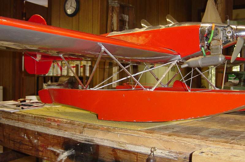

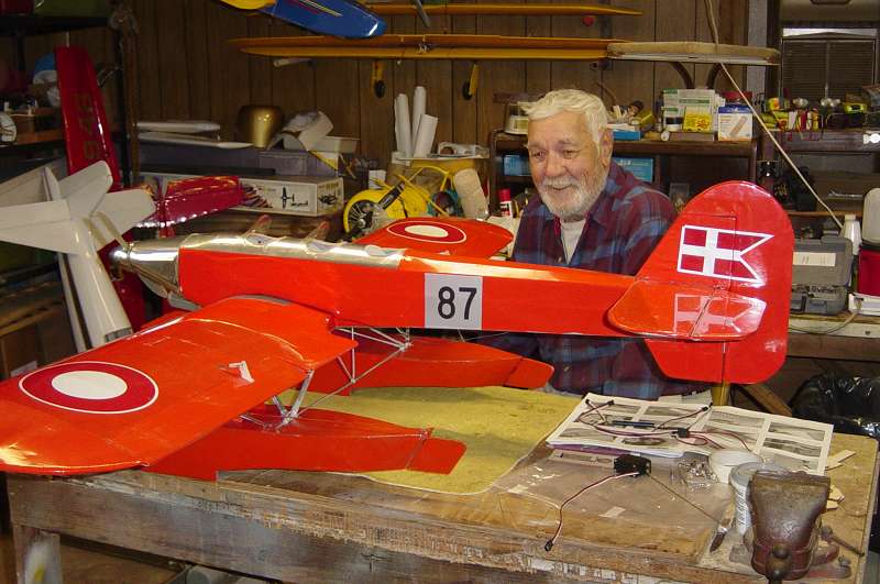

Photos of our nearly finished Danish HM II (Heinkel He-8) float plane from RCM plans.
Power: Thunder Tiger .46 Pro. A muffler extension was needed to clear the fuselage & wing.
The plane is finished in red-orange as they were painted for the 6-year, Greenland photo-mapping endeavor. The bottom is silver gray. Fire red Ultracote covering and paint was used.
The floats are scale, squared off on front, flat bottom forward of the step, wide V rear of the step. The floats are built up from balsa, covered with fiberglass cloth and polyurethane and finished with fire red (top) and silver (bottom) Ultracote paint. The struts are close to scale. The inner sections are wire, silver soldered and covered with balsa. The outer struts from the floats to the outboard section of the wing are not load bearing and are made from streamlined tubing painted silver.
We had planned on pilots and a dummy radial engine, but have found that our usual source, Williams Brothers, have retired and closed up. My buddy, who built the plane, says he will get on making dummy cylinders in the future.
Next weekend, if the winds are nice, we'll test.
WW II & Korean war Marine aviator, Carl "Flaps" Laffert in the photo is the builder.

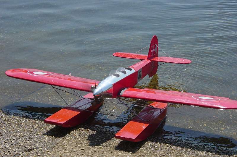

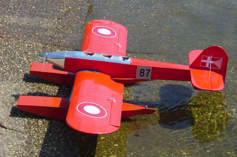

Here are some photos of the Danish HM II (Heinkel He-8) on test flight day. Flew just fine. Water handling is excellent.
Could use more power. It flies scalish, more like a sport plane, but without a lot of vertical. I think all the scale struts add a lot of drag so I need a bigger engine to compensate. Right now we have a TT .46Pro in it, but I have an older OS .61SF that I can use. I am going to leave it just like it is until after we go to the Winchester, TN, float meet on June 4th.
