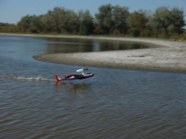

Default seamaster
i like draging the tail in the water without actually landing

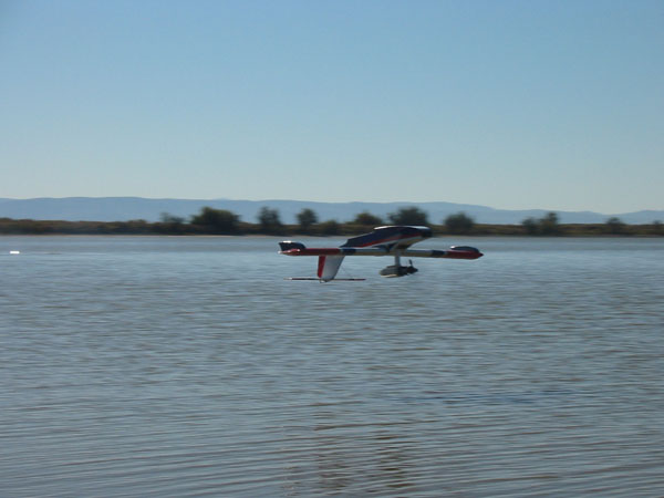

Default seamaster
landing

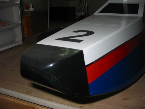

Default nose
i used a balsa block for the nose cone. i'll never fly it off land so i dont need the use of the nose wheel

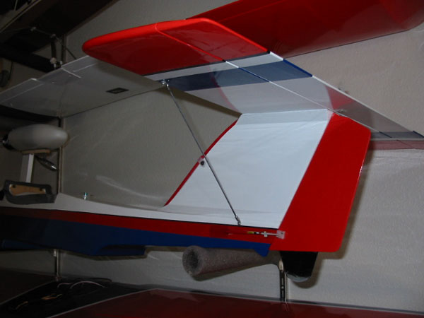

Default fly wires
i put fly wires on the tail for more strength. i fly my seamaster like its an extra300
i use an aluminum water rudder too.

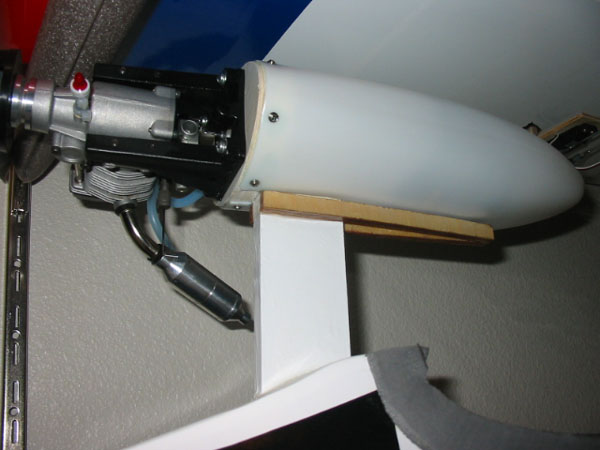

Default carry handle
I also attached a carring handle under the engine pod. Its just natural to pick up the seamaster by the engine pod. So this mod keeps from pulling the plastic pod off the wood post.

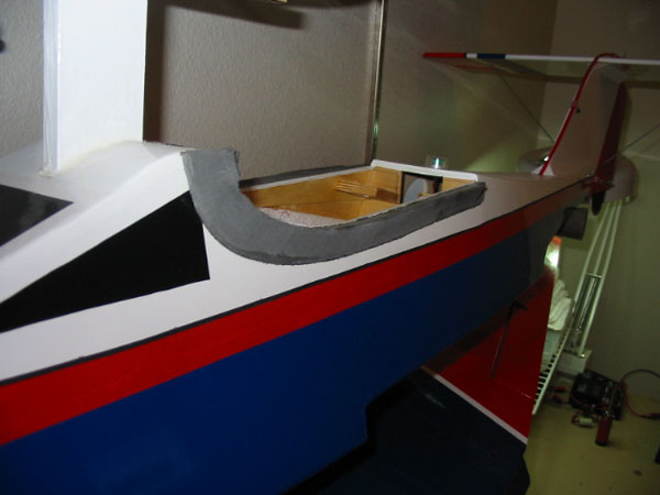

Default wing saddle
I put foam on the wing saddle to keep the water out.
It works pretty darn good.
