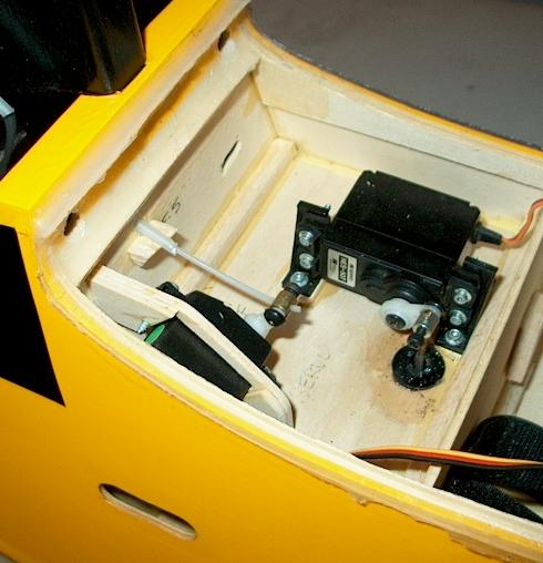

OK here are a few for you.
This is a shot of the servo setup & tank loaction. I'll try and add a bitmap drawing at the end for those interested in this setup.

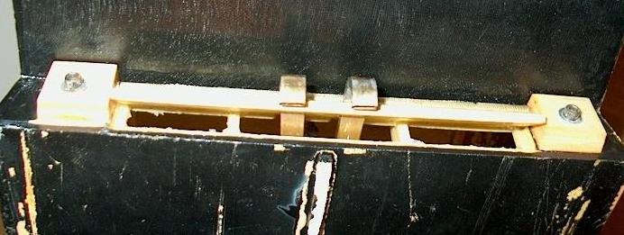

Old 12-19-2002 | 07:02 PM
Posts: 145
From: Brentwood Bay, BC, CANADA
Default Seamaster Water Bomber
This is the door in the closed position. As you can see the pickup tubes are now below the step so water can be picked up as you skim the surface. It is amazing how fast the tank starts to overflow out the vent holes (in the side of the fuse.) Alternately you can also come off the step and just open the door for a second or two and close it. Your tank will now be 2/3rds full and will fill up as you accelerate for takeoff. (This was the reason for the YS-91 ) It comes out with a 60 sized 2 stroke with little trouble.
This is a lot of fun and adds another demension to float flying. Couple that with the Seamasters very forgiving attributes and you have a great platform to enjoy the water.

scale_4_me_only
It holds approx. 16 ozs of water when full.
When flying I can tell that the tank is full but I am not doing any high G manoeuvers during this period. The "drop" is viewable but you do not get the huge water ball that you see from the real thing. On a calm day with glassy water you leave a very visible trail and I have tried to "hit" certain spots (floating logs etc) with great success.
It is a lot of fun and you will enjoy yours for sure! It is well worth the effort of the install & setup.
