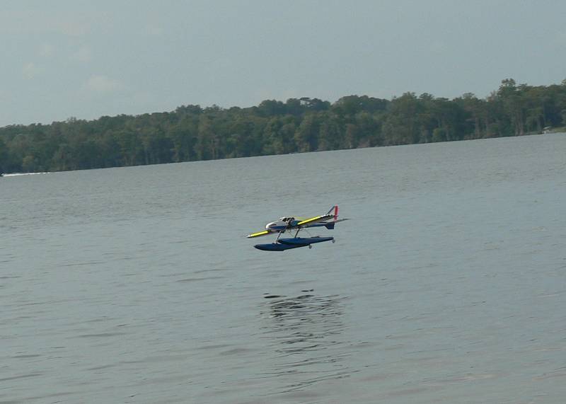

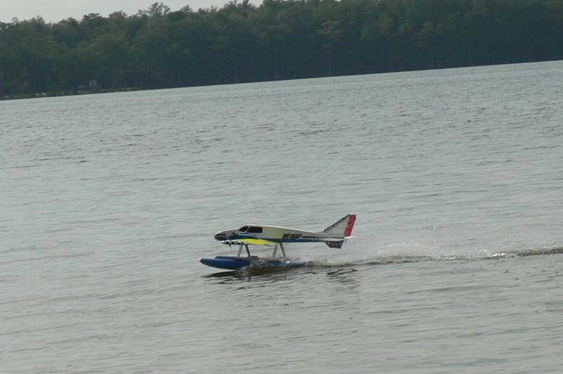

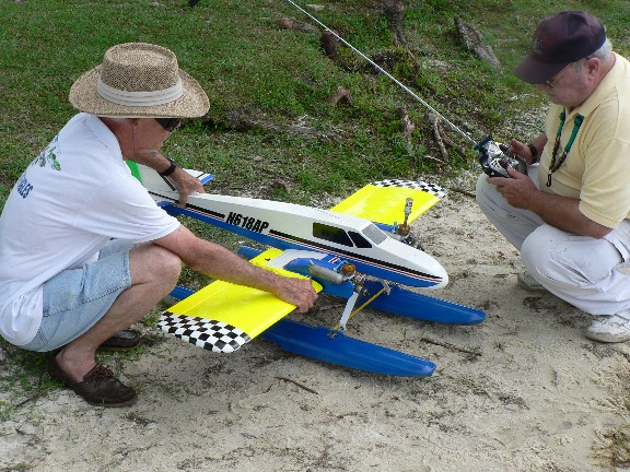

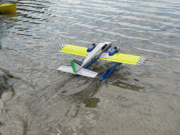

I test flew the SeaStar (TwinStar on floats) this morning at our monthly float fly. One good flight.
Airplane: Hobbico TwinStar with floats. I added a sub fin to compensate for the forward area of the floats.
Floats: Niagara, balsa sheeted foam floats. Dual Ernst water rudders using a separate servo mounted in the left float.
Engines: GMS .32, 10-6 props
Weather: Temperature in the 80s, light wind.
-Take off was straight as a string with the plane getting on the step as soon as I hit full power.
-The plane always did fly fairly well in the air. If is no different with floats although the rolls tend to barrel out. I had already changed out the ailerons for 2" aileron stock with 1/4 triangle on the leading edge. I am using 45 degrees of travel with expo.
-The GMSs are plenty of power, but aren't that reliable in a twin. One engine quit in flight after I throttled back to check how she handled at slow speed. On adding power, the left engine quit. I have 4 of them and 2 have already been replaced. I have one on a Little Stick and will trade it out and work on the one that quit.
-The landing (on one engine) was good. I was holding right rudder all the way.

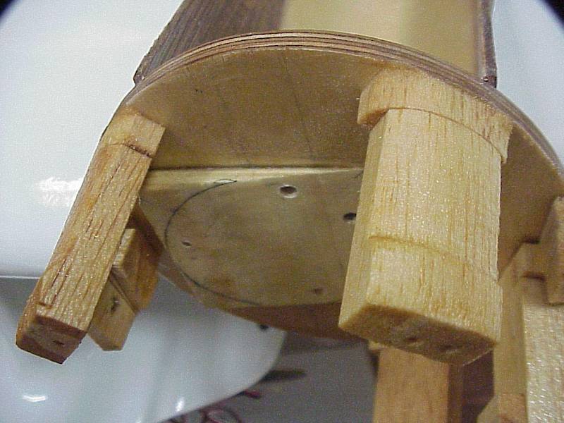

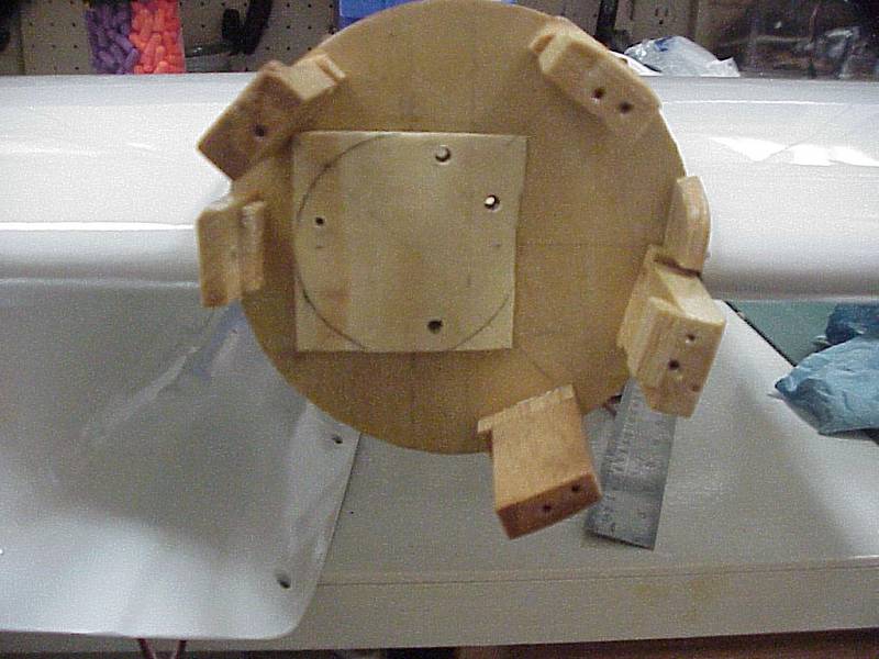

Ed - Here's a couple of pictures that I just took of my method of getting the right out thrust set up. I used lite ply and sanded the angle in then epoxied to the firewall and then inserted the blind nuts with the mounting bolts through the engine mount, etc., so the pull on the blind nuts ought to be straight. Since I haven't flown the plane yet, I'll make sure to keep an eye on the nuts since you mentioned your problem. By the way, I am using Dave Brown engine mounts.
