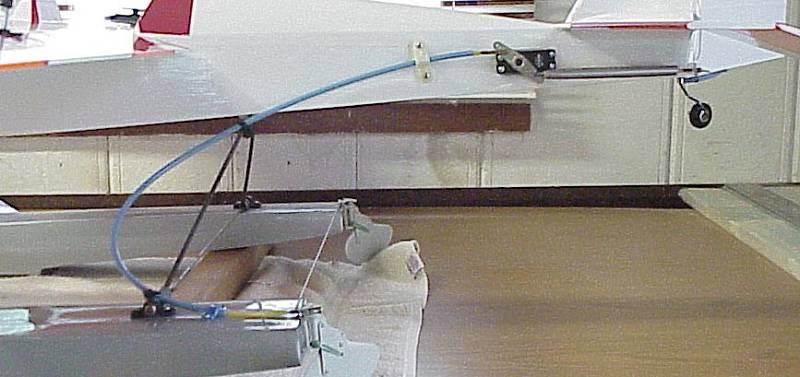

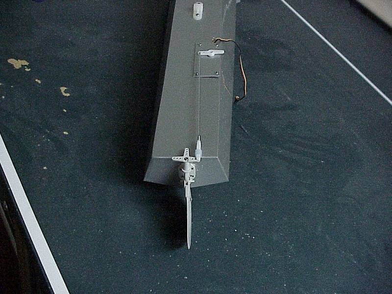

Here's a couple of photos of two ways that I have dealt with the water rudder issue. One is in the float - and I have never used a 'waterproof' servo and never had a problem - and the other is using an externally mounted servo on the fuselage and this is connected to the 'air' rudder via a control rod and also - when the plane is on floats - to the water rudder via a Sullivan Gold 'N Rod. Both have worked very well for me.

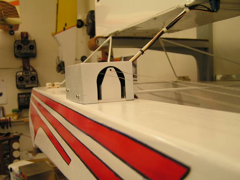

Here's the set-up I'm currently using. This one works very well. Tried burying the servos in the float, not good. These servos are HiTec "water resistant". One retract servo, one regular servo, way over powered but these were the only "water resistant" servos in the LHS at the time.

I've never had the problems that JimCasey mentions when using Gold 'N Rods with a 180 degree turn in them, perhaps due to me ensuring a smooth curve that's not a small radius. I've not had problems with the 'in the float' servo mounting method - though I will remember the balloon/glove method in the future, so thanks T_ om - and since I've never seen a full scale Extra 300XS, Dazzler, Balsa USA Stingray, etc. (like I fly) on floats I'm not too concerned about a Top Gun scale appearance.

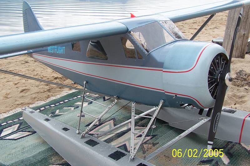

Not mine!

Here's one that was built by a friend of mine:
Going back a post or 2: 2 cables for each rudder for steering. One for retract. THe retract feature is optional as long as the WR is spring-loaded down. ANd you really only need one water rudder.
