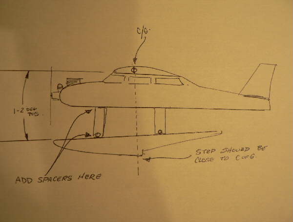

I have a 40 size trainer that has a set of GP FG floats. I have to run this thing to 40mph on the water to get it to lift off. Could it be the wing is not big enough for the extra weight. Running a 40 FX OS on it and a 10x6 prop. Boy is she fast as a hydofoil ! When I get it to lift off ie: full up elevator....well it almost does a back flip !!!! I have increase the throws on elevator to max and the floats don't have water in them. The floats are 38" long, the rudder hinge line to back of spinner plate is 46 and the step is about 2.5 inches behind leading edge and the floats extend about 6 inches past prop arc. I bought this on RCU, so the plane is a unknown so not sure where the CG should be. I don't have any trouble landing, and it will just fly real slow. The only in flight tendencies it has seems to be squirrly pitch up and pitch down. Any ideas folks ?

Floats are a bit too long. 70-75% of fuse length of 46 should be 32-34in.
However your'e stuck with them for now. Check the angle of incidence of the wing to the floats. Put top of floats level and if you have an incidence meter on the wing make sure it is 1-2deg. pos. Also make sure the floats are mounted securely. If the can act like the are independently controlled both up and down and side to side[very wobbly] this can also lead to weird take-offs. It could also be too heavy. You state step is 2.5 in. behind leading edge. not familiar with the a/plane. Step needs to be on or very close to balance point of the plane. Squirrelly in pitch[up and down]? sounds tail heavy to me. Make sure you check the balance.Just a few thoughts,

Sounds like a float wing incidence problem..As Mogman said you need 1-2 deg of pos between the wing and float... You can get this by adding spacers to your front float mount, either to the fuse or the top of the float.. As far as your float step goes, you should be close to the C/G... But if it is hard to shift the floats forward, you can still try it at 2.5 behind. I have a Norseman on floats and my step is about 2.5 in behind the C/G and its fine on take-off.. Like my drawing looks like a Caveman did it O well you get the point...

Thanks CF, drawing is good....appreciate the extra effort in doing so. Time to get the old bubble level and incidence meter out and get to work.

I believe the step to be way too far behind the CG. The step should be a maximum of 0.5" behind the CG. If you consider this for a moment, the plane is always trying to rotate around the CG, but is having a hard time doing so due to the position of the step being so far back as to act as a lever arm that, due to the force of the water at the far end of the lever, is keeping the plane from rotating. Therefore, when you are finally able to yank the plane off the water by exerting a lot of rotational force (pitch) by having a lot of up elevator, the pitch when the plane is released from the water is such that it does the backflip you describe due to the amount of elevator employed.

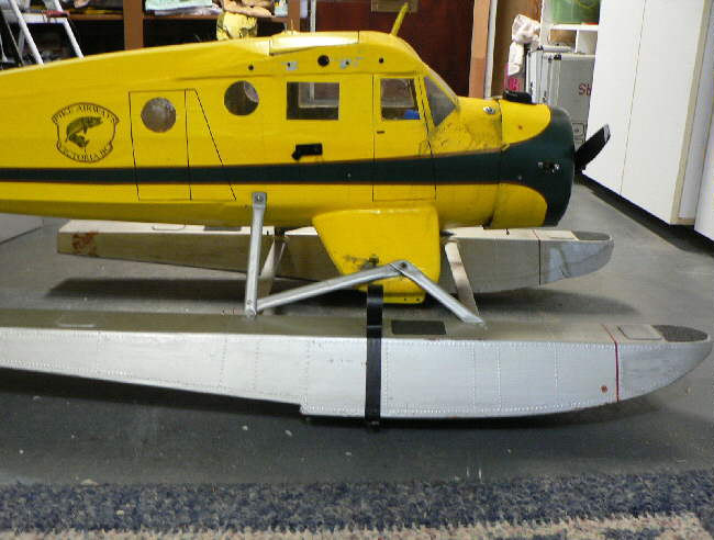

flyifr, a rough way of finding the C/G on the wing is it should be at or near the front main spar in the wing itself.. It should be close to this, but trainers are fairly forgiving so if you are close to this, it should still fly OK.. As far as that step goes, balance the plane, change or check the incidence and try it again. If it still does it then think about moving the floats forward.. In the picture you can see the black tape is the C/G of the Norseman, and my step is 2.5-3" behand it.. I installed the floats to the scale dimension and after this I realized where the step was. I thought O well I'll just try it anyways, well it took-off and flew great... I haven't changed anything since
Yes Jim is right, my picture is a Jpeg. I just took a photo of it with my digital camera, and then edited it to size...
ID:	576472   Click image for larger version

On a trainer with a hershey-bar wing, the wing chord and the MAC are the same. The wing chord is how far it is from the leading edge to the trailing edge. So on a .40-size trainer that's usually about 10". The balance point is usually at 30%. pick up the plane with your fingertips under the spar. That's usually where the Balance point should be. <Scientific content alert> The plane balances on the spar because the spar is the strong part of the wing, and that is where the lift forces act through. If they put the spar somewhere else in the wing, when the wing lifted the plane the lift forces would twist the wing and it...would...be....bad. </Scientific content alert>
So with a 10" wing, expect it to balance at 2.5 to 3 inches, and put the step of the float at 4 inches.
If you have swept or tapered wings, search out "Sparky Paul" for a graphical method that works pretty well.
I think your problem is that you need more incidence. OR something weird, like you sanded the step on your floats round. If you have flaperons, droop them a little for takeoff.

I agree with jims last post, move the step should be about 4" back from the le. and the way it may have been sanded may have placed the step further forward than it appears.
The easy solution if the floats arn't very moveable is to build the bottom of the float up to move the step back.
On my first water plane that had been sanded rounded at the step, when i finally worked out what was up i added 2 balsa triangular wedges similar to aileron stock as a sort of extra step and the problem was solved.
