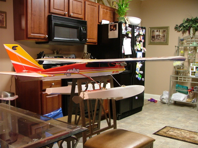

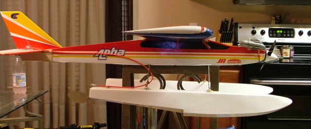

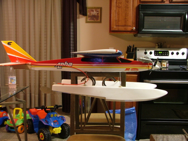

ORIGINAL: weeber24 On another note, how is the Alpha with the arrow wing? I actually had a passing thought to give it a try sometime, but thought that surely it would never work, something wouldn't seat right. Seeing that you've done it, how does it fly? I think it would be neat to get a little more performance out of the Alpha.
Sorry for taking this a little off topic, but you really peaked my interest.
this pic will show it a lil closer.

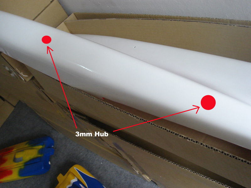

We have two 3mm thick hub on the top of the float (as the photo showed !)
So we think this is no problem to screw the the struts and spreader bar directly onto the floats. It can not broken.
Does 3mm hub is too thin ?
Anyway ,thanks for your advice. We are looking for some easy way to prove our hardware ,make it easy to fixed for piolets !

Knowing me, I probably missed the hubs on my floats. My main concern was getting the steps located in the correct position in relation to the plane's CG. I have my setup working great with your floats, so I'm a happy. It's good to see that you contribute to this forum, it shows some good support for your product and the hobby. Keep selling these floats, I may have to buy another set from you soon; this is one addictive hobby and float flying is too much fun.

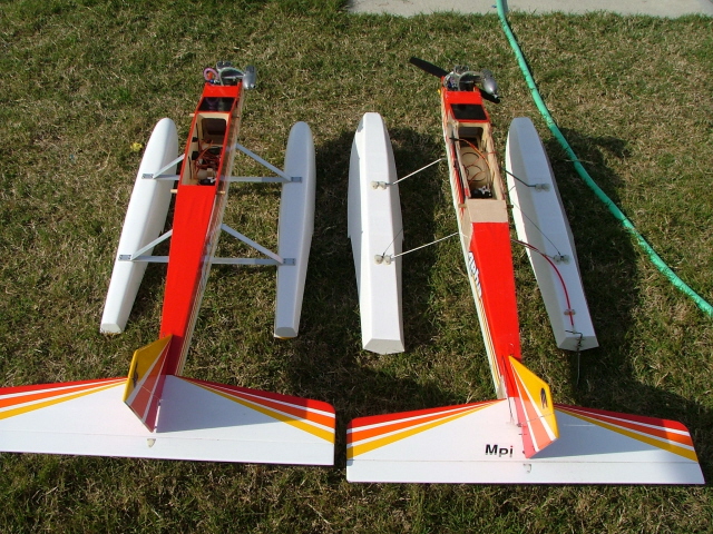

weeber24, thanks for the reply. i did install the blind nuts like you did. i flew an alpha with these floats and love em!! the durabililty was tested today and i'm pleased to say it did great. my partner and i were flying while i had the master and he had slave controller i accidently released the switch and the plane did a nose dive and came donw really hard and it just bounced back in the air and kept flying. it bent one strut slightly(bent back) and chiped gel as float flexed. no structure damage at all, just fix gel and bend strut back. it was a severe hit, if itt werethe ground it would suffered fuselage damage.
here is my plane on left with great planes floats and partners on right with 24h-hobby.
again mine on right his on left.
here is how i beefed the fuselage for the struts with blind nuts like weeber24.
these floats ROCK!!
