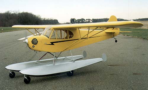

I am thinking of building the hostetler J-3 and putting his floats on it. He also offers a set of retracts for the floats. Has anyone had any experience with these.

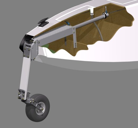

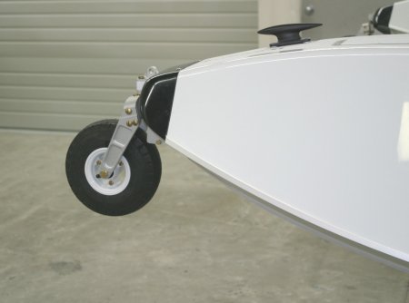

The nose gear units puzzle me a little bit. I studied a full size Piper Cub at Oskhosh (wipline floats) one year with retractable wheels. It seems the nosegear unit rotates forward approximately 90 degrees and then slides back into the float. I couldn't see the device that locked the gear down on the nose and they appear to fully caster. The steering on the plane would then the done by brakes.

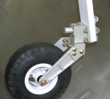

Some pictures that may or may not help you out: Front gear
