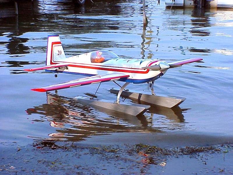

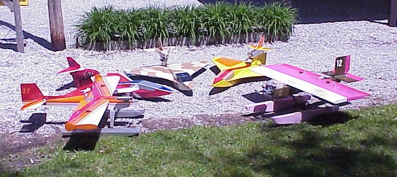

Virtually any plane can be converted to a float plane. Planes I have flown on water include multiple Balsa USA Northstars, Balsa USA Stingray, Midwest 80" Citabria and Midwest 80" Extra 300XS. All you need to do is make up some floats that are appropriate for the size of your plane. For my bigger ones the floats end up being about the same size as a .40 - .60 size fuselage!

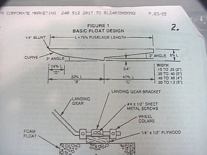

It's interesting that you posted those photos and the comment about your larger floats being about the size of a 40-60 fuse. I've been wanting to build a flying boat of my own design and have been thinking about the proper dimensions for the step and angles of the bow. I'm wondering how it would work if I built a 40 sized fuse, shaping the bottom like the bottom of a float. I think I need to put the CG at the same location that the CG would be on the set of floats. I'd also have to work out a rudder. I'm thinking I'd copy the wing from my SuperStar 40 wing, keeping the same chord so that the CG is the same location on the wing. For the first one, I think I'd copy the tail feathers and fuse length as well. Thoughts (anyone)?

Flying boats - Step goes at or slightly behind the CG.
Easiest water rudder is an air rudder that extends slightly below the water line, with a small ventral fin protecting it. Make the hull either flat bottom, or very shallow v-bottom. Hull size is dictated by the floatation you'll need.
High tail locations can help (horiz stab). T-tails are common. Low stab can be difficult to get prop wash over the elevator for the take-off run.

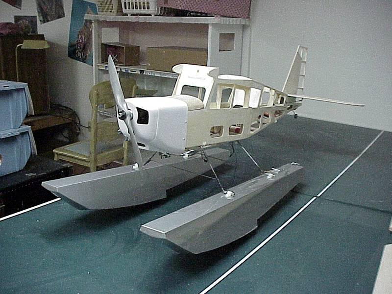

IMHO, the best choice of aircraft (particularly for someone new to seaplanes) is to go with a very conventional, low wing, sport type aircraft that has a lot of wing area, and a set of floats that are big enough, but not too big.
I don't know the weight of a G-20, but I imagine it isn't all that much more than a 120 four stroke. If that's the case, I highly recommend a Sig 4*120. You can either build the floats yourself or buy them from various suppliers.
I have a Sig 4*60 with FlyBaby floats (RCM plans) powered by a 91 FS and it is the sweetest flying, most forgiving airplane I've ever had. It is absolutely great on the water. I can also remove the floats, fold up the water rudder, and bolt the landing gear back on for grass fields. Note the mods to the tail- I added area to the vertical surface by extending it below the fuse. Essential for adding floats to an a/c not designed for them. I also took pains to keep water out of the bird- I used bellow seals on all the pushrods.
You can see a build thread on this a/c at:
http://www.rcuniverse.com/forum/m_44...tm.htm#4442961
By the way, it is not necessary to have a high mounted engine on a seaplane. A properly set up pair of floats keeps the engine high and dry. IMHO, high mounted engines are not worth the pitch trim problems associated with them.
