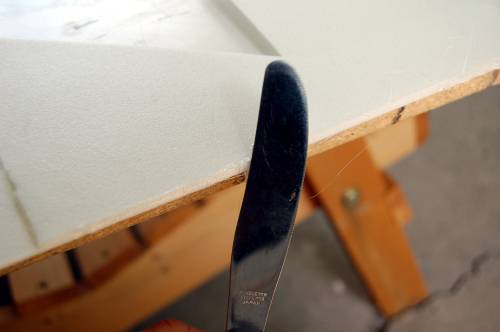

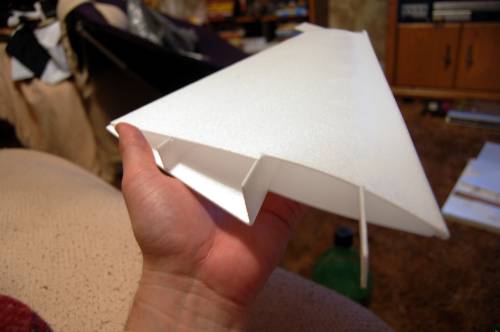

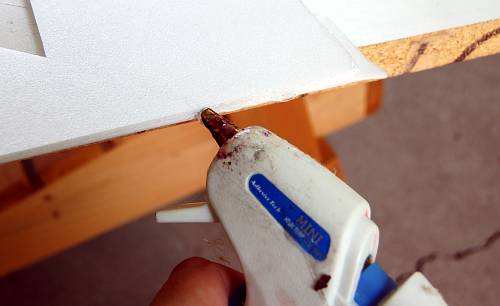

After selling my last build I needed another Twinkle. Thought I'd throw up a build log... depron's pretty fantastic for little seaplanes so many the techniques could be applied to other designs. Depron build goes a fair bit faster than the balsa build, so I'm hoping to have a flying plane in a week or so.
First step is to make the wing. Quite pleased with the technique as recommended... put the top and bottom sheets together, and hot glue along the edges. Doing a few inches at a time, while the glue is still hot, smooth the glue out with a metal edge. This will hinge the trailing and leading edges. Then after sliding in the spars, you have a fully formed wing... run some thin CA down the spars to glue them in and it's done. After the spars set, you can set up the dihedral with a jig piece and laying the wing flat on the board. In pretty quick fashion the wing is complete save the tip floats.

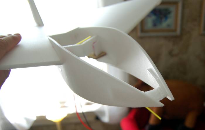

stole myself away from work this morning to quickly add the fuse sides. Slide them over the front spars, butt them up against the main spar... line up the rear fuse so it's straight, and apply CA.

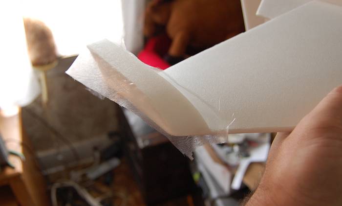

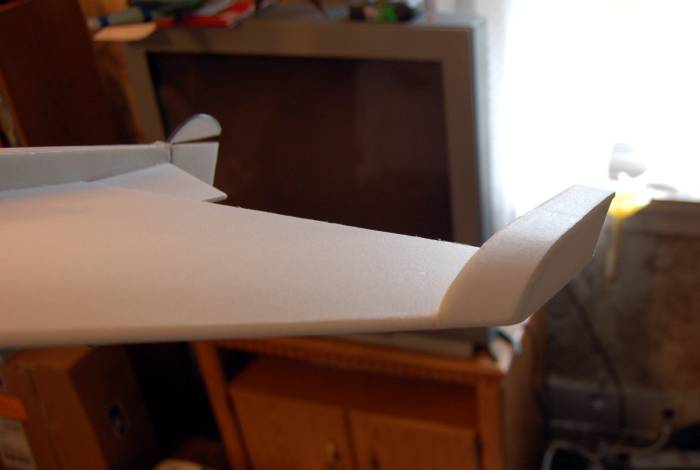

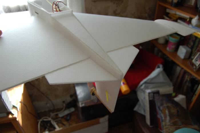

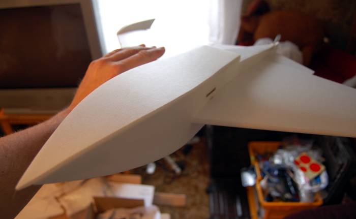

Cut out and added the tip floats, the depron versions are much more hardy than the covering over balsa of the original.
With tips done, the fuselage sides go in next to start making the torque box to hand the loads of the fin.

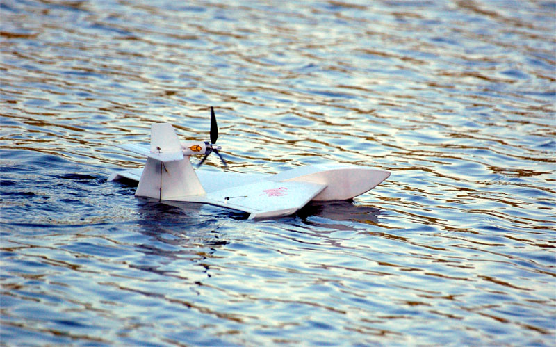

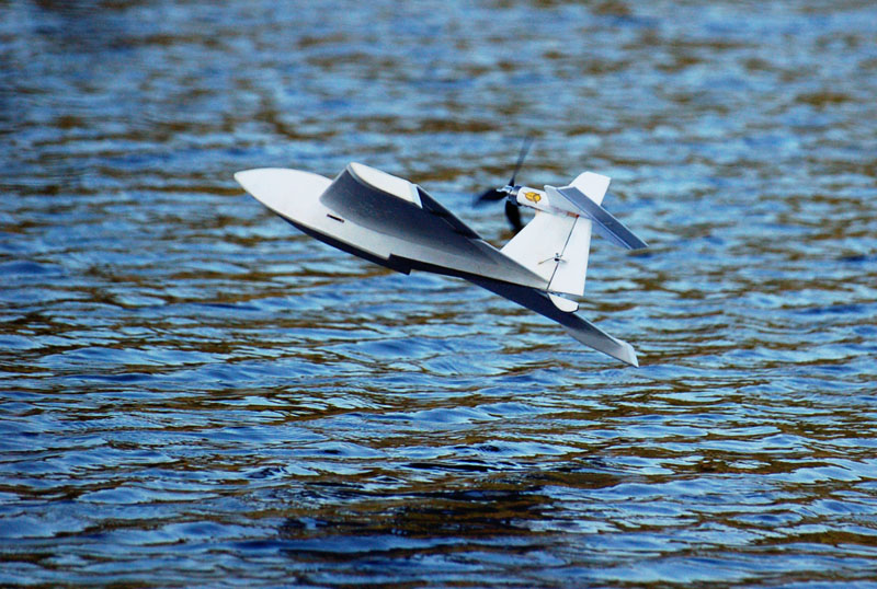

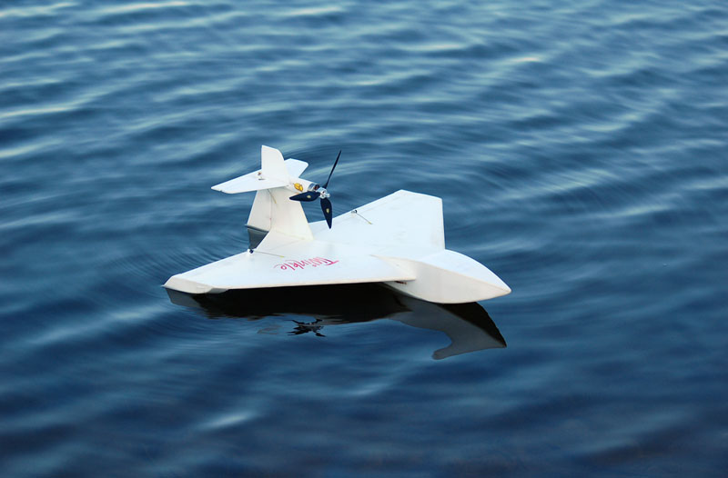

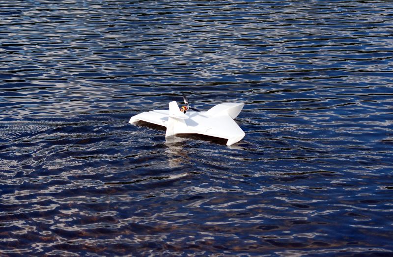

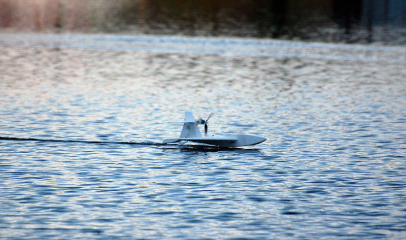

and a couple of pics of the prototype horsing around on the water just for the heck of it...

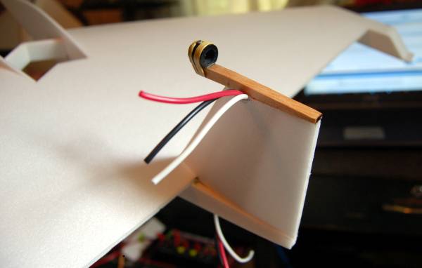

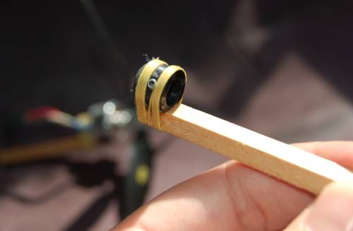

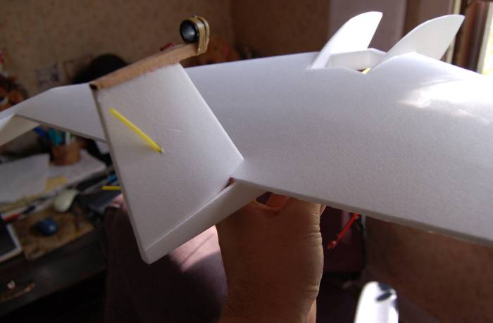

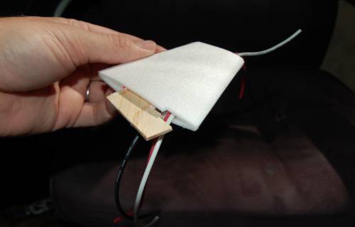

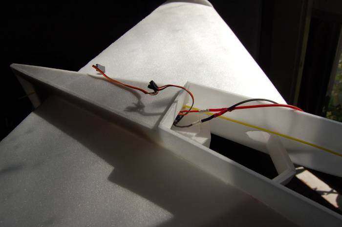

did some more fondlings at lunch time. assembled the fin in a similar technique to the wing... hinge the trailing edge with hot glue, put in the ply keel assembly (ply part off the plans with two strips of depron shaped to form the fin's airfoil) trailing edge first. Then glue the front of the keel and finally close the leading edge. Pop in some motor extension wires and you're good to go.
Cut up some spruce stock for a motor stick, and bound a ground down tube motor mount to the stick with kevlar thread. The plane is designed for the CD-ROM style outrunners, so any 8mm tube mount is the ideal (others have created firewalls for their twinkles to mount firewall mounted motors).
The last pic is the sizing up of the stick to get the prop swinging in the desired location.

Next couple of pics represent the trimming of the motor stick. The top of the fin sets the thrust line, the top of the motor stick sets the angle of attack for the stabiliser.
Glued the assembly to the back of the plane. Being as straight as possible is ideal, of course, but there's a chance to correct any straightness issues when the ply keel is reinforced in the next step. This is basically packing wood/depron around the keel bottom in the second picture. Strength also comes from the keel being glued to the bottom sheet. This all makes a nice strong toque-box to take the forces of the motor both thrust and gyroscopic.

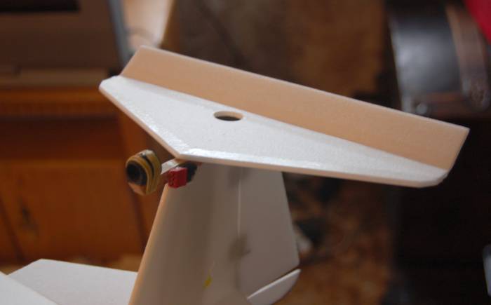

put a little more time into the build recently... here are some pics of adding the tailplane pushrods... "dorsal" wing parts inboard of the ailerons... putting the speed controller into the rear of the fuse and then sheeting over it... and bringing the nose together at the front. Another few build sessions and it should be flying.
