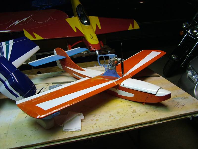

I found this little seaplane 54" span and want to know what it is and how much downthrust I should give engine?I`m using a Super Tigre 29 for power 10x6 prop.Anyone???
Thanks Ron

I believe the plane is Pond Hopper design by Ken Willard. The plans were published in RCM many years ago probably in the mid 70's. Originally it had a pusher engine configuration but the tractor version should fly well. A unique feature of this design was that Ken used a wing kit from the Falcon 56.
As to the thrust line, I would think anywhere between 0 degrees and a couple of degrees of up thrust should work. Try it and find out.
Maybe someone has a plans index for the RCM plans and can tell us which issue it was published in. I know I have the magazine but no idea which one.
Peter

A Pond Hopper,thanks Pete. I have engine set at zero degrees right now and I hope that will be a good starting fit.I don`t know where balance should be set either but was thinking maybe a 1/2" in front of float step.

I'm not sure of how the step relates to the wing but I would balance it on or near the spar. If thats 1/2" ahead of the step thats good, if not, I'd try it anyway.
Peter

I dug out my old plans for the Pondhopper and it does not give the degree of downthrust ( for a pusher). So I would think 2-3 degrees on yours should work. Mine was very forgiving with the Falcon 56 wing. There is not much frontal area to this design so wide open it is fast. Due to the front hatch being at water level I had a problem keeping the inside dry. Have fun.

I had that issue, the date is on the plan list that is still up at RCM.com . K&B .40, Falcon 56 wing and engine nacelle that was made from a plastic model of the Hindenburg that was available at the time.
