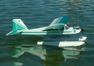

I'm building an LT40 kit with Plane Fun floats, I'm going to bolt the wing on similiar to the way a PT40 is done and I'd like to take dihedral out of wings and mount a servo for each aileron in the wings. Questions is : will this work or does anyone have any better ideas or advice. I'm going to use a MDS 48 for power.

I wouldn't mount the servos outside of the fuse if you can. It's just inviting the water into the servos. Other than that I would think it would be just fine.

I'm the guy making the Plane Fun floats. Here's a pic of my wife's LT-40 on the 34" foam floats. This was taken in March in Florida......Seaplane

All the mods you said will work fine.
CDallas' admonition about the servos in the wing is valid, but my experience is that gravity is your friend keeping the water from intruding at the servo openings. I use wing-mounted servos and water CAN get in there, it just does not seem to. That being said, the LT-40 doesn't "need" dual servos: there's no flutter problem I have ever heard of with the LT-40, and it doesn't need flaperons. Your only advantage would be more headspace in the cabin area because the ail servo would not be hanging into the cabin from the wing.
