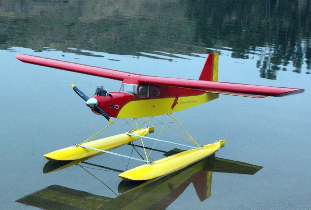

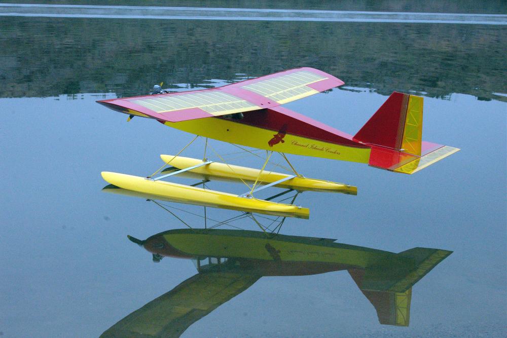

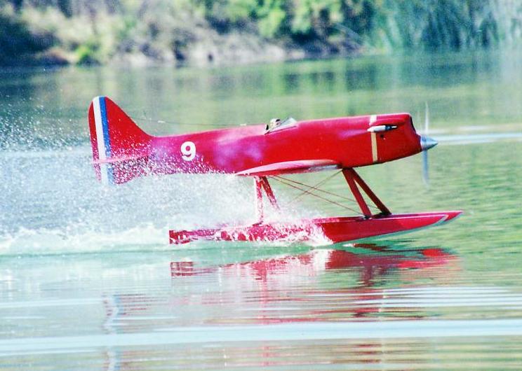

Interesting, all the difference of opinions about floats. Twenty years ago, I followed the Cunninghams instructions and never had a problem. I'v e built at least half a dozen float planes and still fly most of them once a week. It's been several years since I've read his column in Model Airplane news, but the one I kept is in the October, 1991 issue. I t told me all the basics of model float design.
ID:	1448467   Click image for larger version
ID:	1448468   Click image for larger version
ID:	1448469   Click image for larger version
ID:	1448470   Click image for larger version
ID:	1448471   Click image for larger version
ID:	1448472   Click image for larger version
