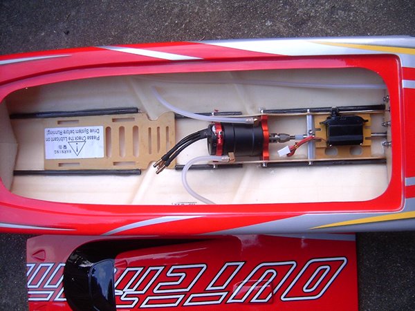

It arrived Thursday & I ran it yesterday. I thought I'd share my thoughts on it.

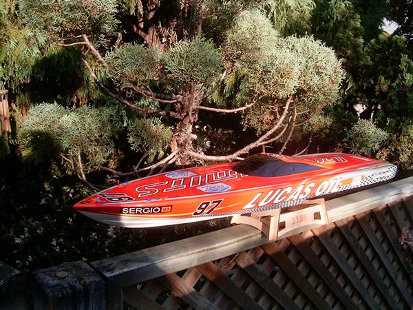

Firstly, I'd like to say that I think it's possibly the best ARR hull I've seen. Beautifully finished, solid glass work and well set up inside.
The steps obviously strengthen the bottom of the hull.
The finish is first class with the clear coat over the graphics & decals.
Unfortunately the battery tray had broken loose in transit which shows that they still use that hot glue type stuff without prepping the inside of the hull before they stick things in. The waxy film is still on the resin. So before the motor mount has a chance to break loose I scuffed the surface beside the mounts & tray, wiped it with some Acetone & epoxied in some 1/4 carbon rod.

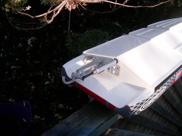

A nice feature is the adjustable T bar mount at the end of the stuffing tube. I played with that & the motor mount adjustments to produce the most freely spinning drive shaft, and guess what. I ended up at the same points as they started. Shows they are paying attention to the set up.
It has a good solid true running coupler. A big plus. Still a two part square drive though. But I don't mind that any more.
The transom has a piece of ply added & then a layer of glass has been laid over that to seal. Another plus.
The motor is one of the TFL black motors as sold by HOR Racing as the 'SSS series. I've got a couple of those motors & they are efficient powerhouses.
On this motor (3660 2075kv) I even worked up to an m445 prop & the motor was still coming in just tepid, with long run time. Stock prop is a TFL 440. Nice finish
& almost balanced. All I really did was sharpen it a little bit. Drove the boat pretty well.
But as usual with this sort of KV & this size boat, the old 440/3 performed the best
The Stinger is of good quality with nice tight fitting bushes with a 3/16 shaft to suit all your 3/16 props. The prop cone nut is held on with a set screw to a flat spot on the shaft. I have that system on a couple of boats & don't mind that.
So this one will be easy to change the flex to a welded stub flex drive. Just pull out the teflon liner & its ready.

As usual, Check the tightness of all the mounting bolts,
strengthen the motor mount & battery tray to hull join, mount your gear & go.

I've run a number of stepped monos. The turn fin is too small for tight turns, that's why the bounding and spinning. It's size is more suited to gentle, scale-like turns. As far as the angle it is mounted - yes, many/most NAVIGA boats run the fin parallel to the rudder, but that has seldom worked for me. It depends on the hull and the speed, but I mount mine on the extreme outside of the chine with at least double the area of the fin shown. Bigger is usually better...

RPMYou typed to have turn fin parallel to rudder. Ok, does this also mean the length of turn below strut will be the same, so they will work together completely in unison. Also will the turn fin be vertical or 90 degrees to transom. Now if vertical, my guess that it would work the best. Also the turn fin should be the same width as rudder. Correct me if i'm wrong!
ORIGINAL: Got RPM
The CG depends more on step placement. All my stepped boats like the CG ahead of the front step by one to three cm depending on the hull and speed.
I'll throw some numbers at you to see if it makes any sense.
The hull is actually 800mm from transom to point. There is a 75mm overhang.at the rear. In the attached pics the transom is level with the rear hatch line.
The first photo is where I was running the battery which gave me a balance point where the black lines are on the side hatch lines. That is 32%
The second photo is where the pack needs to be to have the balance point 2cm in front of the step on the keel. That's the forward black line on the side hatch lines. That works out to be 37%.
I'll make a bigger fin, angle it & play with the balance point this weekend.
The stinger is level at the moment. Should it have negative angle on it like the straight/solid shaft setups I see in Europe? Or is that not necessary with the balance point being further forward?

Stinger needs to be parallel to start with,negative will push bow down positive will bring it up,you will need to adjust the stinger to suit the conditions of the water at the time.As for cog there is no magic number each and every boat is different,power output will also come into effect also ,you will need to test and test until you find what works best.
