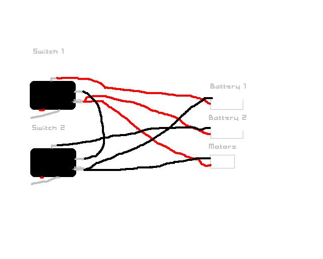

Does anyone know how to go about changing a mechanical There are two switches where the batteries are connected.
These are in order as the connectors on each switch. So the top two on both of these are also the top two on the switches.
Switch one:
- Black from battery 2
- Black goes to other switch
- Black from battery 1, Black from motors (two wires hooked up to the same connector)
Switch Two:
- Red from battery 1
- Black to the other switch
- Red from battery 2, red from motors
I need to create 14.4 volts, not 7.2 volts

Joined: Jan 2004
Posts: 2,451
From: Sneek, NETHERLANDS
Could you make a diagram and post it?
And a pic of the switches?
I can't make heads or tails of it.
What functions does the switch provide?
Forward, stop and backward?
Stop, half throttle and full throttle forward and half throttle backward?
Regards, Jan.

Joined: Jan 2004
Posts: 2,451
Hi,
What you've drawn is a series-parallel system, like I mentioned a few posts up.
You should measure (on the motor wires) 7,2V in one position and 14,4V in the other.
Are both switches depressed at the same time when the servo turns, or do they open/close, after each other.
And can you tell me wich connection is NO and wich one NC?
Regards, Jan.
Regards, Jan.

Well, I've figured out what I'm going to do, and I assume it will work. First, make a wire harness, connect red with black, then the other black and red connect them to a connector, then hook it into one of the supplys to give it the full 14.4 volts. (because the speed control works with one battery plugged in)
Joined: Jul 2004
Posts: 52
From: Rockford, MI
I got it all fixed.
It is going at a good 15.78 volts, which should be plenty for these motors. Thanks for the help! Before I sell it, I'm going to bring it to my lake to make sure it runs well, but I have no doubts now. (The lake is right accross the street.)
