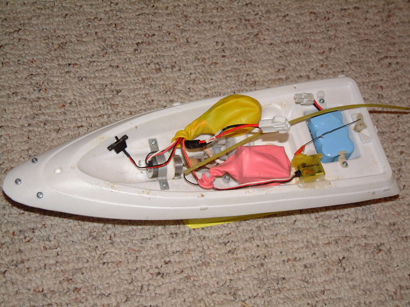

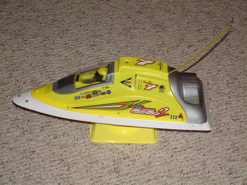

I looked all around for people who tricked out a zig zag to get Ideas, and I found nothing,
So today I dropped a 370 brushless motor CC25 speed control, and a dragonfly servo, hooked it up to my JR XS3 radio,
No test drives yet but The prop blows my hair back, with the stock battery pack, I'll post a picture

any Ideas to make this better, ? ? ?
last time I was on the water, It was being called a cerial box prize, Well I hope next time I will rooost there Nitros into submission.

Get rid of those battery connectors....actually if it were mine there would be some GP1100's in there, with actual battery bars, not tin spot-welded across the batts. Brushless motors need as much power as they can get, your batteries and connectors are it's biggest weak spot right now. Make all wires as short as they can possibly be! Resistance=more heat=less efficiency=less speed.
Good luck, let's see some vids!
Bryan

I also know from experiance that brushless motors are happiest when they are getting the current they need
I just upgraded to GP1100 and noticed a huge difference in performance from my mamba 8000 in my 18T
They heat up when they are not as efficient (eg when a pack goes dead)

Just got back from vaccation, I was hoping to have a good time with this on the lake, well, IT"S too powerfull
I did replace the battery connectors to deans
I had to 5 minute apoxy the original motor pinion to the aftermarked pinion,
I had to apoxy all the drive shaft compontents together.
the motor was getting hot,, too hot, and I even glued the shaft of the motor to the pinion,
it still got melted or torqued off,
but as for control on the boat, trimming and steering, It was great,
I would like some sugestions on my drivetrain and maybe a slower rpm motor,
the motor in there now is a E-flite Park 370 really for an airplane 3600Kv
I did get the boat to open up a little bit. but the drivetrain couldn't hold up
I really didn't see anything other than upgrades for the battery and the prop, on the website,
I might have to go to the lathe and make something for this

Get rid of the plastic pieces on the motor and prop shaft and replace the stock rubber connector with a real one, something with set screws. How many cells is your motor rated for? If you can, drop the cell count and see if that improves driveablility.
