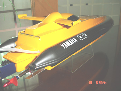

Default Star-Jet Hull by Yamaha,
Hi iam new to this forum i just bought aStar-Jet Hull by Yamaha, the hull is built from fiberglass AND designed to be run 80 miles per hour, so its totally upgradable, i bought it from a ebay auction for a verry good price what do you guys think i can do or will need to do to make this a good performer it has some pretty cool parts on it allready here are the pics please tell me what you think.

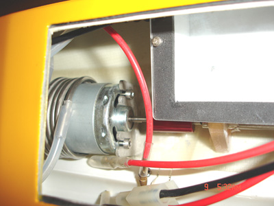

I don't know about your motor, but just by looking at your pics the best upgrade you can do right now is get rid of the micro switch and pick up a good marine esc. Me personally, I like the RC-Hydros units, but there are many great brands out there.

Not bad at all for the price, but man do they charge for shipping! For a stepped fiberglass hull, and what looks like quality hardware (rudder/bracket, trims, surface drive), it seems like it could be a nice, fun boat. With an upgraded motor and esc it looks like it might be a real screamer!

My only comment is that I'm pretty sure that this hull is NOT fiber glass regardless of what the auction says. It may have a layer of fiber glass as reinforcement to the inside of the rear compartment but I highly doubt the hull is 100% fiberglass. I am guessing ABS with some internal FG reinforcement. Still should be a fun boat once you put a real motor and ESC in it.

I've got the same ESC and it can handle pretty much whatever you throw at it (up to 60 amps). Anyway, regarding motors, you definately want to stay away from car motors as they can't handle the torque that boats require. Go to offshoreelectrics.com and look at the Graupner line of motors.

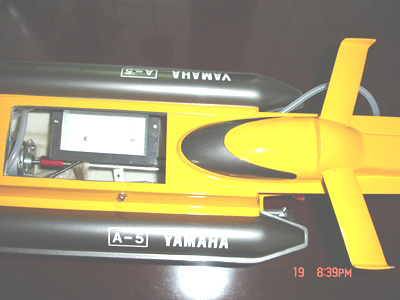

Your boat probably doesn't have enough room inside to run a big motor on lots of cells judging by the pics. Maybe put in a Speed 600bb 8.4v and run it on 7 cells. Not sure where you would put multiple battery packs so that may not be an option.

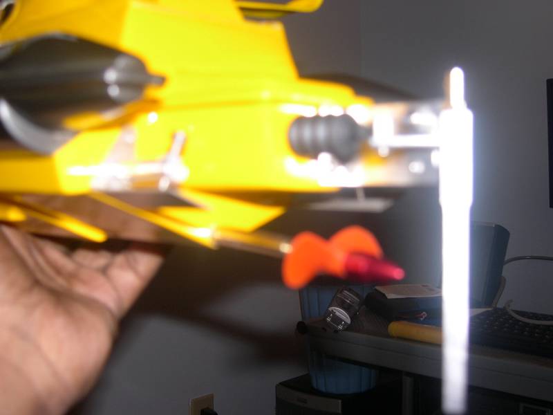

ok iam loking at the boat it says it has a Prop: D35xP1.3 will this prop be fine or is there another prop i should get? O and the prop is a kyosho brand

Hi Q,
What prop to use depends on the motor, number of cells (voltage) and how you set-up the boat.
The red Kyosho prop is not too bad, it's plastic and will flex under load.
If you have the boat running, you ca experiment with carbon props from the Graupner K-series, 34,5, 36 and 37,5mm.
These props are much stiffer and will be more efficient.
