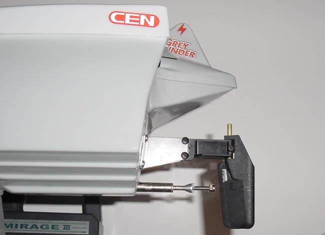

For rudders, consider the one shown in the picture below...available at offshore for $9. Of couse you could get a nice milled aluminum unit too for a whole lot more $.
Before you do any of this stuff you should strengthen the transom on the outside AND on the inside to beef up the stock paper thin ABS. Get some Otey's ABS glue at Lowes/Home Depot to bond the ABS to your transom. You can get a sheet of ABS at Lowe's, which is disguised as a NO PARKING....or BEWARE OF DOG sign. Cut it with quality sissors or use a box cutter.
