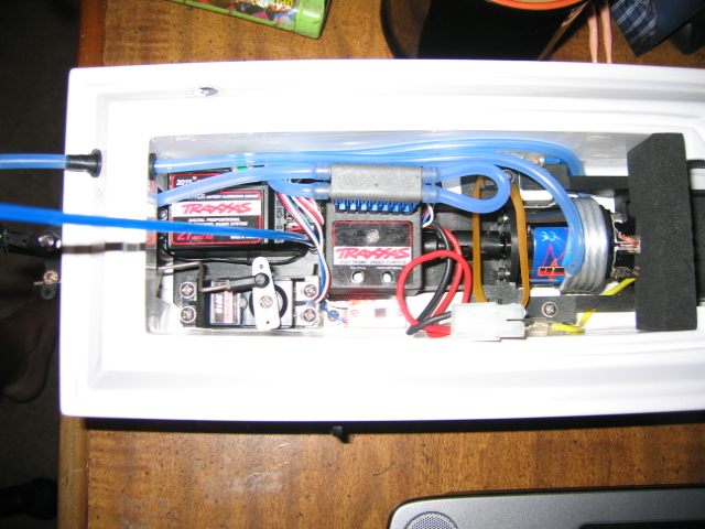

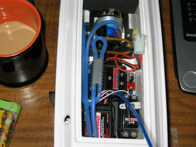

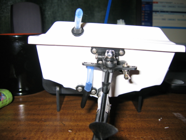

Well I set mine up like I have my villian ex . Almost level with the bottom of the hull. I also installed a water cooling kit , team orion 19x2 and also a water cooler for the speed control . I ordered one from the villian ex ... fits great . I just have to plum it now ... I'll have pics up soon . I curious to see how it runs .

yes the villian ex water cooler for the speen control , fits the stock blast esc . Im gonna finish it up this morning and I"ll take a few pics .

Here are the pics .
