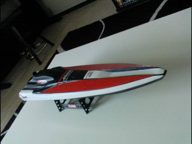

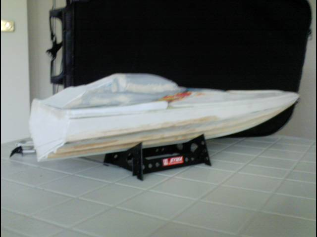

hi Master,
i'm a first-time builder facing a similar dilemma, just built myself a deep-vee hull and i have no idea what setup i should be running on it. it's made of sheet plastic, reinforced with GRP on the inside, is 86cm long and 17cm wide. First of all - will this thing go round bends without washing out? i've been comparing it to some hulls on the market, and a ratio of 1:5 (beam:length) seems to be closer to that of a sailing boat with a nice sturdy keel rather than a power boat. Doesn't weigh much - my estimates are about 400g, but need a good set of scales to verify. I basically need to kit it out with everything.....a good option i was considering was to cannibalise an RTR Graupner Giant Racer (with 3 600 motors) but would that be a bit overkill? i want it to fly..... with some imagination i might turn it into a canard (with sponsons on the side). Check out the pic and tell me what you think - took it with my phone so sorry for the quality,
Andrew

Old 05-12-2006 | 07:26 AM
Joined: May 2006
Posts: 85
From: , AUSTRALIA
Default RE: What Motor?
hi how did you make that hull and how did you reinforce it?
Old 05-12-2006 | 07:40 AM
Stokes's Avatar
Joined: May 2006
Posts: 273
From: Wellen, GERMANY
hi Speed,
i bought a couple of sheets of 3mm plastic, designed the plans myself, cut, taped, and glued everything together. i used 5 minute epoxy all along, but this needs to be reinforced from the inside with fibre-glass-cloth and some good-quality resin. i advise you to first do the seams and then cover the whole thing with two thin layers, possibly reinforcing the transom with a third layer. You might notice that the top of the boat actually came from an RC F1 car which i had won at a fun-fair...i removed the driver and blocked the hole with a piece of plastic bottle (you know the Mr. Clean spray type ones you use for the kitchen?) I made rails from strips of balsa wood which i glued and pinned into place, removing the pins once the glue set. I plan to spray the whole thing matt black, and stick on white decals of "The Punisher", with skull and all.....you think it will keep steady on corners though?
A

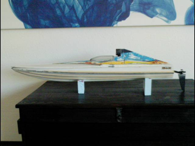

Old 05-17-2006 | 02:03 AM
Stokes's Avatar
Joined: May 2006
Posts: 273
here are the pics i promised...

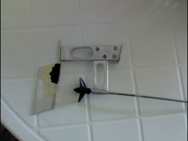

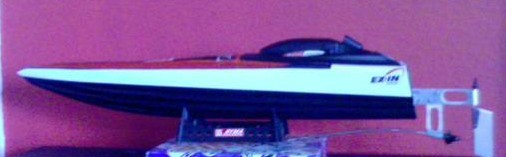

Old 05-23-2006 | 01:32 AM
Stokes's Avatar
Joined: May 2006
Posts: 273
so here it is finally...am in the process of fitting in the motor...hope the outdrive isn't sitting too low in the water....we'll see

Old 05-23-2006 | 07:52 AM
ryan_t888's Avatar
Joined: Jul 2005
Posts: 5,524
Received 6 Likes on 6 Posts
From: Hamilton, ON, CANADA
It looks way too low. What type of drive are you going for? You currently have a submerged type setup.

Old 05-23-2006 | 08:21 AM
Stokes's Avatar
Joined: May 2006
Posts: 273
Which is faster? i'll be running a 700 turbo on 10 cells with a 42mm prop - boat is about 70cm with drive and all
Old 05-23-2006 | 08:24 AM
ryan_t888's Avatar
Joined: Jul 2005
Posts: 5,524
Surface Piercing is the most effiecient
Align prop center with the bottom of the "V." Half of the prop will be out of the water and half will be in, while on plane. You may be able to get away with a 45mm or bigger prop as well.
Ryan
Old 05-23-2006 | 08:31 AM
Stokes's Avatar
Joined: May 2006
Posts: 273
You're the best....!!!! thanks a million as this should be much easier than drilling the bottom of the hull! will let you know tomorrow how it went. i was just concerned by what other members said about 'cavitating' what does this mean? isn't it better if all the prop is pushing water to propel the boat? ok this means lower revs but not sure how it works out?
