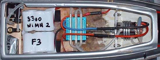

just had that same problem and am just now trying a water cooling setup for the esc, if your esc is enclosed like most its for sure gonna heat up and maybe blow, it is heating up right? mine got so hot one of the esc wires came off and the boat just up and quit!!

I've used cooling judiciously. Prop sizing though has reduced the strain on the motors. Gear boxes have also reduced the strain on the motors as well as water cooling. I haven't water cooled the escs or the batteries which appear to stay within a reasonable temperature range (not too hot to touch). I need many more runs before I can confidently conclude that the system is correct

I have to agree. I have one of these ESC's in my daughter's boat hooked up to a Graupner GTX-650 OB on 6-cells. The thing gets ridiculously hot in no time. Hot as in you can't even touch it for 1 second. I tried to jerry rig a water cooling solution on it but it does virtually nothing. I'm not a big fan of this little unit even for $39. Get a Jeti 600 Navy and be done with it.

Good idea rooski, why not take your idea to the extreme and do about 4 or 6 of those tubes and see if that helps. Or try a cooling plate.

I run the same ESC in my SWAMBC F3 Falcon with 19turn 540 motor, 6 GP 3300 sub C, Graupner 2318.29 or 2327.29, and an F2 version 12turn 540 2:1 geared, 6 IB 3800, Graupner 2330.32 both draw 30+A for 5mins. The esc was getting to 70'C before water cooling, now typically about half that, the 1/8in tubes are epoxied into slots machined through the cooling fins as it didn't fit my layout adding the pipes along the fins.
