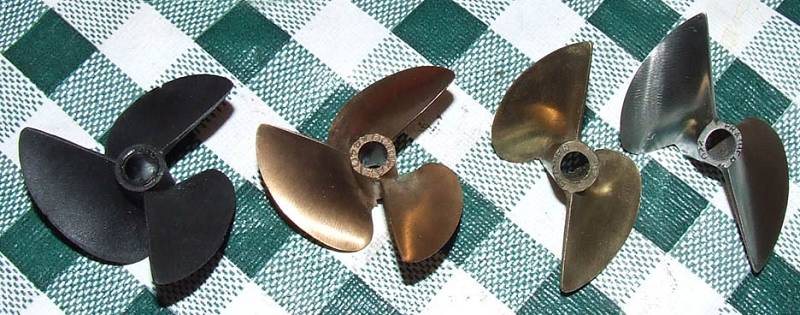

Getting ready for first run!
Stock, X440/3, p215, p220

LOL, those are EXACTLY the same props I have for testing.
ORIGINAL: MrMikeG
