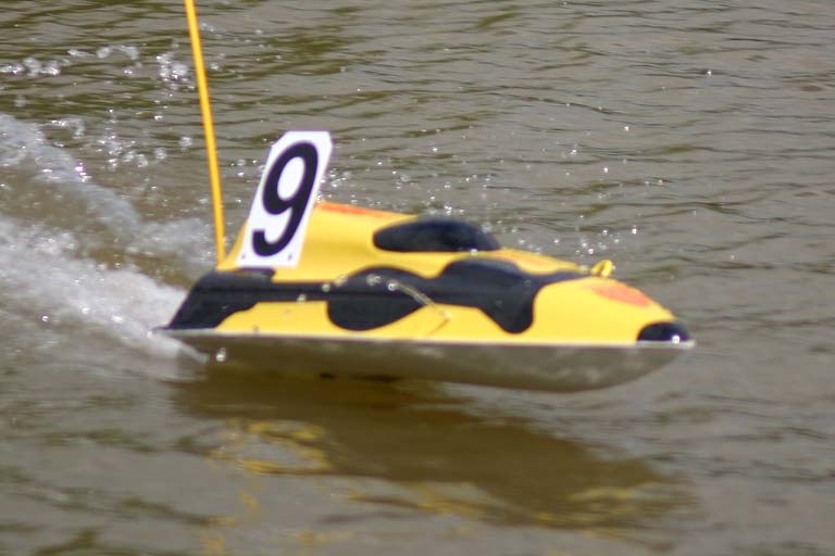

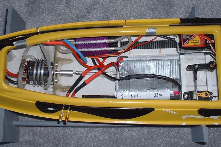

I race with the [link=http://www.swambc.webeden.co.uk/]SWAMBC[/link] in the South West of England, we have two ECO classes, this years specs were - F3 any stock 19turn single 540, 6 sub-c max 3300mAh, direct straight drive, no metal props (Graupner 2318.29 or 2327.29), 5mins, M course. F2 is a more open class for any brushed 540 motor, gearbox's, flexis, any 6 sub-c, metal props etc. Next year we will replace F2 with ECO Expert to Naviga rules.Attached are some pictures of my race winning Falcon ABS hull, known as the "Mad Cow".
More info and images are on our [link=http://web.ukonline.co.uk/alan.shipman/boats.htm]website[/link].

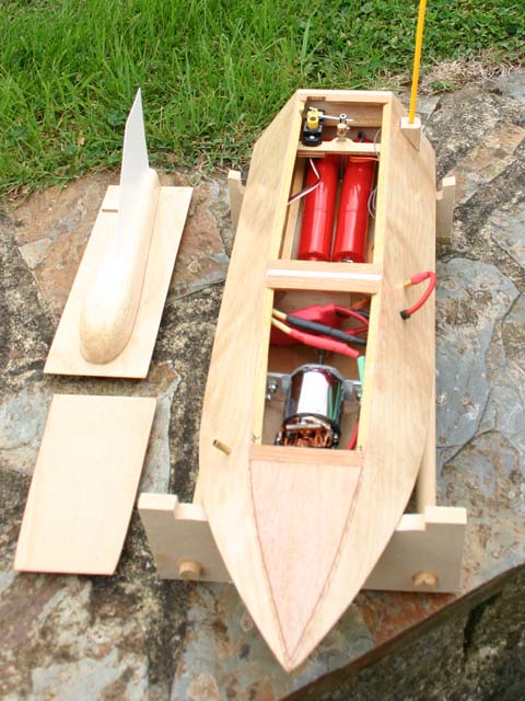

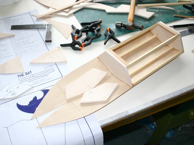

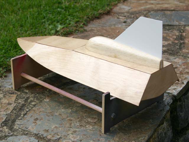

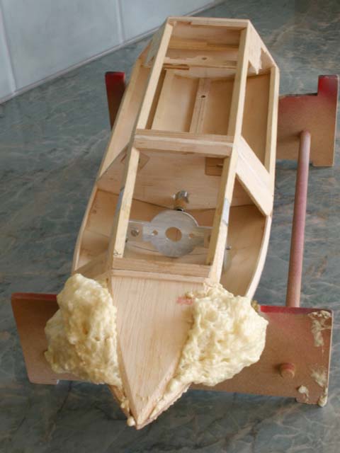

You could try the BAT plan from Traplet
https://sslrelay.com/s84068217.onean...dex.shopscript
Product catalogue - scroll down to Construction Plans - Marine - Powerboat - The Bat
We have built two so far...
Bat 1 built as plan as a test-bed ECO Expert, fitted with a 19T single, 6 GP3300's and 2318.28, 2318.31 or 2327.29 prop, very fast but unstable, barrel rolls, hooking in turns and very fast submarine impression, it was retired after one to many heavy impacts with the bottom of the pond !
Bat 2 is 20% scalled up, fitted with a Mega 22/20/2 and running 7 IB4200's and flexi drive, only one test run so far with a 2318.33, very fast and a lot more stable, not self righting, so we are going to stick an airplane canopy on top for the next test run.
