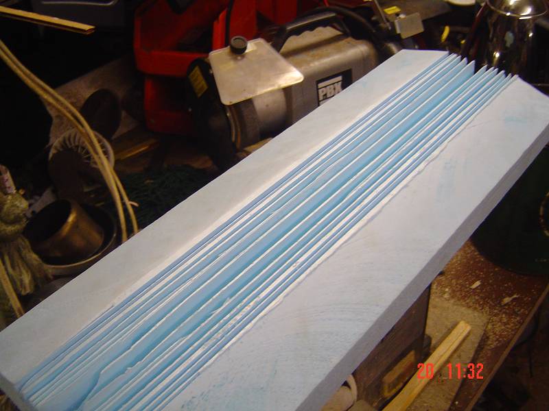

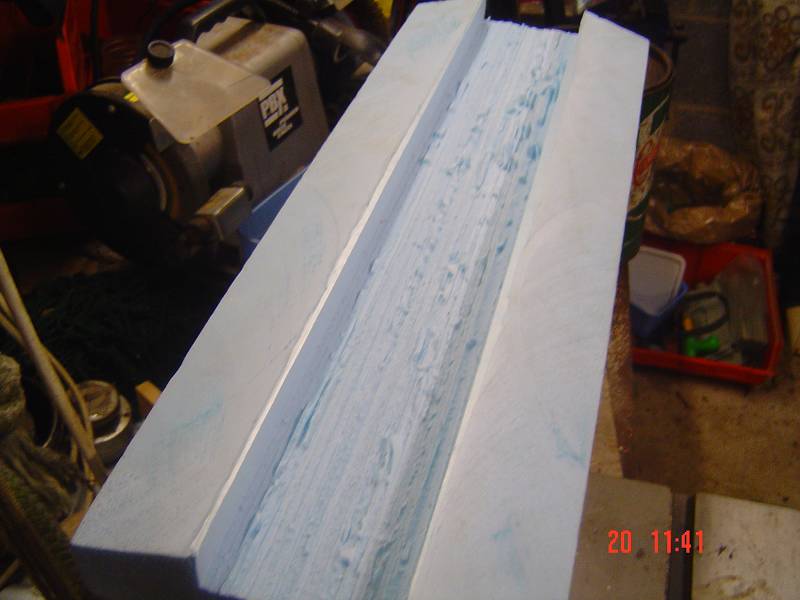

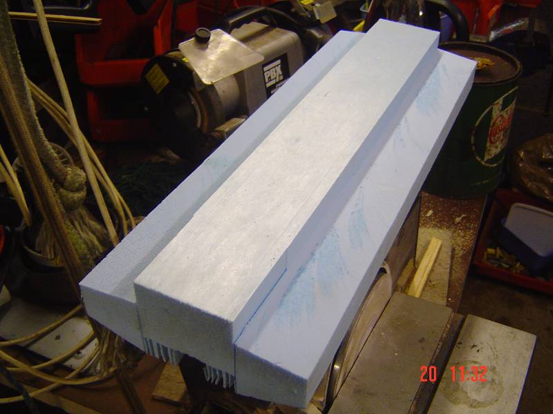

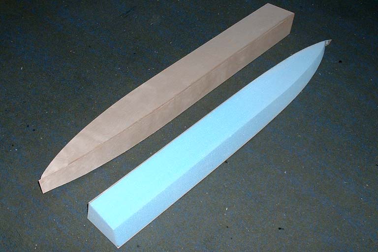

i started work this morning and have got a lot further that i thought i would.
i have taken picture as i go, so under here is the pics in order of what i did.
i used a table saw for all of this work, as advised by my dad which i was very please with as it saved me loads of sanding.
and yes i know, it does look like a tunnel hull at the moment, i thought that but i promise it will soon look like a cat.
i am taking different parts from all different cats, like i am having the cockpit like jdoug(raised a bit) and trying to copy the front of PINZA cat, as it looks smooth but have not started the main shaping yet, any how, heres what i have done so far:

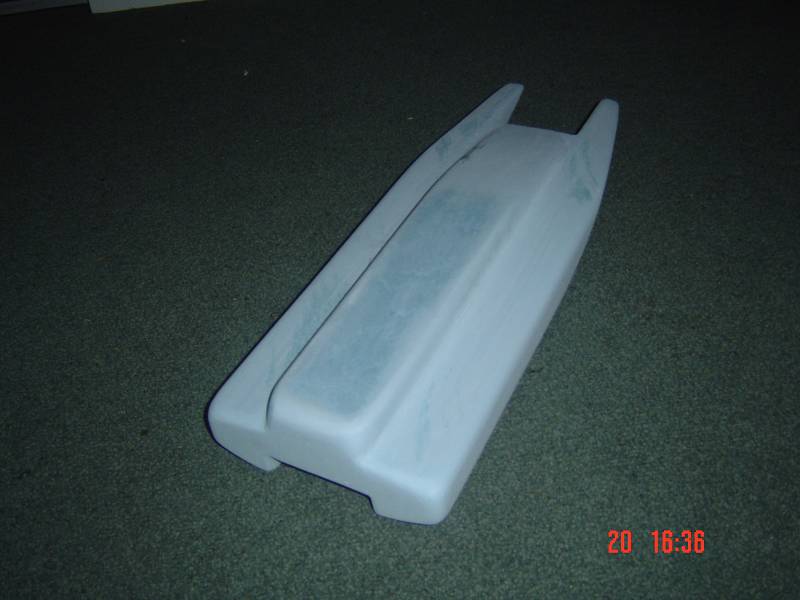

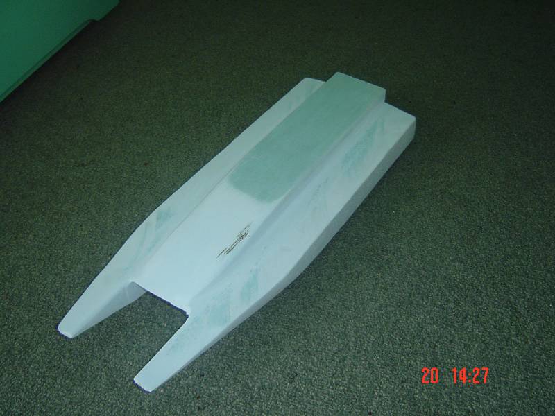

heres were i am up to now:
p.s. i have to do dam revision now so will have to wait till later.

no, sorry, i thought i would just give it a go. it still needs lots of work.
What do the think of the shape of the sponsons?
will they cut the water ok?
thanks

Judging from the picture.
They are nice and wide. SO it will hold up nicely. the length is Ok. and .
I would add one strake to each of the sponsors to keep it more straight and hold better in the turns.

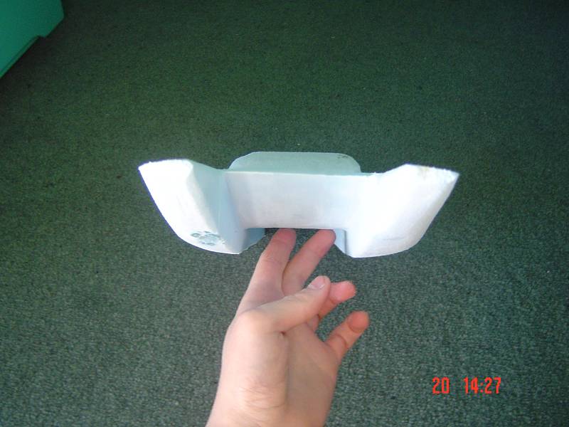

i have done most of the finishing touches on the hull now, i just need to add a stake on each sponson and it will be ready for fibregalssing.
i have set a myself a 3lbs limit to keep to, rtr. (1.4kg).
the hull at the moment only weighs 5oz. i wish i could keep it that low, with fibreglass on. i am going to use fibreglass tissue, as it is very thing and i am going to leave most of it in anyway. hopefully i will keep under 12oz. for the hull, wihout any gear.

cool.
But why is the hull rounded ?
Most hulls are straight they preform better and tack straighter.
Old 01-20-2007 | 12:13 PM

it wont make it slower it will just skip and slide in the turns
