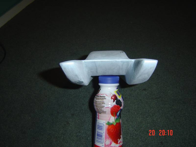

Old 01-20-2007 | 02:57 PM
  #27
Alex73's Avatar
Joined: May 2006
Posts: 643
From: Clacton-On-Sea Essex, UNITED KINGDOM
Default RE: Making a Micro cat, (shaping the almost done)
ok, have a look at this, is that better again?
i could really kick myself sometimes

Old 01-20-2007 | 03:05 PM
  #28
CadillacDTS2001's Avatar
Joined: Oct 2005
Posts: 6,449
From: Tottenham/Orillia, ON, CANADA
better

Old 02-04-2007 | 09:15 AM

i have done the top now just need to wait a day or 2 to let it all properly dry, will get some pics up soon. without the top fibre glassed it was 10oz so hoping will stay around there when i put on top, then take out foam.
