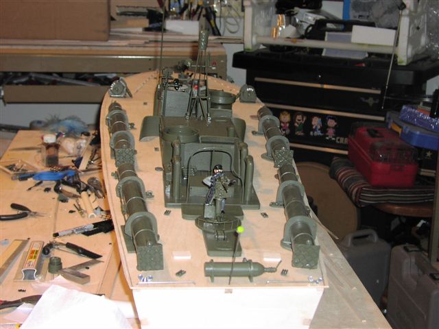

ok thanks for your time ,i am new to this kind of power, this is what i am building rye

P109. we have many of them in our club
one has 3 550 motor on one of the SC480 esc's with 2, 8 cells in series. and the motors are in parallel

this boat is 5' about 9 lb with out the batterys how who you do it only 2 900 motors for speed or long runs i want to get up on plain with it ,rye
Old 02-17-2007 | 10:45 PM
CadillacDTS2001's Avatar
Joined: Oct 2005
Posts: 6,449
From: Tottenham/Orillia, ON, CANADA
Default RE: help i need a battery guy
i know the boat. they are all the same length.
I would suggest a gell cell "lead acid " battery.
of around 4.5 ah( 4500mAh) and around 12 volts
that one battery would do the job
